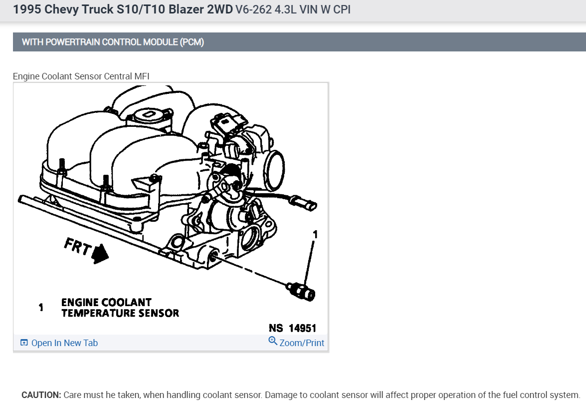

Engine shuts off when cold
150,000 MILES • 4.3L • V6 • 4WD • AUTOMATIC
FOST
Runs fine when warm.
Jun 2, 2022 at 9:53 PM
  • 55,721 POSTS

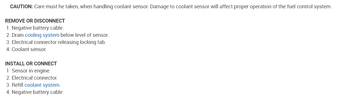

I have seen the engine coolant sensor cause this issue. If the sensor value gets off it thinks the engine is hot all the time, here is the location of the sensor so you can change it out to see if it helps the problem. Also, I have included a guide to help you check for vacuum leaks.
