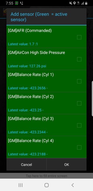

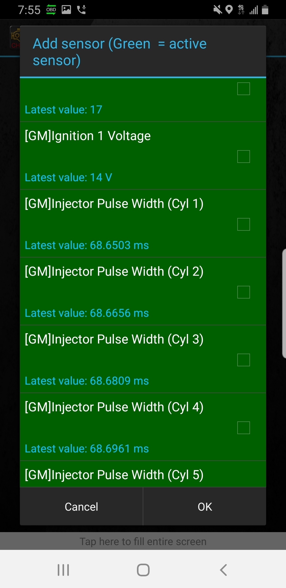

I replaced cylinder one fuel injector I need to know if my balance and pulse rate is in good specs. Also my GM AFR command is 1. 7:1. I did put a new mass air flow sensor on but no codes or check engine light. thank you.

It is a complicated formula that your vehicle's Power-train Control Module (PCM) uses to calculate the exact time to keep your vehicle's fuel injectors open, but it looks okay. The one value that I see on there that is out of whack is the Air:Fuel Ratio. Usually your vehicle is trying to keep the Air:Fuel ratio as close to stoichmetric as usual, which is 14.7:1. It looks like your PCM is commanding 1.7:1 which is so rich it would completely flood your engine and not make run. I could be seeing things though. Is your vehicle running fine?

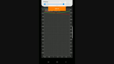

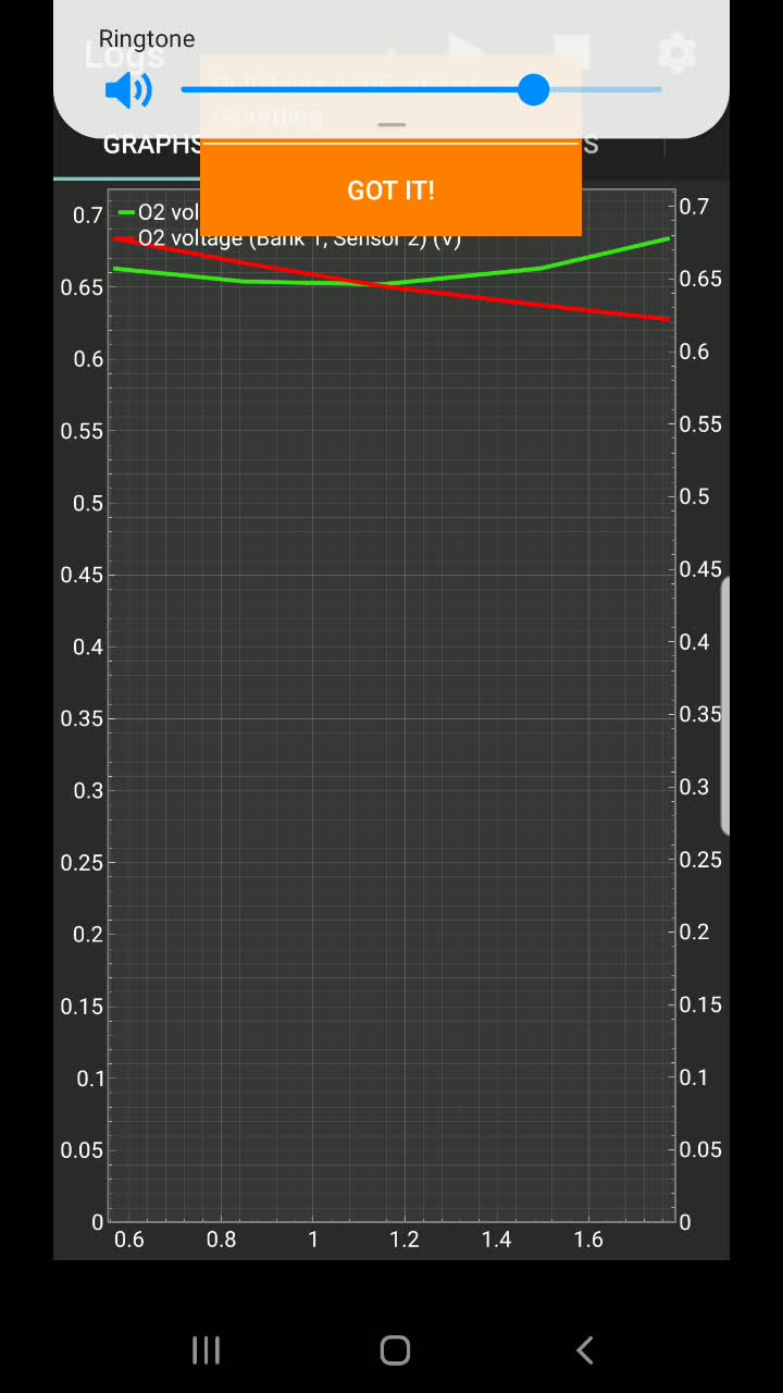

Here is a video of my o2 sensors:

This looks good but I need to ask have you serviced your throttle bore? We should check fuel pressure as well it could be a weak pump. here are two guides to help us fix it:

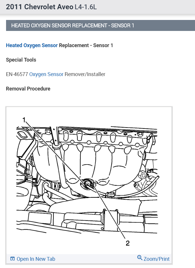

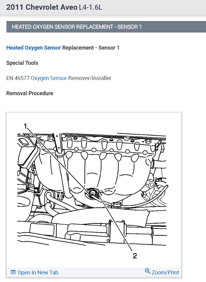

Here is a guide to walk you through the replacement and diagrams below you show you how on your car:
https://www.2carpros.com/articles/how-to-replace-an-oxygen-sensor
Check out the diagrams (below). Please let us know what you find.
