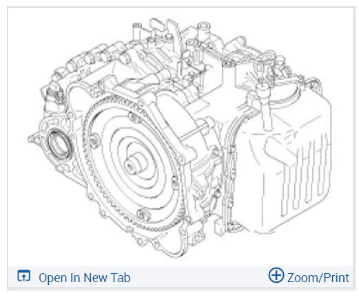

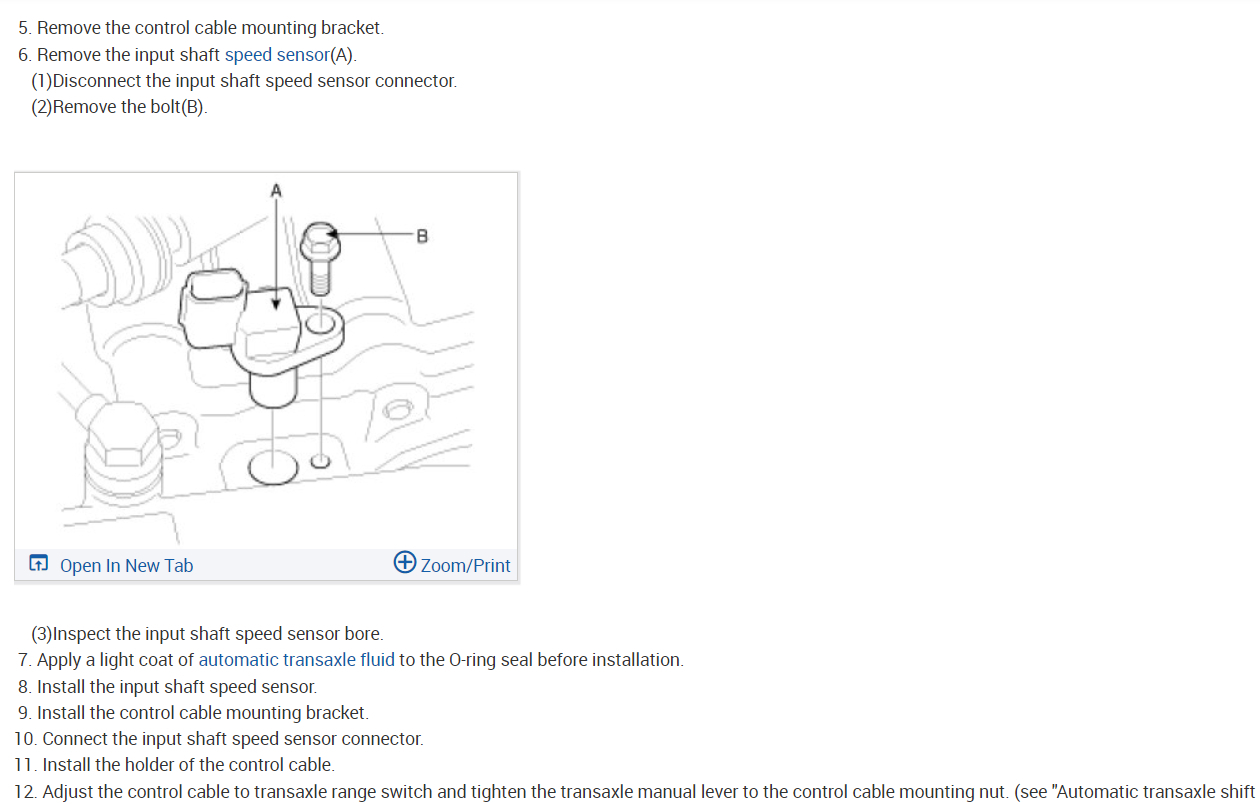

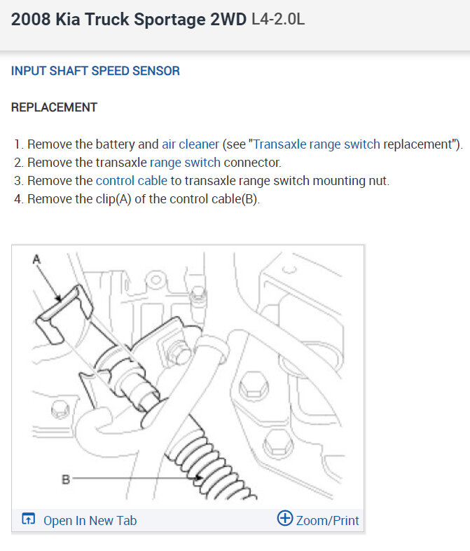

I have seen good results with the "Lucas transmission fix" but if the fluid is black, I would change it out, also I have seen a bad input shaft speed sensor cause the shifting issues. We should run the codes to see if any are stored, this guide can help:
Here is a generic guide to help you step by step with instructions to service the transmission in the diagrams below to show you how on your car.

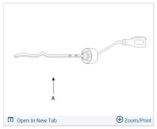

4. Before removing the oil level gauge, wipe all contaminants from around the oil level gauge. Then take out the oil level gauge and check the condition of the fluid.

6. Insert the oil level gauge securely.

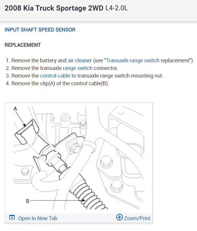

Here is the location of the input shaft speed sensor, if this sensor is bad it may not give a code for the sensor FYI. Check out the images (below). Please let us know what happens.
