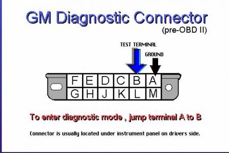

Engine Performance problem
1990 Chevy Van V8 Two Wheel Drive Automatic 172000 miles
After 15min. blows black smoke & dies. won't restart for a time.

Is the service engine light on? Read the codes like this, post the results. It sounds like either the ECT(enine coolant temp) sensor, or an O2 sensor, too rich... Cross these two terminals as shown, then turn the key on. Count the flashes, a 22 will flash as 2 flashes then a short pause, then 2 flashes, if more than one code is stored, the pause will be longer. The codes will display three times and end with 12. Write them down and post here. This connector is right under the middle of the dash...

MAGICCAR1
code 12 &15
Thank You for the help
Rick
May 29, 2017 at 3:33 PM (Merged)
MERLIN2021
  • 17,250 POSTS
12 is nothing and 15 is the coolant temp sensor reading too low. change the sensor.
