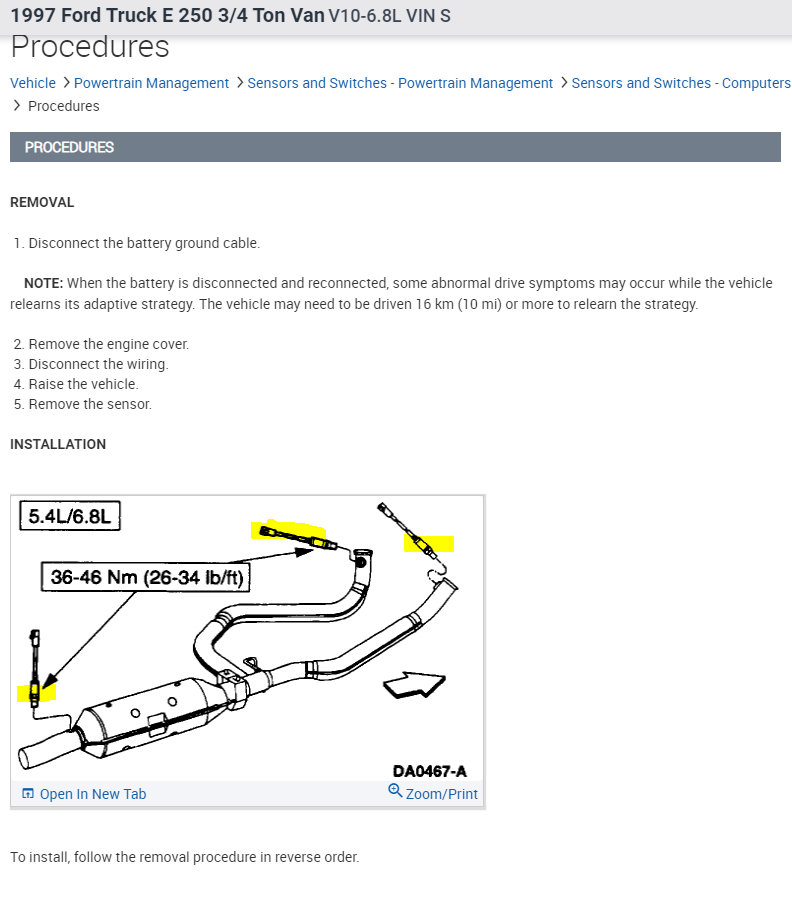

I was told it might be the oxygen sensor. I took the van to the Ford agency they had the van there for 3 days and could not find the problem. This one guy said it could be the oxygen sensor. But I cannot locate it. That's why I'm asking if you can tell me where it is located. If possible, can you send an image?

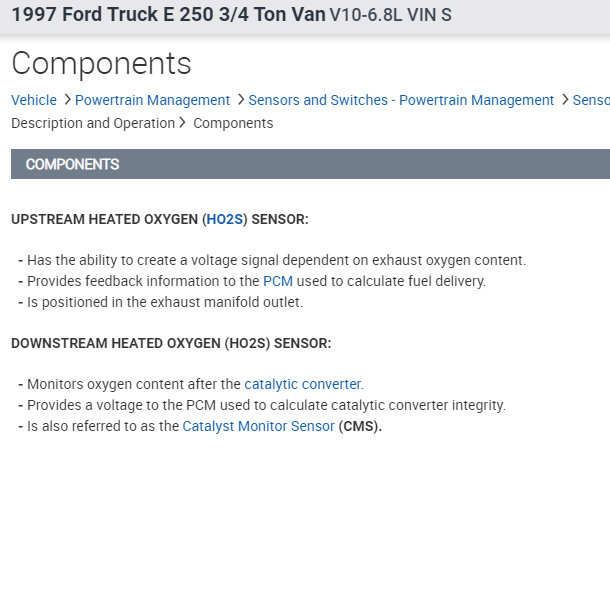

This V10 should have three oxygen sensors. See diagram below for the location.
The best course of action would be to take a look at the guide and go through the possibilities to find the issue. This way you are not replacing a part that does not need to be replaced.
Are you getting any codes? Is the check engine light on?
If so, scanning for codes can help with the diagnostics.
