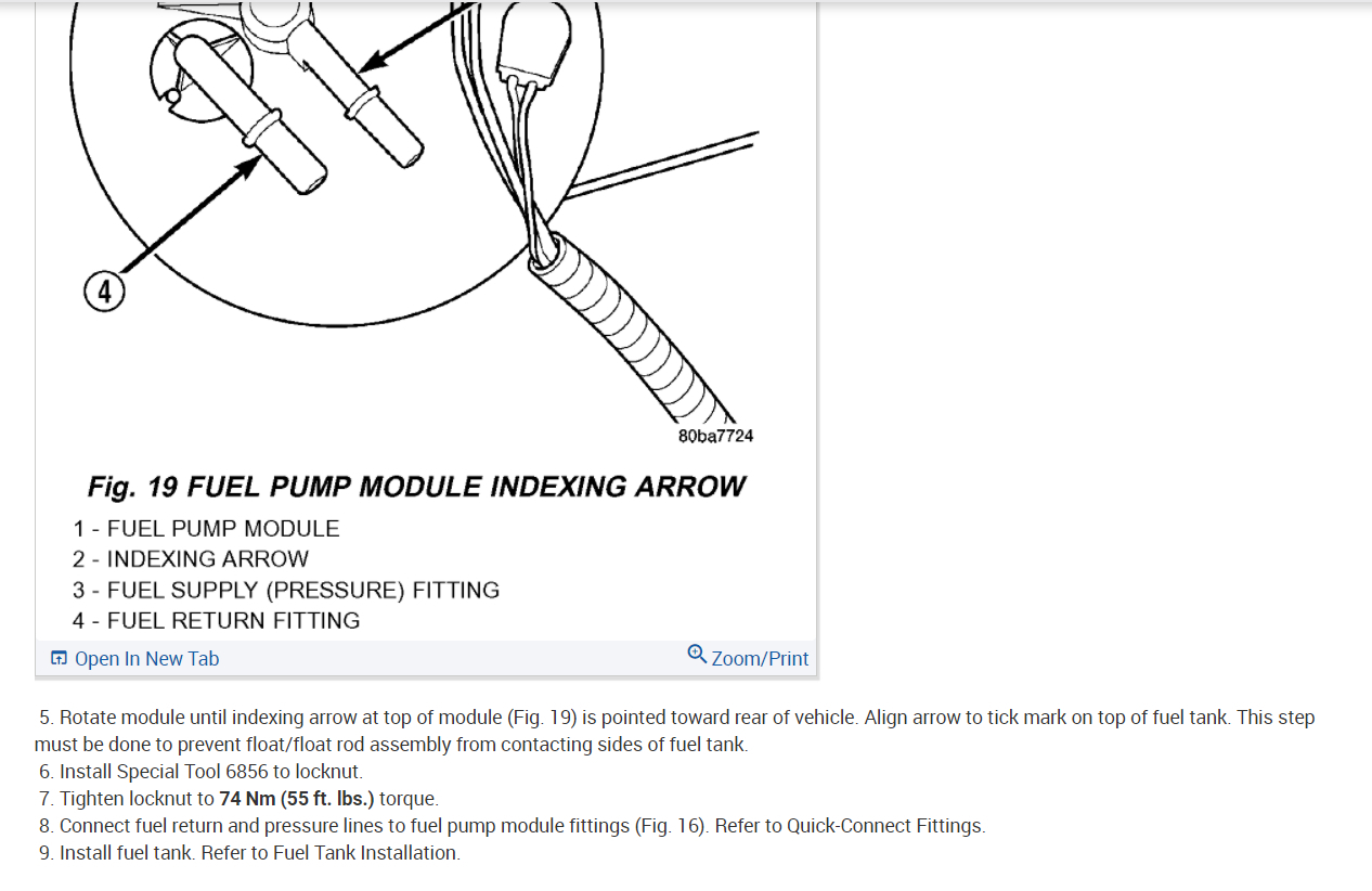

Hi again:
I hate changing things without being sure. Without checking pressure or knowing the fuel trims, I don't know for sure if that is the problem. It can be, but without testing, it becomes a guess. I hope you understand.

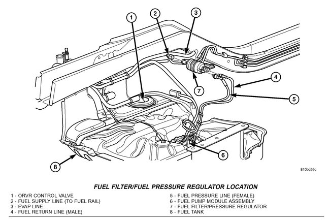

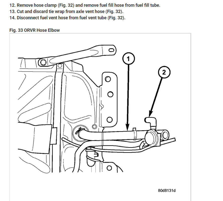

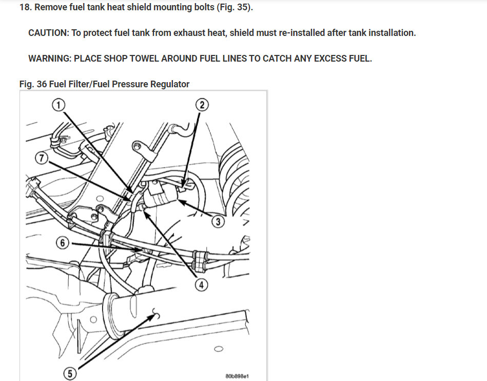

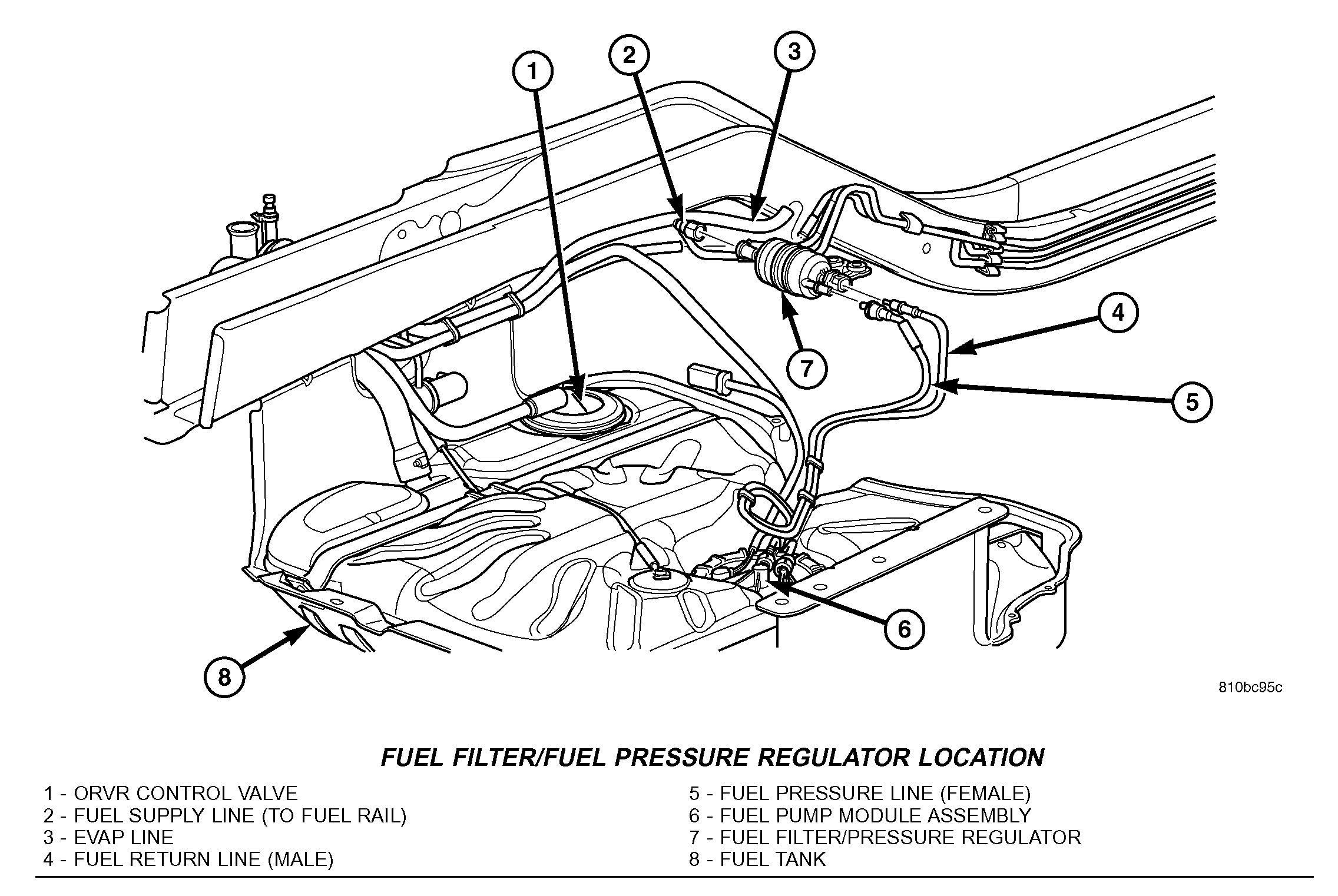

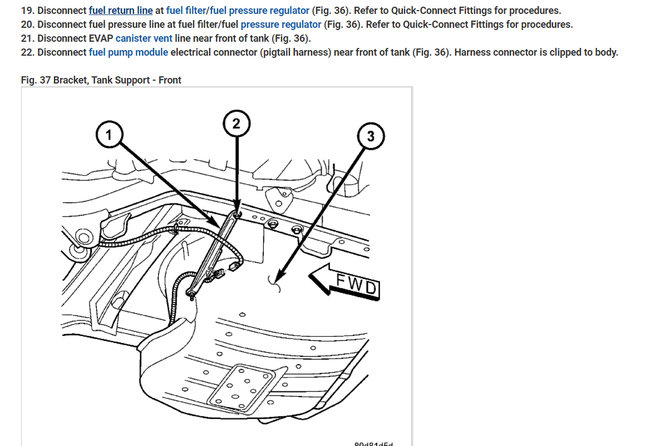

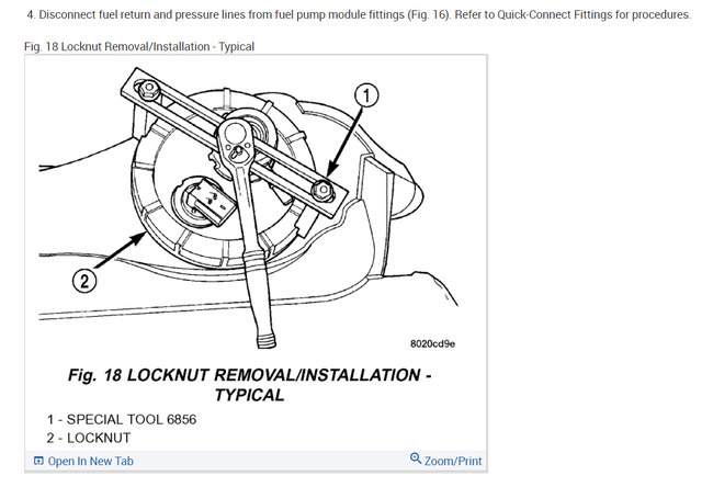

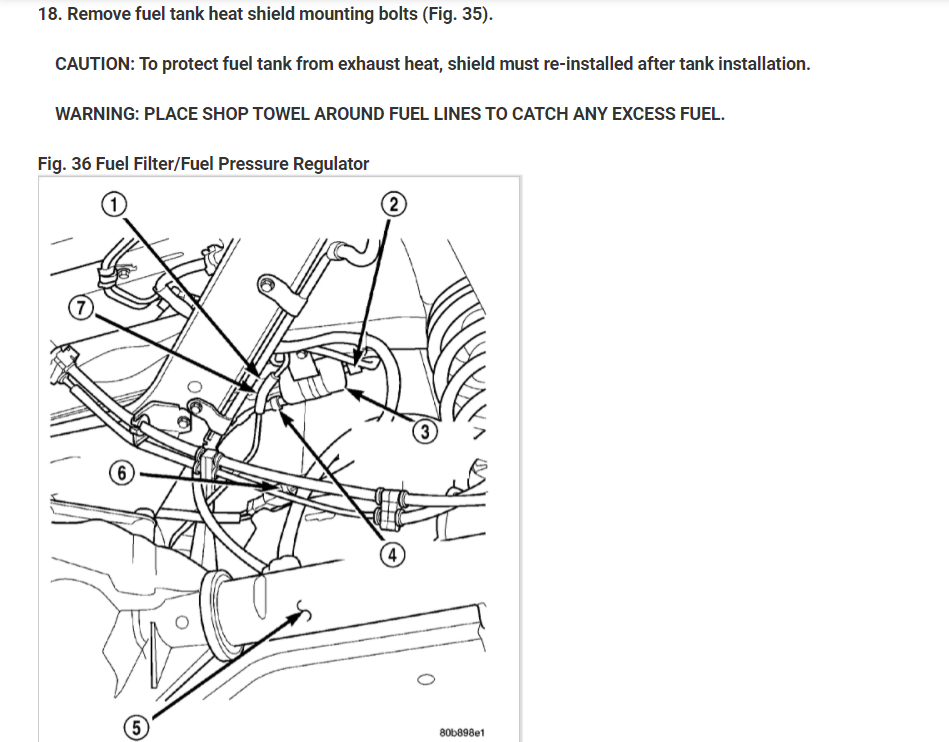

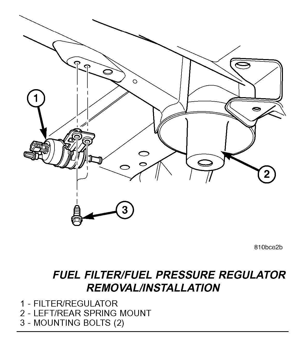

Regardless, here are the directions for replacing one. The attached pictures correlate with these directions.
The combination Fuel Filter/Fuel Pressure Regulator is remotely mounted to the vehicle body, above the rear axle and near the front of the fuel tank.
See Picture 1
1 Perform Fuel System Pressure Release Procedure.
2 Disconnect negative battery cable at battery.
3 Raise vehicle.
4 Clean area around 3 filter/regulator fittings.
Fuel Filter/Fuel Pressure Regulator Location
See Picture 2
5 Disconnect fuel supply fuel return and fuel pressure lines at filter/regulator. Refer to Quick-Connect Fittings.
6 Remove 2 mounting bolts and remove filter/regulator.
INSTALLATION
1 Before installing filter/regulator, be sure all fittings are cleaned of all dirt and contaminants.
2 Be sure O-ring is positioned into fuel return fitting in filter/regulator.
3 Apply a small amount of clean engine oil to O-rings.
4 Position filter/regulator to body and install 2 bolts. Tighten bolts. Refer to Torque Specifications.
5 Connect 3 fittings. Refer to Quick-Connect Fittings.
6 Connect negative battery cable to battery.
7 Start engine and check for leaks.

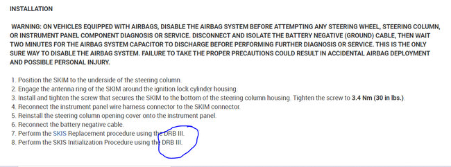

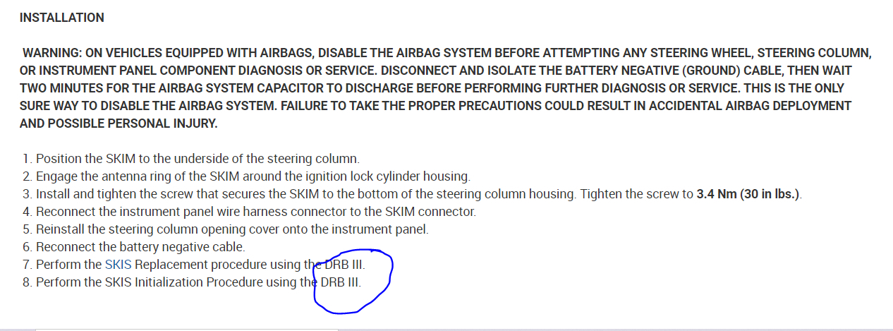

I was working in the steering column and unplugged the immobilizer. Since then my Vehicle will start and run about 2 seconds. What can l do about this issue without paying $300.00 for a locksmith?
Jun 22, 2021 at 10:04 AM (Merged)
Good morning,
The locksmith is the best alternative. In order to do it yourself, you will need a DRB scan tool that is very expensive to reset the system.
https://www.2carpros.com/articles/how-to-reset-a-security-system

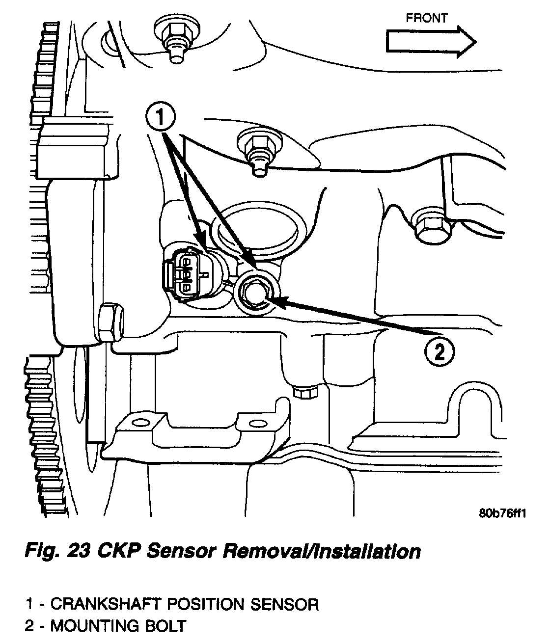

My vehicle will start but then will shut off straight after. we changed the fuel pump, no engine check lights and the problem is still occurring. Would it be my mass airflow sensor?
Add to the post have done a full service including transmission.
  • 110,244 POSTS
Welcome to 2CarPros.
The mass air flow sensor may cause it to run poorly, but what you described doesn't sound like it. Does the vehicle start right back up after it stalls only to do the same thing?
If that is what is happening and there is no check engine light, my first suspect is the crankshaft position sensor. If the vehicle won't start after it stalls, then you can take your scanner and check if there is an RPM signal when it won't start. If there is none, then the sensor is my first suspect.
Take a look through these links:
https://www.2carpros.com/articles/how-a-crank-shaft-angle-sensor-works
Another way to test the sensor is by checking for ignition spark. If when the engine shuts off you note that spark stopped, the sensor is a suspect.
_______________________

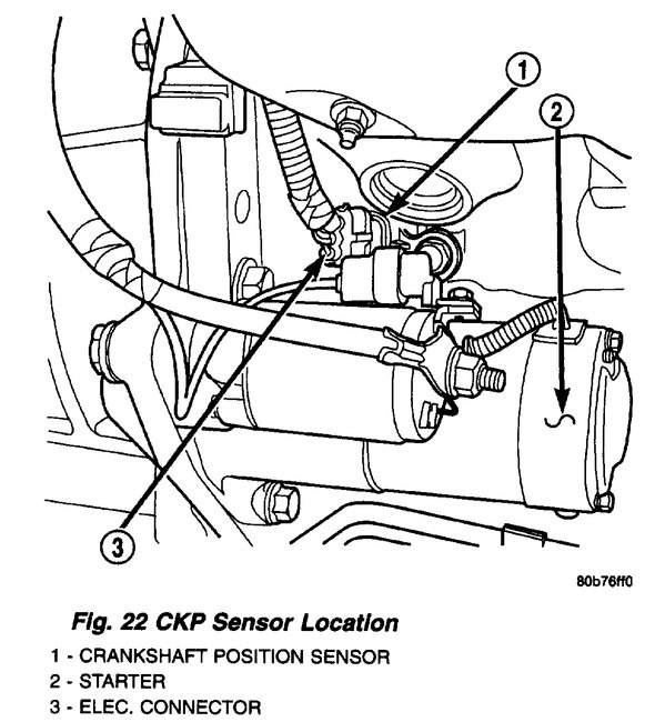

Here are the directions specific to your vehicle for replacing the sensor. It is located right above the starter. However to access the retaining bolt, the starter needs removed. Make sure to disconnect the battery before you work on or around the starter. The attached pictures correlate with the directions.
2001 Jeep Truck Grand Cherokee 4WD V8-4.7L VIN N
Procedures
Vehicle Powertrain Management Sensors and Switches - Powertrain Management Sensors and Switches - Computers and Control Systems Crankshaft Position Sensor Service and Repair Procedures
PROCEDURES
REMOVAL
Fig.22 CKP Sensor Location
Pic 1
The Crankshaft Position (CKP) sensor is bolted to the side of the engine cylinder block above the starter motor; It is positioned into a machined hole at the side of the engine block.
1. Remove starter motor. Refer to Starter Removal/Installation.
2. Disconnect CKP electrical connector at sensor.
Fig.23 CKP Sensor Removal/Installation
Pic 2
3. Remove CKP mounting bolt.
4. Carefully pry sensor from cylinder block in a rocking action with two small screwdrivers.
5. Remove sensor from vehicle.
6. Check condition of sensor O-ring.
INSTALLATION
1. Clean out machined hole in engine block.
2. Apply a small amount of engine oil to sensor O-ring.
3. Install sensor into engine block with a slight rocking action. Do not twist sensor into position as damage to O-ring may result.
CAUTION: Before tightening sensor mounting bolt, be sure sensor is completely flush to cylinder block. if sensor is not flush, damage to sensor mounting tang may result.
4. Install mounting bolt and tighten to 28 Nm (21 ft. Lbs.) torque.
5. Connect electrical connector to sensor.
6. Install starter motor. Refer to Starter Removal/Installation.
