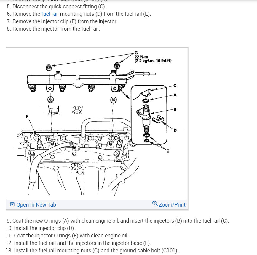

When driving my vehicle listed above, if I put my foot down and accelerate, I have black smoke from exhaust. no eml on no loss of power.

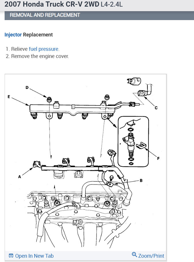

This can be a bad tank of gas, if not we need to remove the spark plug for inspection. One will be black with soot, this will be the cylinder that has a bad fuel injector here is how to replace it in the images below, I have also included two guides that can help you with the job.
https://www.2carpros.com/articles/how-to-change-spark-plugs
and
https://www.2carpros.com/articles/engine-black-smoke
Check out the images (below). Let us know what happens and please upload pictures or videos of the problem.
