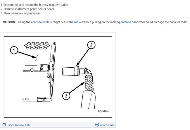

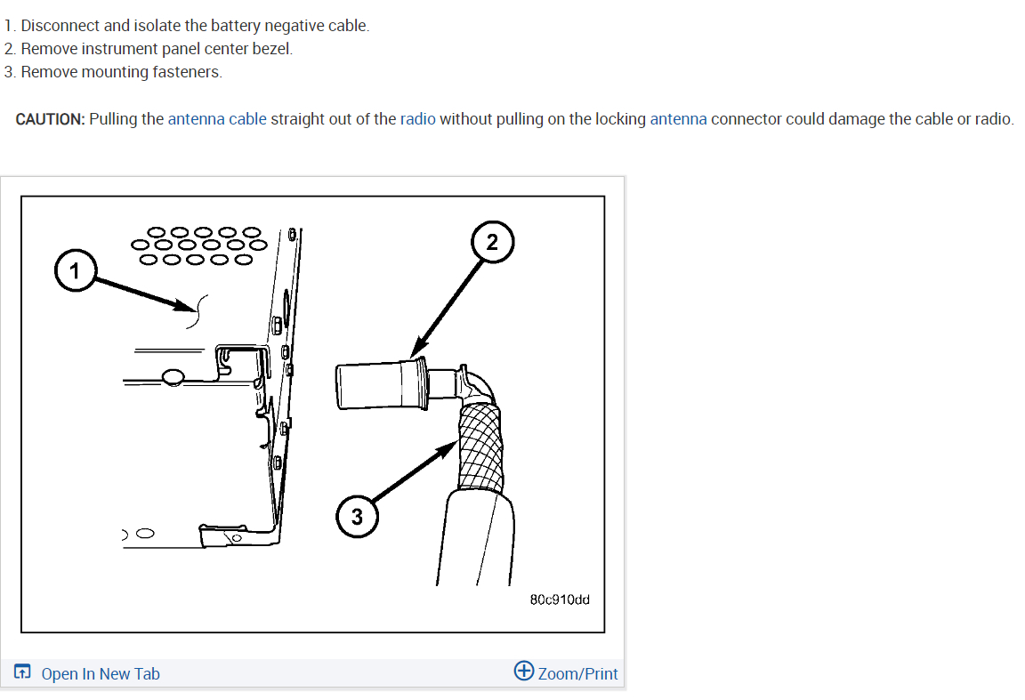

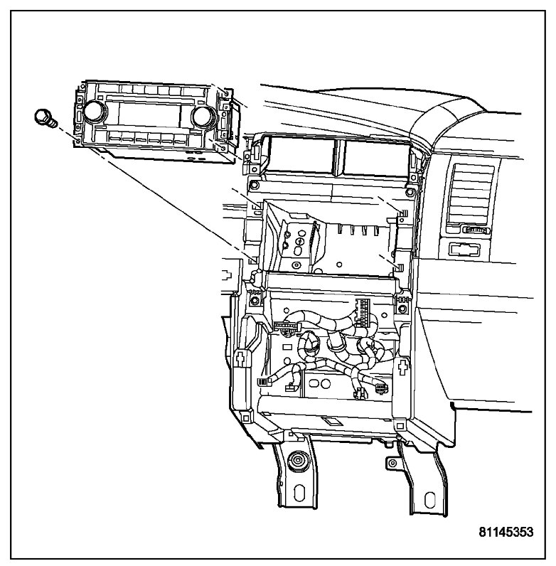

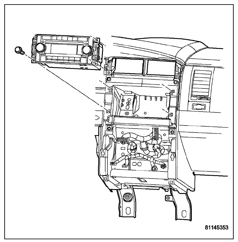

My screen is black and is stuck on am channels. Only 1-6 buttons work
Aug 22, 2024 at 5:55 AM
  • 55,766 POSTS
Yep, 9 times out of 10 it will be the radio head unit, I would remove it and send it into a radio repair shop for testing and repairs. Here is how to remove the unit, start by disconnecting the battery. Check out the images (below). Let us know how it goes.
