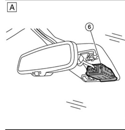

What is the black box next to the inside rear view mirror, proximity warning?

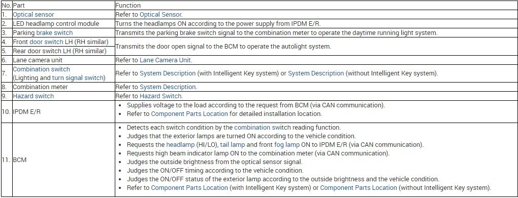

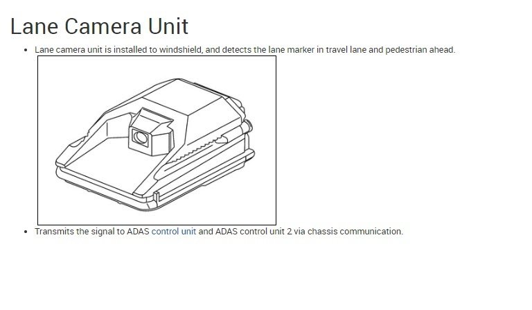

It is the Lane camera unit. Here is a picture with a chart.

The lane keep system will be disabled, and there will be various trouble codes spread throughout other modules, but should not affect the overall basic functions of the vehicle.

It should not affect lighting because that system has it's own optical sensor. You will have a warning light or lights depending on what systems your vehicle is equipped with. You will not have forward emergency braking (FEB) operation and lane control.

If you are replacing the lane/camera unit, it should be plug and play.
