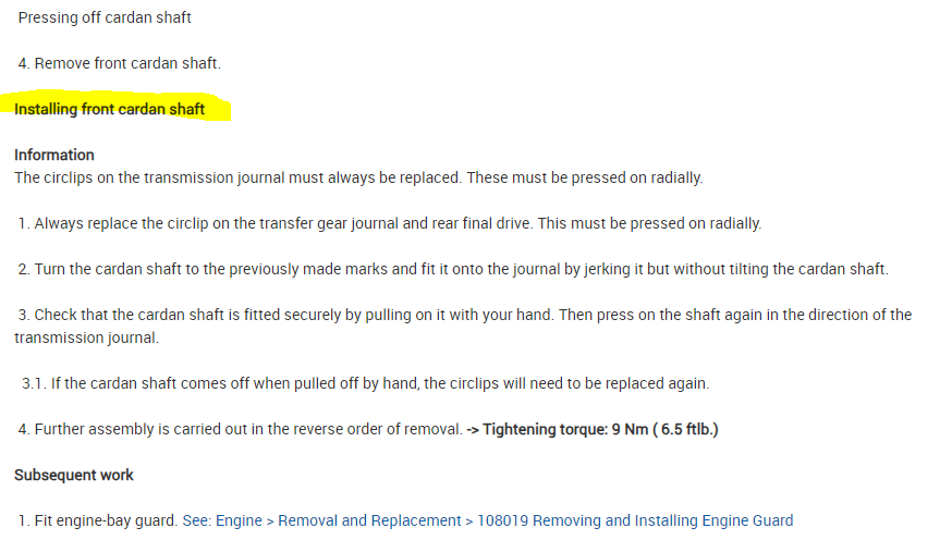

I changed the fluid it is still binding. Is it possible to remove the front shaft on the transfer case to eliminate whether it's the case or something else or would the car not drive?

Fluid was dark but made no difference. Binding on turns say while in driveway and the hesitation while driving low speeds. Had BMWs that way and it was the transfer case but not sure how the front shaft can be removed as these have no bolts. Can you see how it can be removed?
May 5, 2024 at 11:35 AM

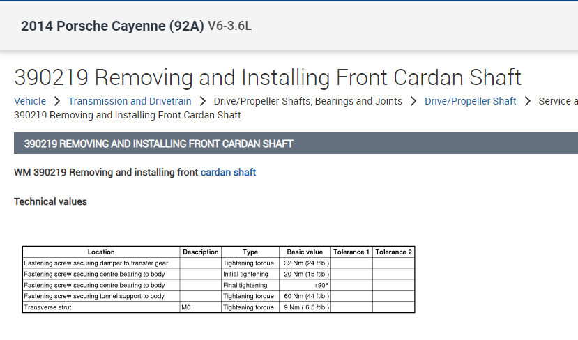

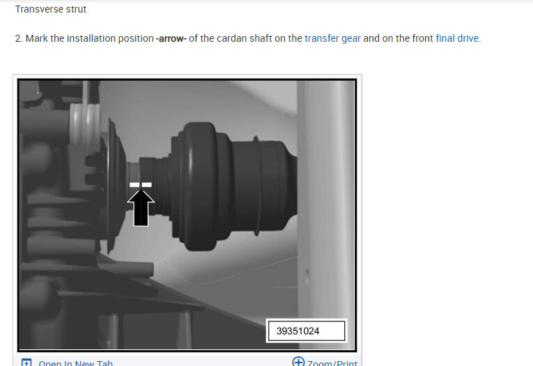

  • 110,241 POSTS

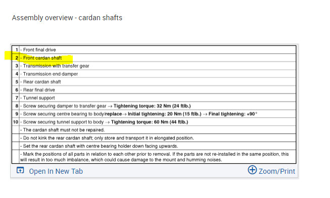

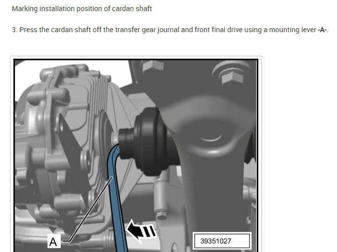

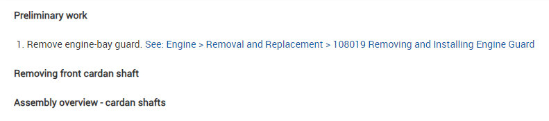

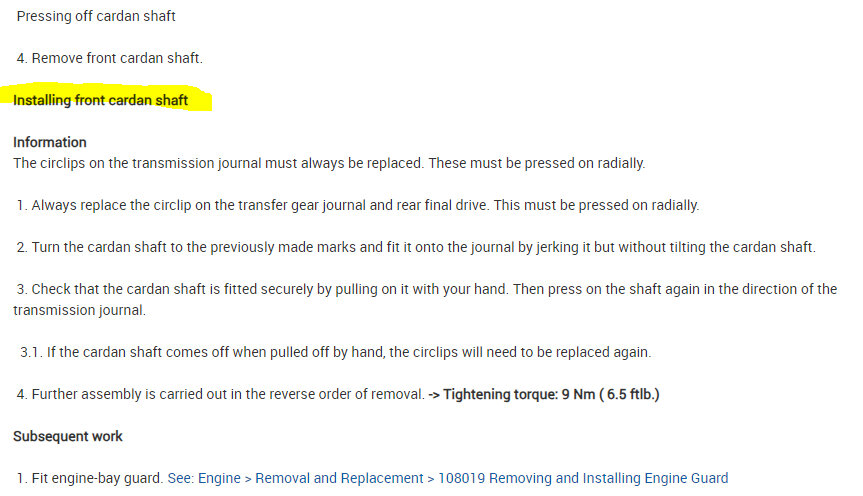

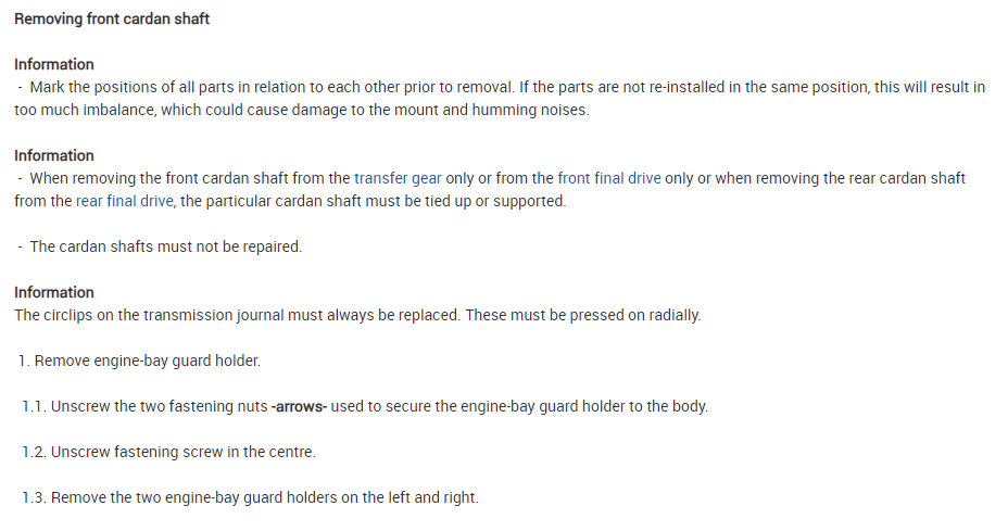

The front drive shaft (cardan shaft) is much like a CV axle. A circlip is what holds it in place at the front differential. You pry it off. The circlip should be replaced if you remove it.
I attached the directions below for you. I hope this helps.
May 5, 2024 at 1:52 PM

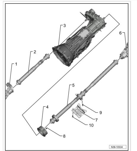

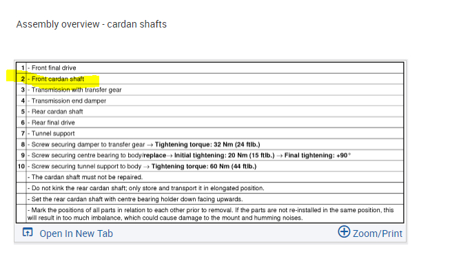

BHAMDOC1973
  • 2,007 POSTS
looks like it's the shaft pin the passenger side coming out of the transfer case that I need to remove but the driveshaft is also connected to rear of it, so if binding occurs its usually in the front differential or transfer case. on BMWs I think it's usually in front differential.
May 5, 2024 at 11:08 PM
  • 110,241 POSTS
That is correct. Binding will likely occur in the front differential.

No way it's coming out without something removed, i tried both sides with a pry bar nothing moved a mm. If i remove it no fluid should come out from diff or transfer case, right? What if i remove the front axle instead?
