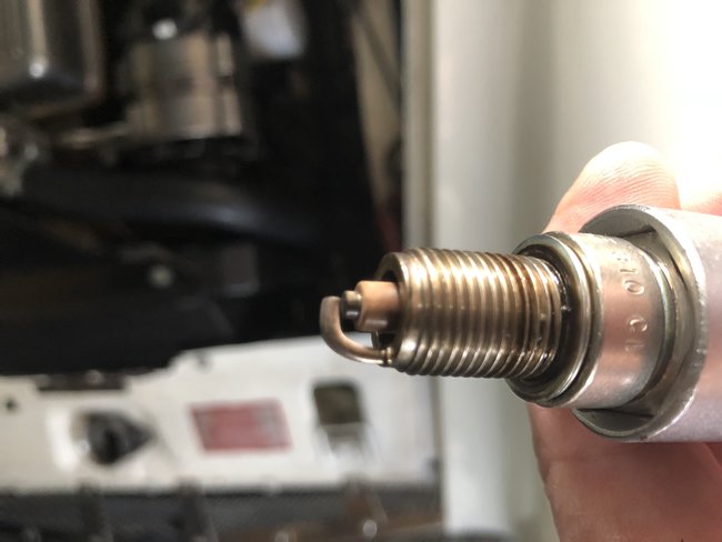

Have you replaced and set the points, condenser, cap, rotor and plug wires? Also, can you pull the new plugs out to see what they look like. Do all cylinders and take a video of them please.
Jul 2, 2018 at 5:05 AM
JAN JACOBS
  • 11 POSTS
It is electronic ignition and the color of the spark plugs are very good.
Jul 2, 2018 at 5:18 AM
  • 55,770 POSTS
It is good the spark plugs are new. I need to see the electrode color to see if the engine is lean or rich? Also, do you have nex plug wires? Do you install EI? Because that car came with points and condenser.
Jul 3, 2018 at 4:57 AM
JAN JACOBS
  • 11 POSTS
Hi Ken, I will take a picture for you tomorrow and yes I installed the electronic ignition myself and it always worked fine, the plug wires came with the electronic ignition I measured the ohms and they are all okay. A other mechanic on the forum told me to look to the settings of the Stromberg but I am waiting for the special tool to change the settings.
Jul 3, 2018 at 5:03 AM
  • 55,770 POSTS
Okay, if we can see the plugs I can tell you which way I would go. By the way, I have had nothing but problems with some aftermarket systems. What is the brand name?

JAN JACOBS
  • 11 POSTS
Hi, here is a picture of the spark plug cylinder four.

CJ MEDEVAC
  • 11,000 POSTS
I am a little carburetor oriented.
My thoughts on the super videos you sent are either:
A vacuum leak or a fuel issue. I am leaning towards a fuel issue.
This quick test might verify both possibilities.
Get you a sacrificial squirt bottle capable of stream or mist.
Load it with a few ounces of fuel.
I really suggest doing this outside away from other precious things with a first line of defense (big wet towel) and a second line of defense (fire extinguisher).
Remove the air cleaner and crank it up.
Start by misting fuel into the carburetor throat.
Does running improve?
If yes, we may still have a carburetor issue or a vacuum leak.
Before tearing into the carburetor for a problem.
I would rule out the vacuum leak possibility.
Check those hoses for cracks/ being unhooked/ swelled on the ends letting air by.
Here is how to really check it out:
Who built the carburetor?
Who adjusted the carburetor (on vehicle) Or was it just put on as is?
Keep us posted on results!
Maybe some closer pictures of the carburetor?
The Medic
