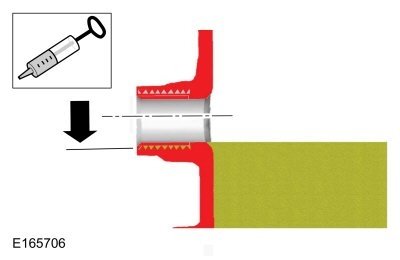

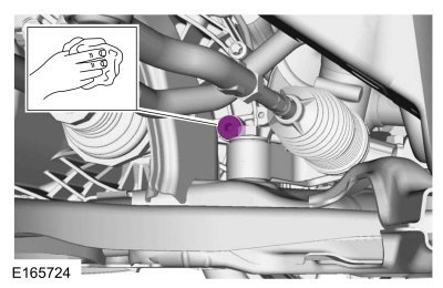

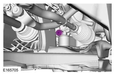

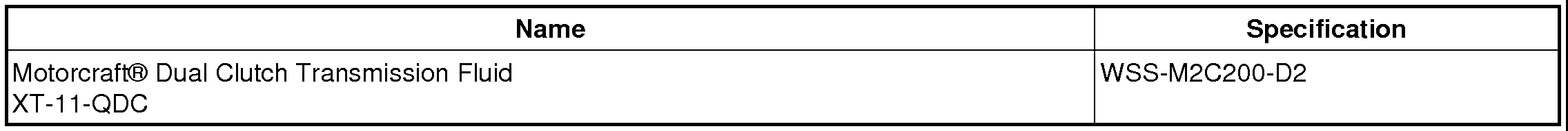

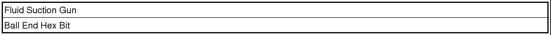

The only simple thing you can do is check to make sure the transmission fluid is clean and full. And I have to say that isn't even simple anymore. Here are the directions if you want to check fluid level. The attached pics correlate with the directions.

Special Tool(s)/ General Equipment

2. Use the General Equipment: Ball End Hex Bit

3. NOTE: Do not overfill the transmission. This causes transmission fluid to be forced out of the case.
Add transmission fluid until the oil runs out of the fill port in a continuous stream. The transmission is full when the oil flow from the fill port has slowed to a broken stream or dripping.
Use the General Equipment: Fluid Suction Gun
Material : Motorcraft(R) Dual Clutch Transmission Fluid / XT-11-QDC (WSS-M2C200-D2)

4. NOTE: The O-ring seal is to be reused unless damaged.
Torque : 32 lb.ft (43 Nm)
