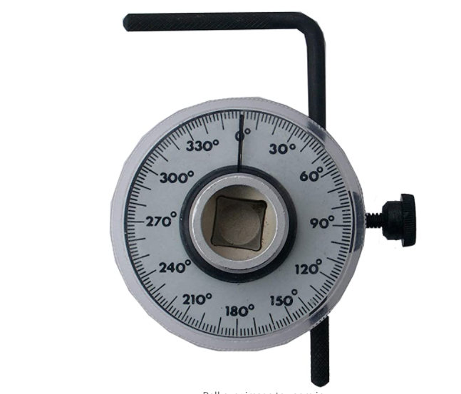

Please ensure that you fit new conrod cap bolts.
Tightening torque is
25Nm initial torque
Using an angle gauge tighten the nuts to another 45 degrees
See below for a picture of an angle gauge.
Please let us know how you get along.
Cheers, Boris

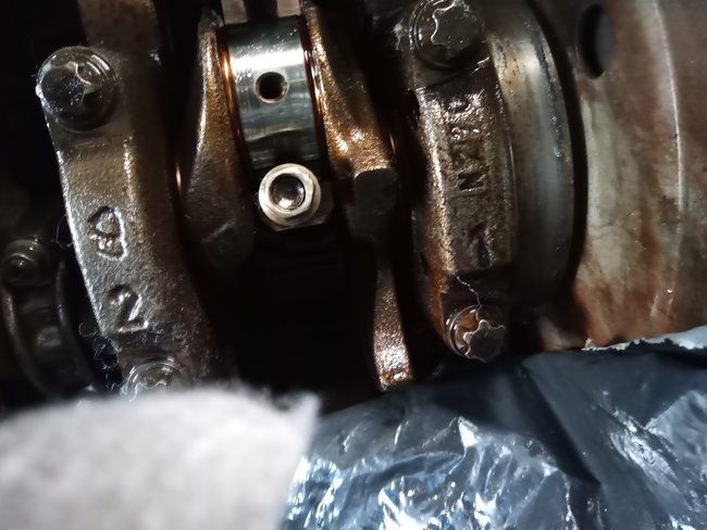

SIMON TN LAI
Can help clearance bearing kangoo k7j Main and conrod. thanks

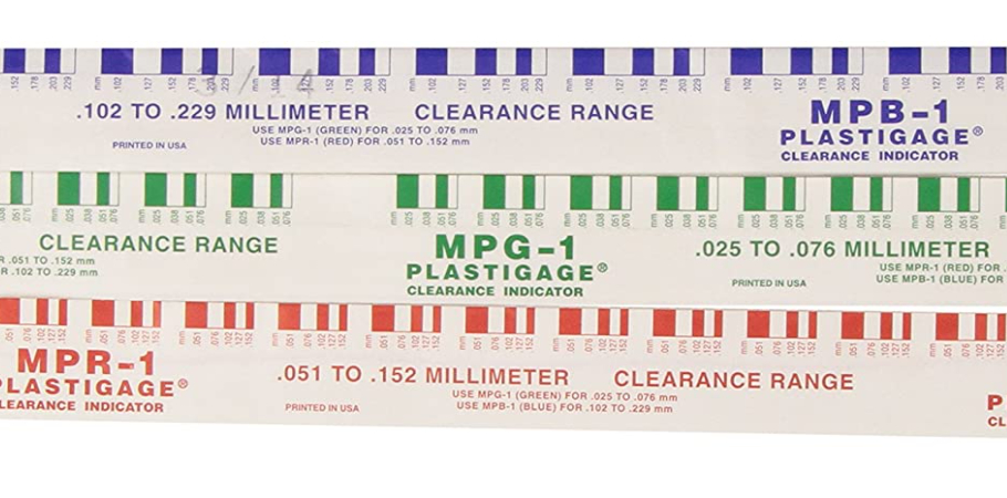

Using plastigage, see below picture, ensure that your crankshaft oil clearance, big end and main bearing, is between 0.028 and 0.054 mm.
For your requirements I would suggest using green plastigage which is suitable for oil clearance from 0.025 to 0.076 mm.
How to use plastigage.
https://youtu.be/q3pHb-qXZc8
Cheers, Boris

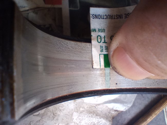

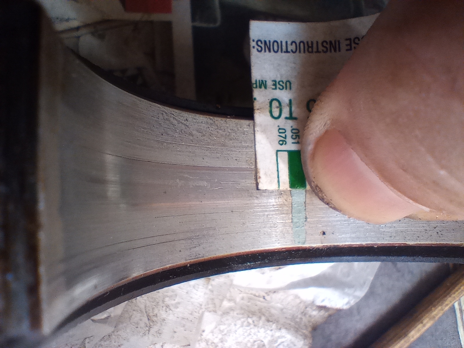

SIMON TN LAI
Too tight right.
May 23, 2021 at 8:39 PM
  • 55,412 POSTS
Yes too tight, I would redo the measurement after cleaning the bearing backside and block/rod remember the measurement must be done dry. let us know.

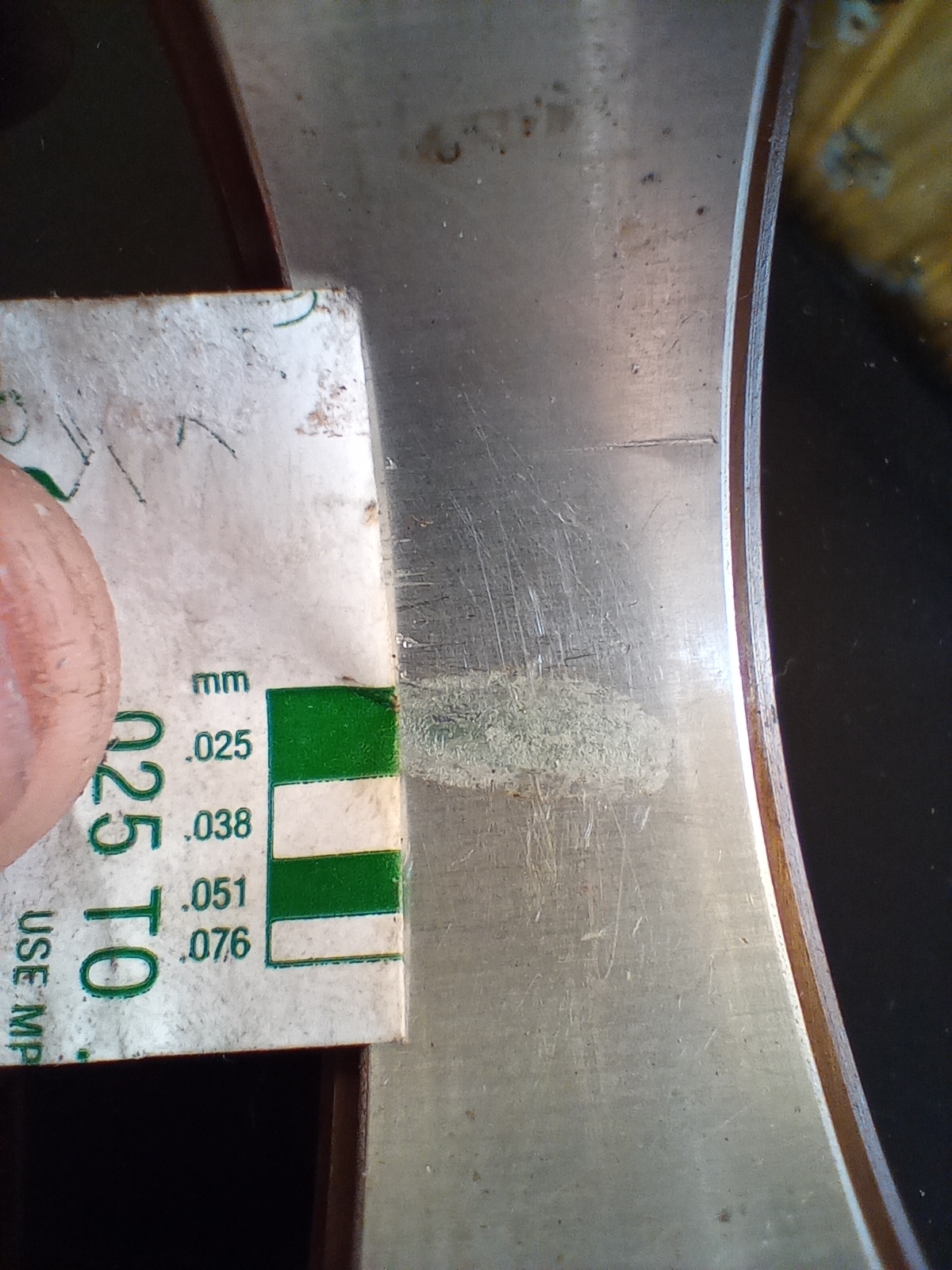

SIMON TN LAI
Main bearing present original.
May 27, 2021 at 4:54 PM
  • 55,412 POSTS
the bearing looks worn how is the crank side?

SIMON TN LAI
I think not so bad.
May 31, 2021 at 2:06 AM
BORIS K
  • 836 POSTS
What size bearings are you using?
Standard or oversize?
Also please measure the crankshaft main and big end journal diameters.
If unsure take the crankshaft to a reputable engineering/machine shop to have the diameters measured. They can then advise as to which size bearings should be used or if the crankshaft needs to be machined to the next undersize to accommodate a new set of bearings.
