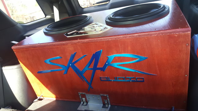

I am doing an SPL competition build in my vehicle listed above XLT. Does anyone know how to go about doing the Big 3 upgrade? The positive power terminal is like nothing I have ever seen before. Secondly, how do you remove the third row seats and lastly how is the headliner removed for sound deadening? Please help!

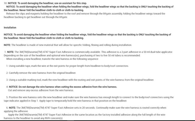

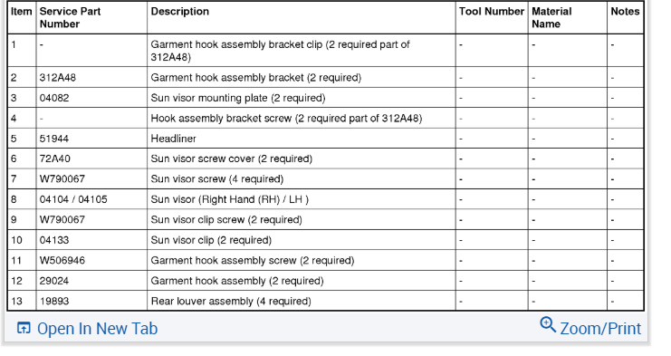

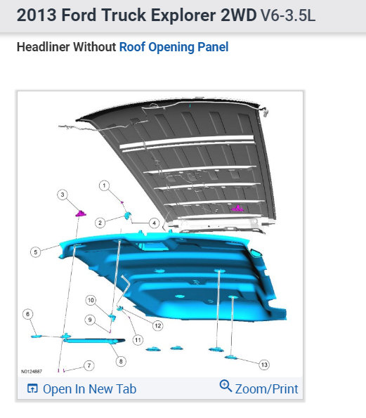

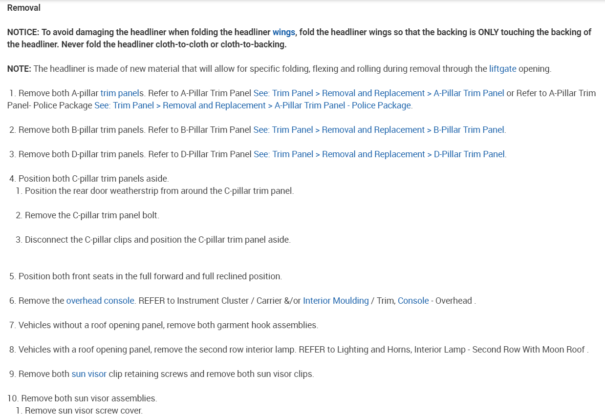

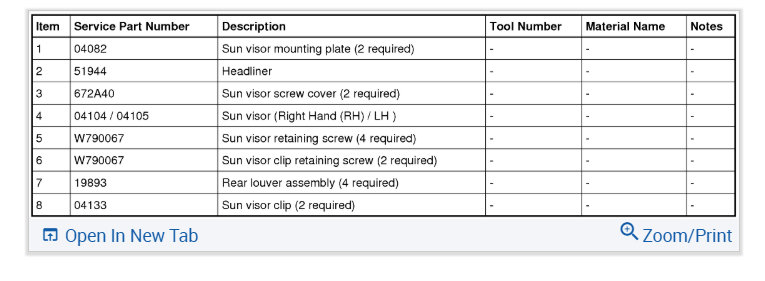

Not to sure about the big 3 maybe you can give a picture or something but I did find out how to remove the headliner. Check out the diagrams (below). Please let us know if you need anything else to get the problem fixed.
