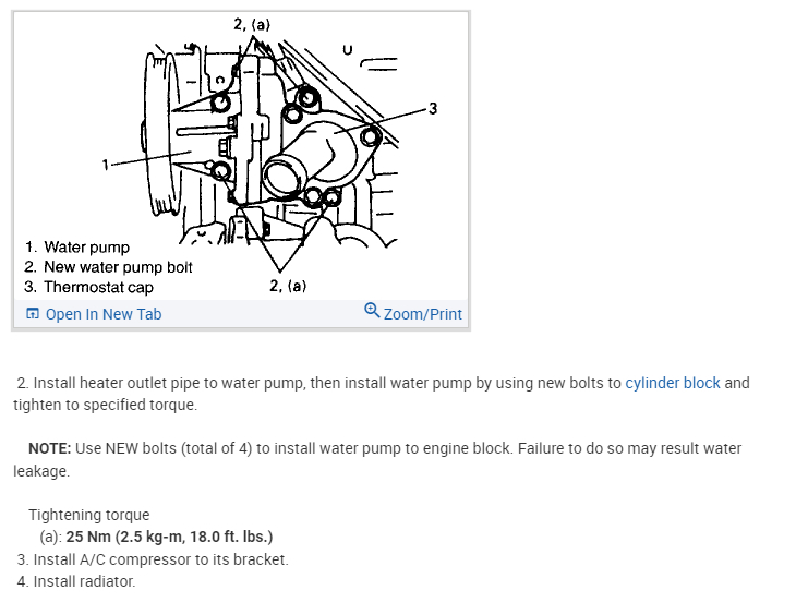

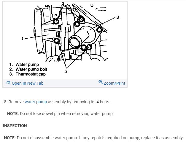

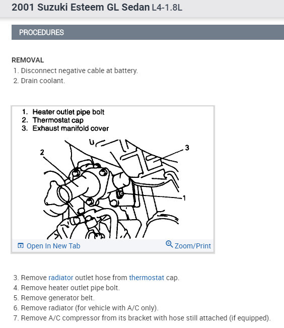

I'm having problems getting the bolts off to the water pump. how to remove the water pump?
Nov 20, 2019 at 8:40 PM
DANNY L
Experienced Mechanic
5,648 POSTS
Hello, I'm Danny.

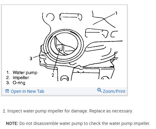

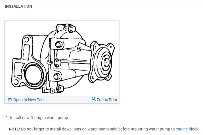

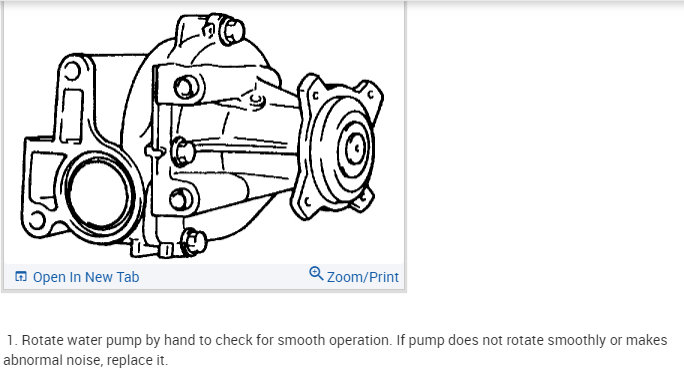

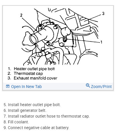

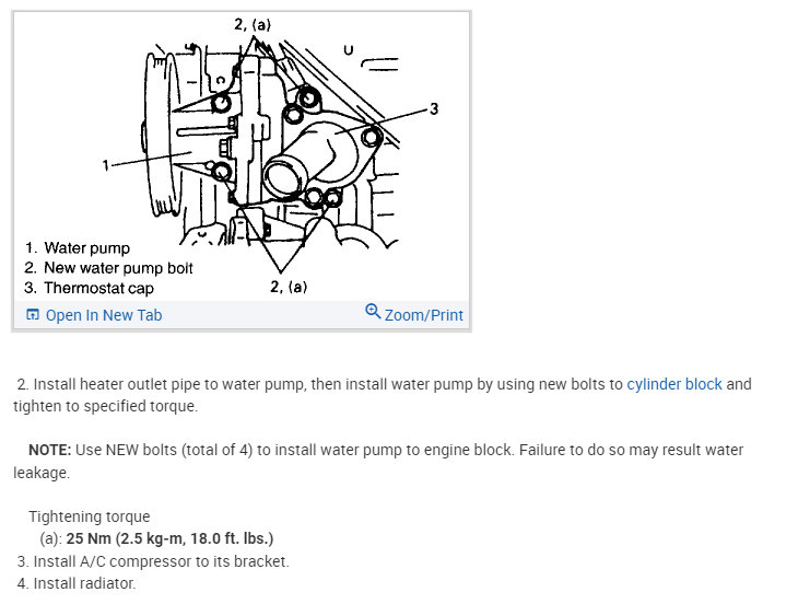

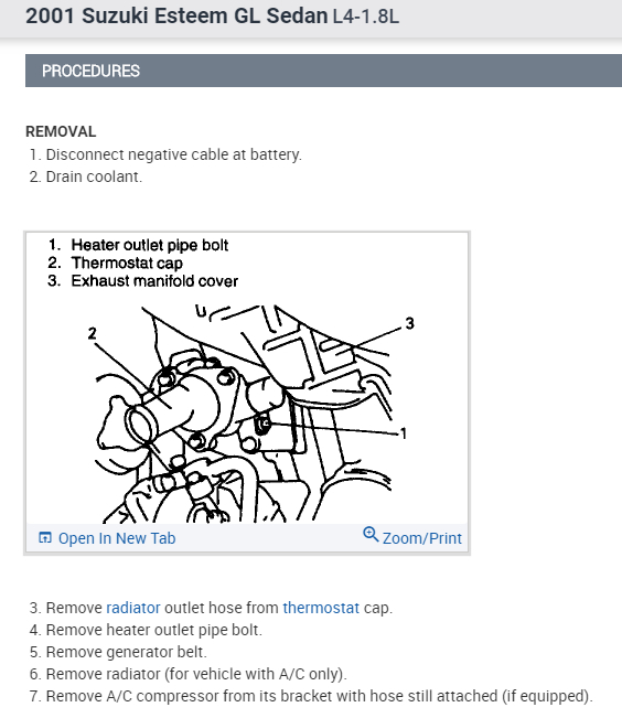

Here is a tutorial for you to view regarding water pump replacement:
https://www.2carpros.com/articles/water-pump-replacement
I've attached step-by-step picture instructions for your particular vehicle below.Hope this helps and thanks for using 2CarPros.
