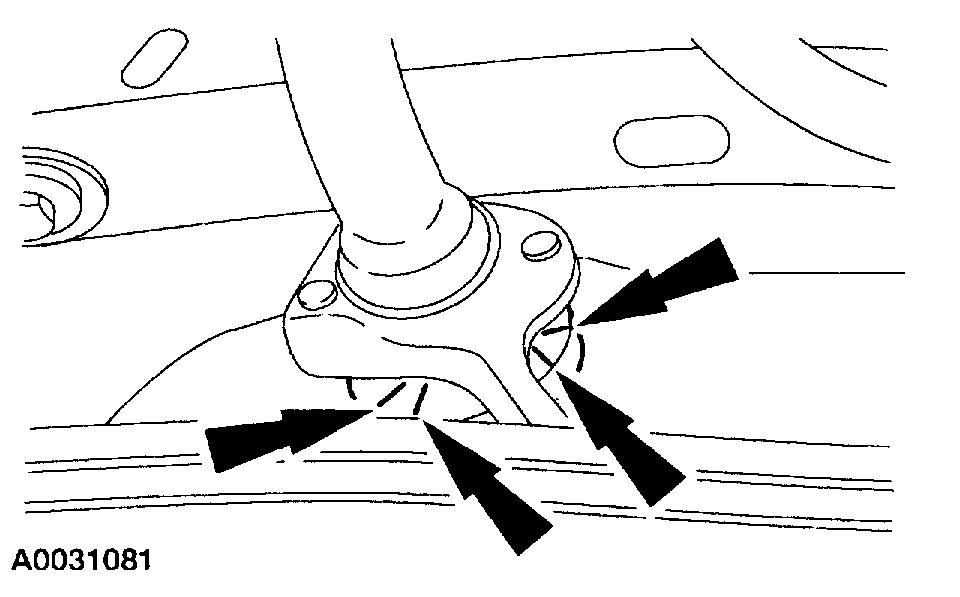

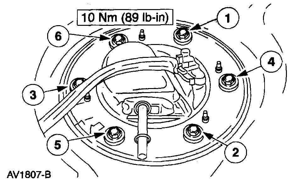

2. Remove the module assembly flange bolts.
NOTE: For installation, tighten the bolts in the sequence shown.
3. Clean the area around the fuel delivery module mounting flange.
pic 2

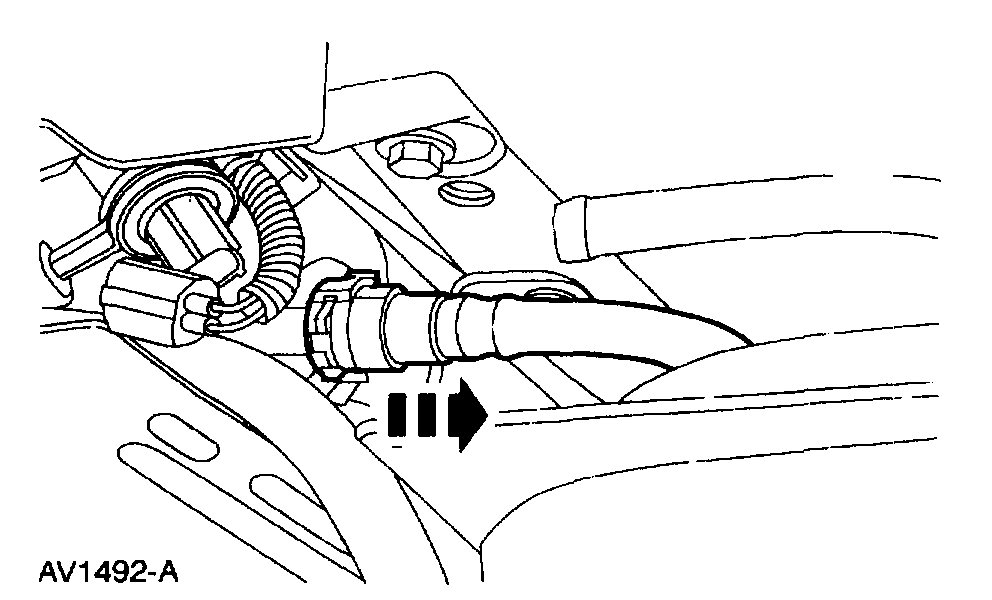

You will need to remove the fuel tank to access the pump. Here are the directions for that. The remaining pics correlate with the directions.
2003 Ford Mustang V8-4.6L DOHC VIN R
Fuel Tank Removal and Installation
Vehicle Powertrain Management Fuel Delivery and Air Induction Fuel Tank Service and Repair Procedures Fuel Tank Removal and Installation

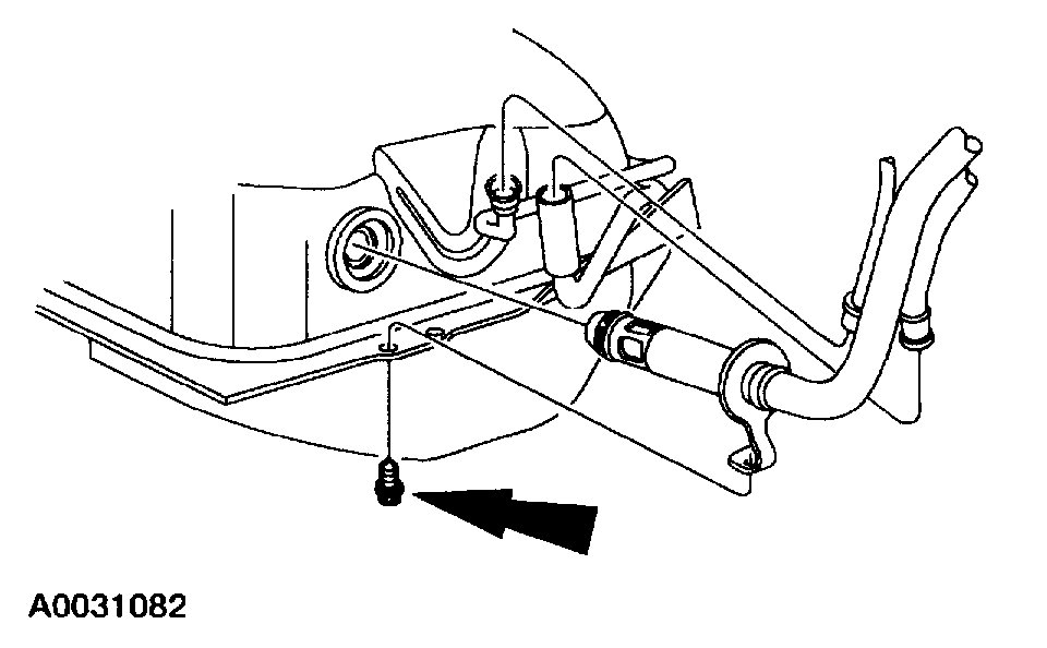

4. Raise the vehicle.
pic 4

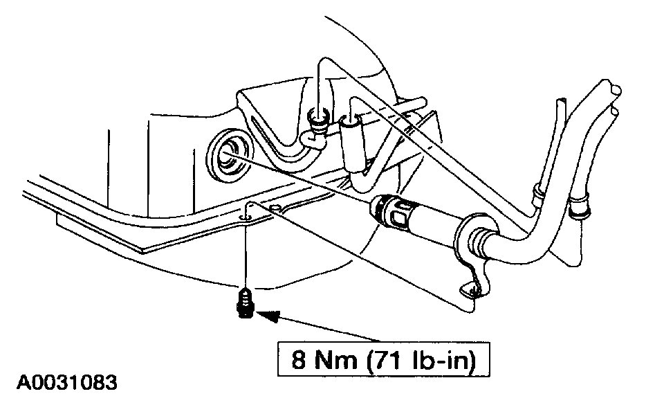

5. Remove the filler pipe bolt and disconnect the filler pipe hose connections to the fuel tank.
pic 5

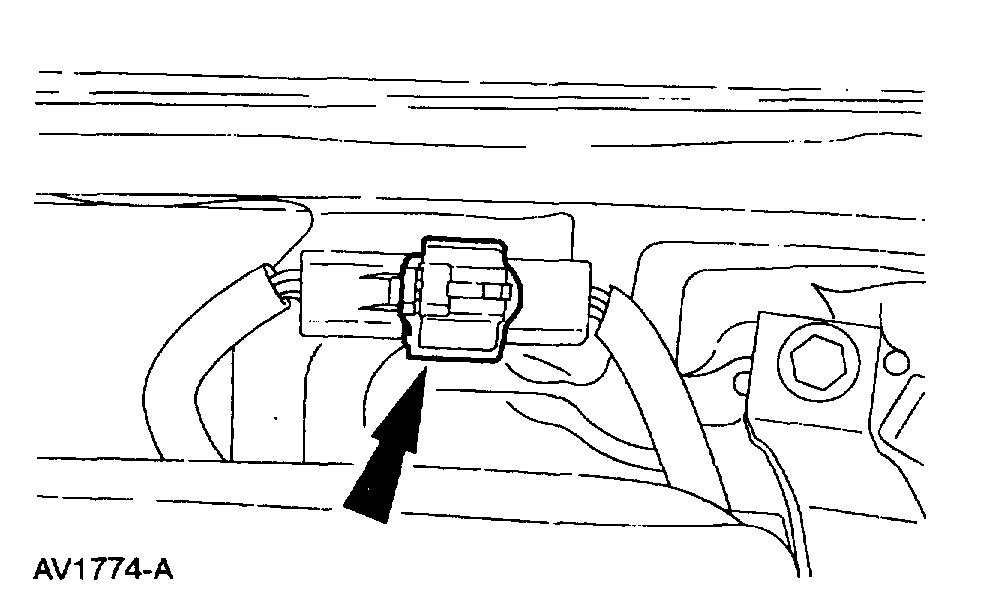

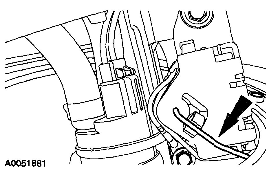

6. Disconnect the fuel tank electrical connector.
pic 6

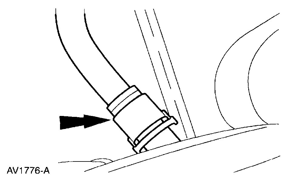

7. Disconnect the vapor tube fitting at the left front of the fuel tank.
pic 7

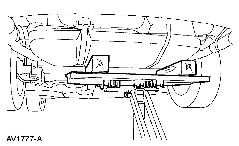

9. Place a safety support under the fuel tank.
pic 9

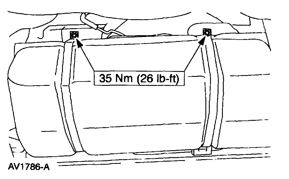

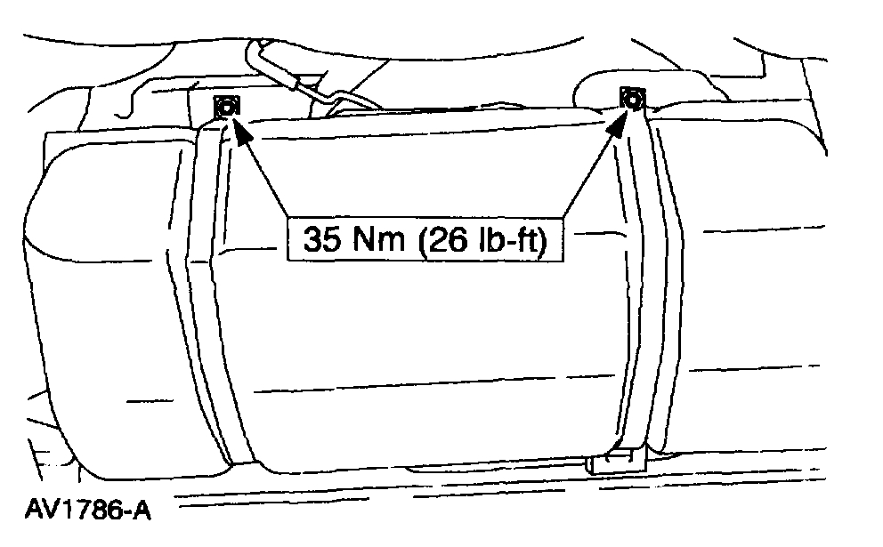

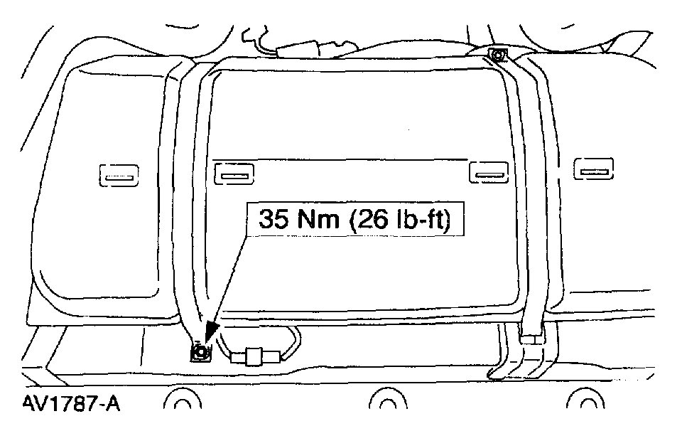

10. Remove the front bolts from the fuel tank support straps and swing the LH strap out of the way.
pic 10
11. Remove the RH fuel tank support strap bolt and remove the strap.
