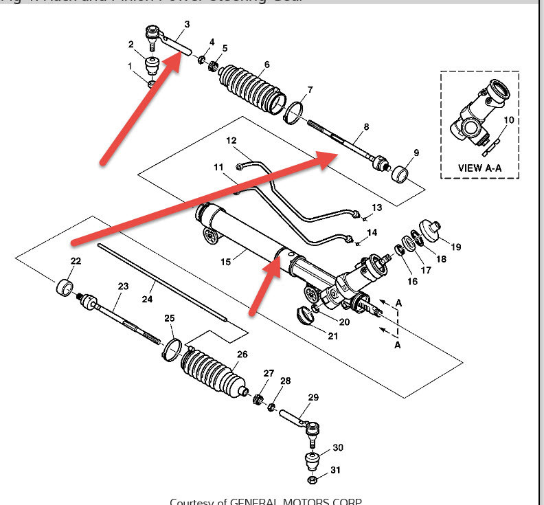

Bent lower control arm

I changed the lower control arm it is brand new, but what i noticed was that the axle cracked the drive knuckle or spindle so i am going to change that next but here is a picture of it with the wheel turned straight.

it is something in the steering linkage like tie rod inner or outer. see picture.
