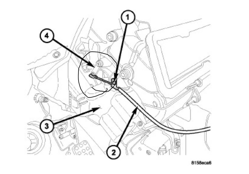

Do you know where the blend door actuator for A/C is located. Thanks

Good afternoon,
You do not have a blend door actuator. You have a cable that controls the temperature.
NOTE: Illustration shown with instrument panel removed for clarity.
1. Disconnect and isolate the negative battery cable.
2. Disengage the center bezel from the instrument panel to gain access to the back of the A/C-heater control See: Dashboard / Instrument Panel > Removal and Replacement > Center Bezel.
3. Disconnect the temperature control cable from the A/C-heater control See: Control Assembly, HVAC > Removal and Replacement > A/C and Heater Control - Removal.
4. Remove the steering column opening cover See: Dashboard / Instrument Panel > Removal and Replacement > Steering Column Opening Cover - Removal.
5. Remove the screw (1) that secures the temperature control cable (2) to the left side of the HVAC air distribution housing (3).
6. Disconnect the temperature control cable from the blend door pivot lever (4) and remove the cable from the vehicle.
