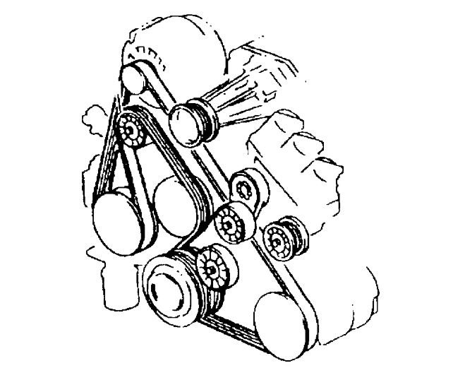

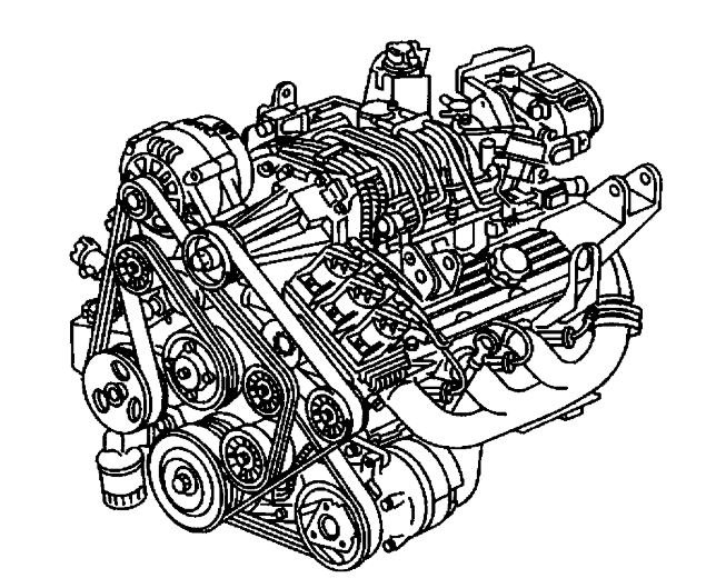

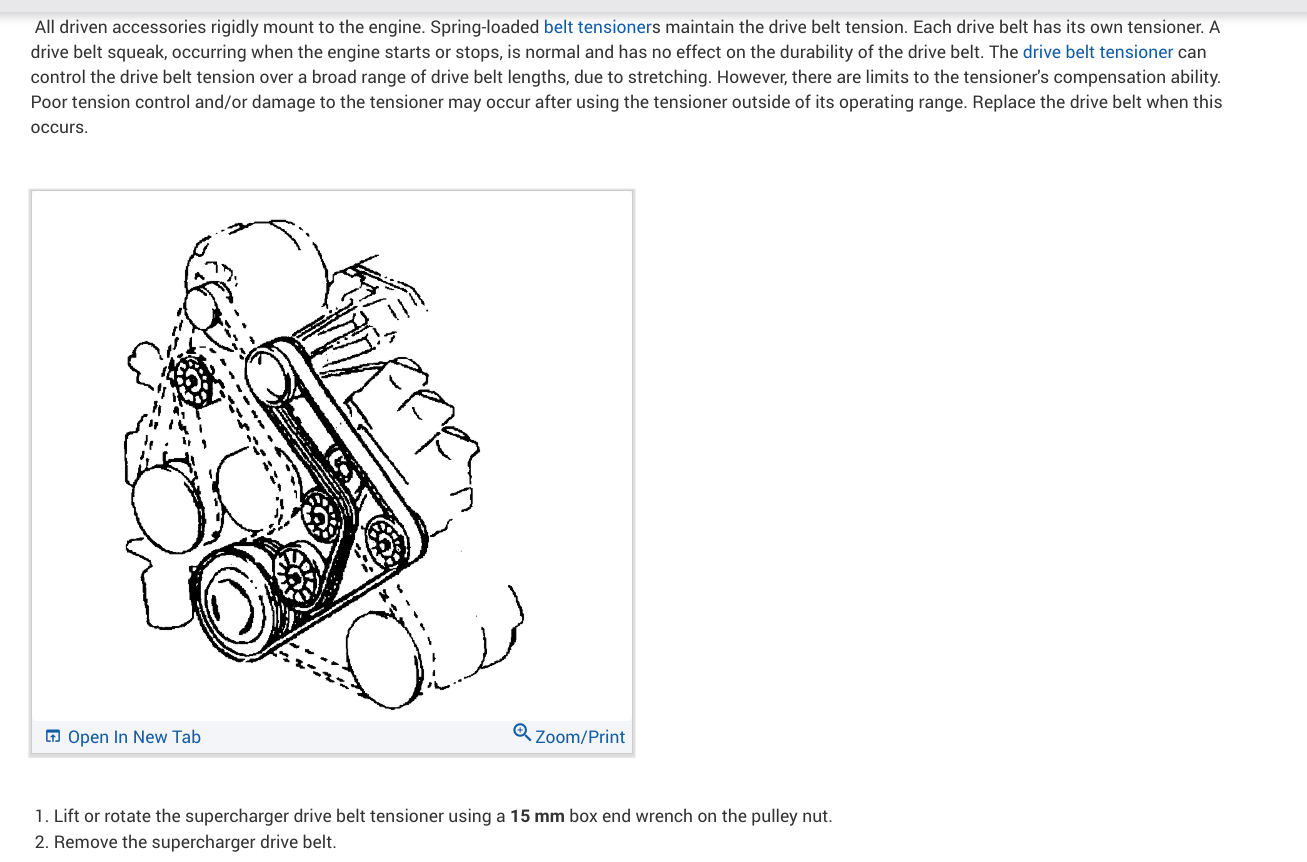

Hello, I'm looking to remove the serpentine belt and the supercharger belt on my car listed above supercharger.
Dec 18, 2019 at 5:19 AM
Good evening,

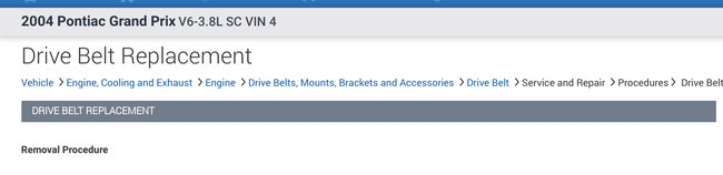

I attached the procedure and pictures for you for the replacement.
Let me know if you have any other questions.

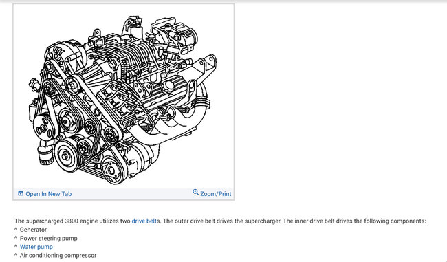

The supercharged 3800 engine utilizes two drive belts. The outer drive belt drives the supercharger. The inner drive belt drives the following components:
Generator
Power steering pump
Water pump
Air conditioning compressor

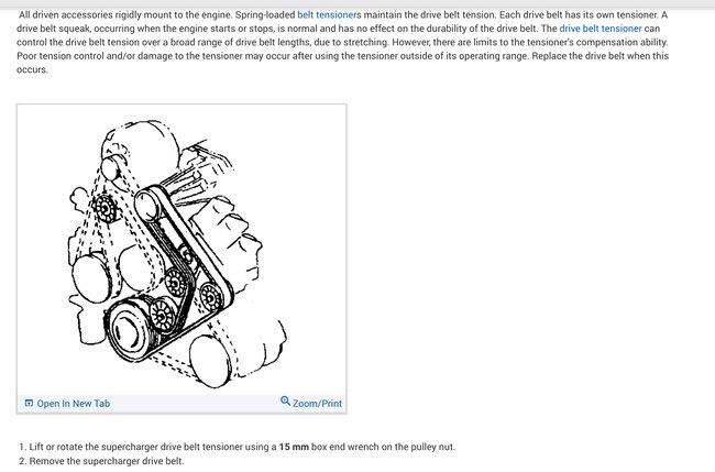

All driven accessories rigidly mount to the engine. Spring-loaded belt tensioners maintain the drive belt tension. Each drive belt has its own tensioner. A drive belt squeak, occurring when the engine starts or stops, is normal and has no effect on the durability of the drive belt. The drive belt tensioner can control the drive belt tension over a broad range of drive belt lengths, due to stretching. However, there are limits to the tensioner's compensation ability. Poor tension control and/or damage to the tensioner may occur after using the tensioner outside of its operating range. Replace the drive belt when this occurs.

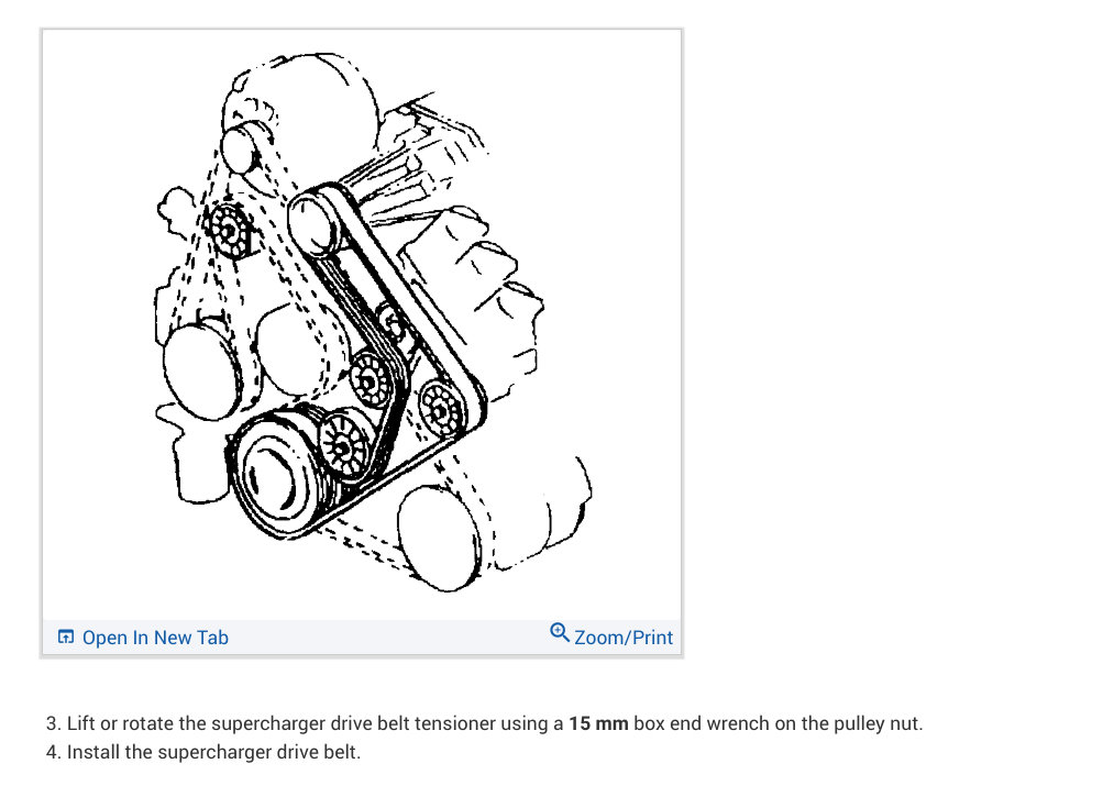

1. Lift or rotate the supercharger drive belt tensioner using a 15 mm box end wrench on the pulley nut.
2. Remove the supercharger drive belt.

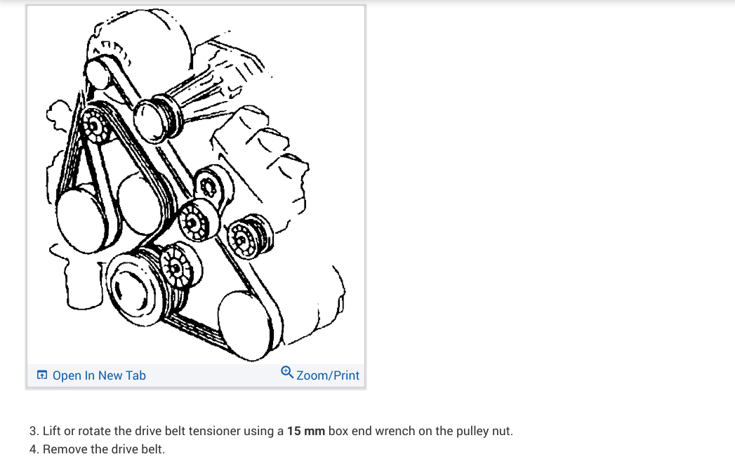

3. Lift or rotate the drive belt tensioner using a 15 mm box end wrench on the pulley nut.
4. Remove the drive belt.

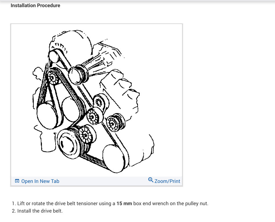

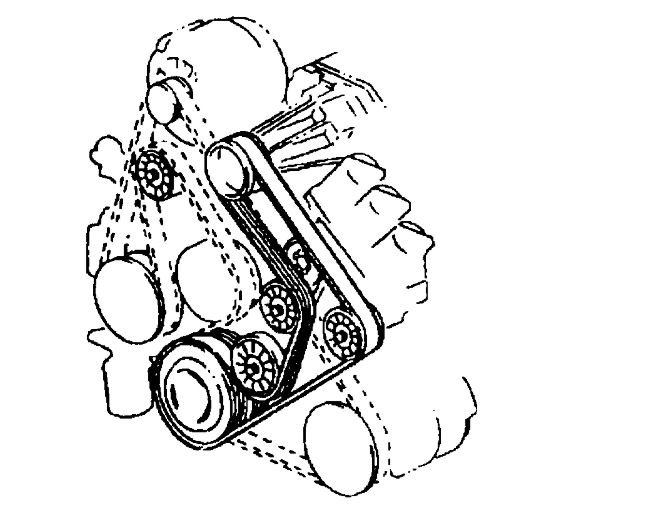

Installation Procedure
1. Lift or rotate the drive belt tensioner using a 15 mm box end wrench on the pulley nut.
2. Install the drive belt.
3. Lift or rotate the supercharger drive belt tensioner using a 15 mm box end wrench on the pulley nut.
4. Install the supercharger drive belt.

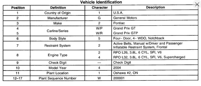

Hey, what does the Vin 4 mean in the diagrams?
Oct 18, 2020 at 3:49 PM
The engine for the car. It is a 3.8 option. It is the 8th digit in the VIN or vehicle identification number that identifies your engine size.
I attached a chart for you of the VIN breakdown.
