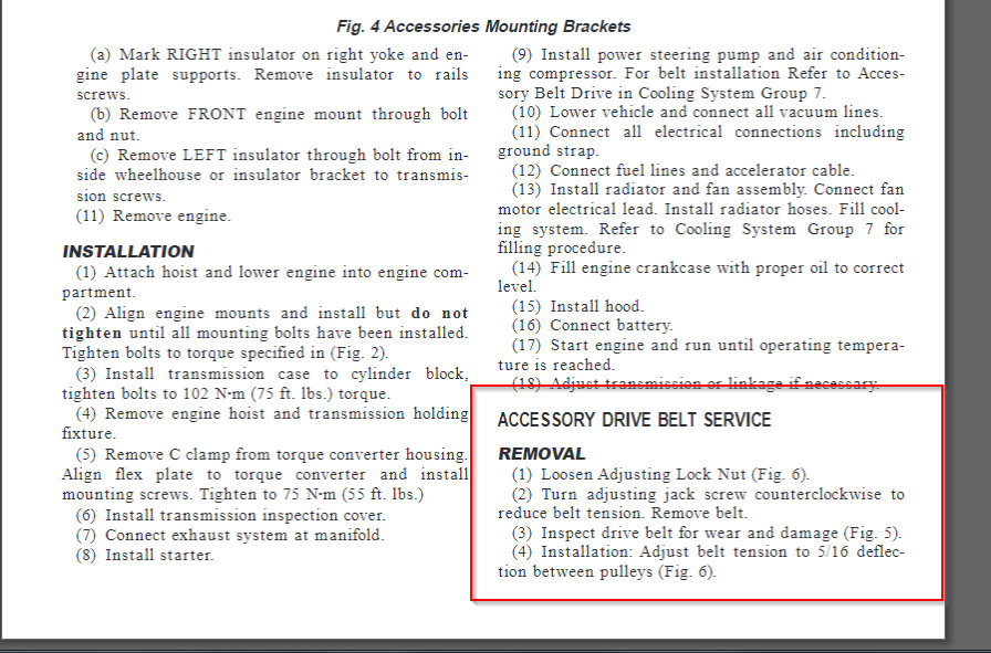

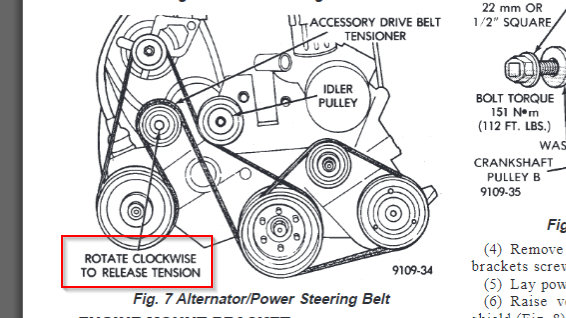

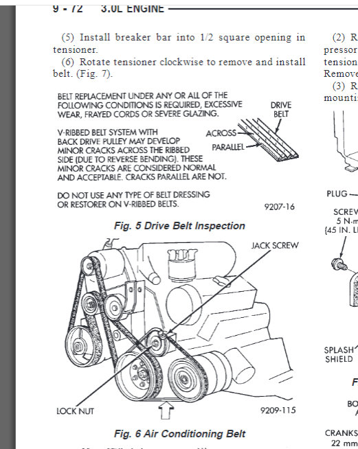

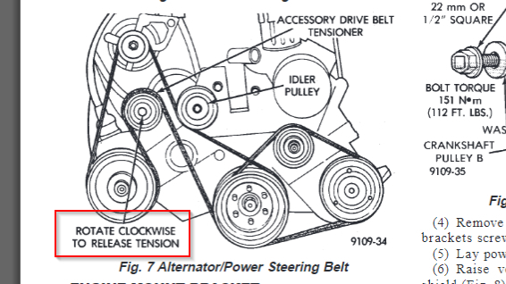

Here is a guide to help you step by step with the diagrams in the link below:
and
https://www.2carpros.com/diagrams/chrysler/lebaron/1992
May 4, 2020 at 5:18 AM
I included the process for each belt. The accessory drive belt has a tensioner and then the A/C belt has an adjusting screw.
Let me know if you have questions and we can go from there. Thanks

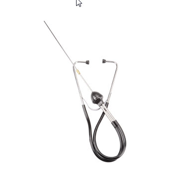

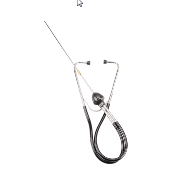

Yes. This is most likely a pulley. Now that the belt is new and tighter then the old belt it is putting more pressure on the pulley and it is making more noise.
The way to find out which one this is so you don't have to replace them as guesses. You can get a mechanic stethoscope and it will pinpoint which bearing it is. They are about $5.00 from most online stores.
https://www.2carpros.com/articles/car-squeaking-noise
