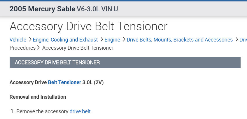

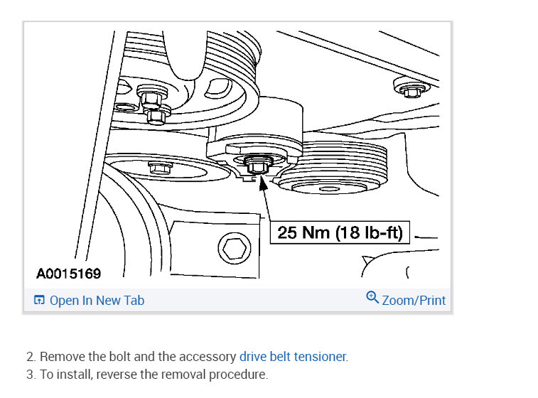

Bearing in idler pulley is bad and needs to be replaced
2005 MERCURY SABLE
160,000 MILES • 3.0L • 6 CYL • 2WD • AUTOMATIC
JON DAVID SCHOOLS
YouTube shows wrong motor.
Nov 23, 2019 at 12:09 AM
SCGRANTURISMO
  • 4,897 POSTS
The procedure is pretty straightforward and simple. I have included it in the diagrams down below for you. I hope this helps. Check out the diagrams (Below). Let us know what happens and please upload pictures or videos of the problem.
