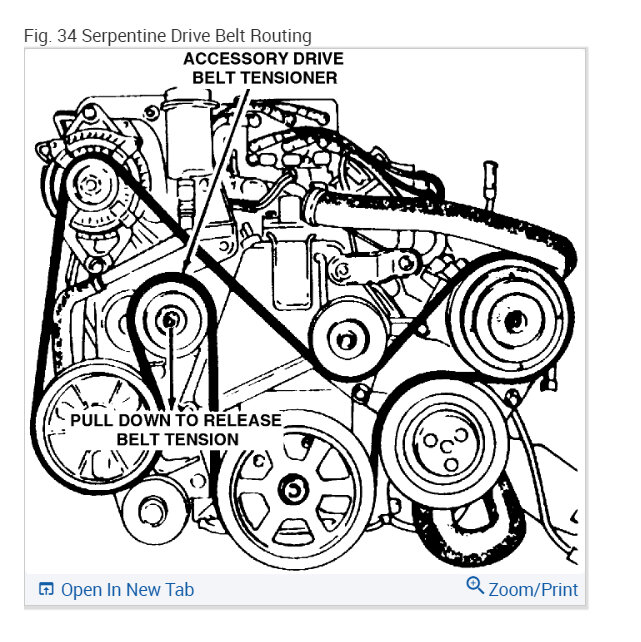

How to remove the serpentine belt tensioner?
1995 DODGE GRAND CARAVAN
104,000 MILES • 3.3L • 6 CYL • 2WD • AUTOMATIC
ROBINETTEZ
Serpentine Belt Tensioner removal.
Dec 29, 2022 at 9:37 AM
  • 54,837 POSTS
First you must remove the serpentine belt, then the tensioner is attached by stud through the bracket with a nut on the back of the bracket. Check out the image below to help see what I am talking about. Check out the images (below). Let us know what happens and please upload pictures or videos of the problem.
