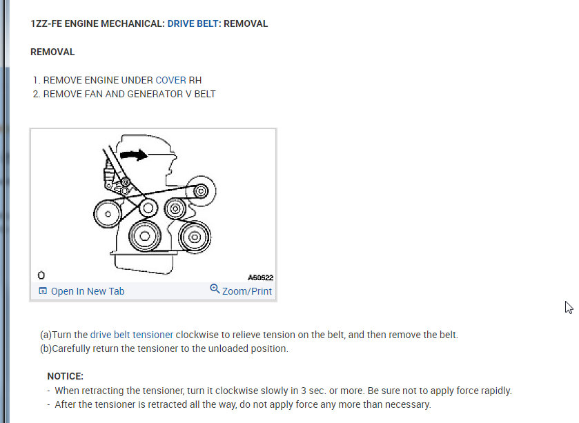

New belt squeak. Tensioner?
Nov 15, 2020 at 2:24 AM
This could be the tensioner but I bet there was just something that got on a belt or a pulley that is causing the noise.
https://www.2carpros.com/articles/car-squeaking-noise
I would just get some stuff called belt dressing and see if it stops. If it does not then I would replace the tensioner as the incorrect tension is the next most likely cause.
Let us know what questions you have and we can go from there.
Nov 15, 2020 at 2:39 AM
KEVIN COPLEY
Ended up being oil on the belt! But thank you so much for replying and I'll keep you guys in mind for future problems i can't figure out. You guys are awesome!
