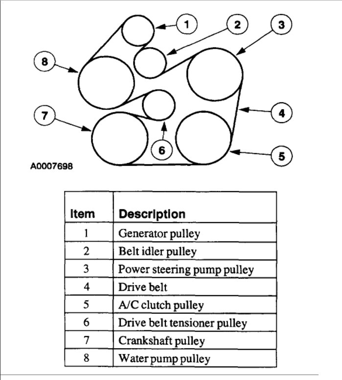

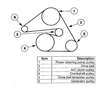

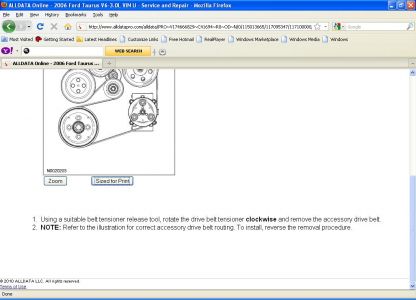

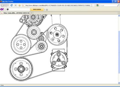

I need diagram of serpentine belt routing for this car, please, if you would.
Sep 13, 2016 at 12:53 PM
CJ MEDEVAC
  • 11,004 POSTS
There were two choices to get into "Prodemand" I just guessed at yours being an "SE" (the SEL may be exactly the same as far as the belt) Just let me know (you have a SEL) I will look up the other model. Check out the diagrams (Below). Please let us know if you need anything else to get the problem fixed.

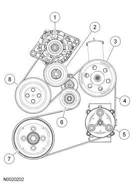

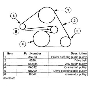

How do you loosen the belt(s) so the alternator can be reinstalled and then how do you tighten them
Jun 29, 2021 at 3:00 AM (Merged)
SATURNTECH9
  • 30,869 POSTS
https://images.2carpros.com/forum/automotive_pictures/416332_2006_ford_taurus_belt_removal_part1_1.jpg
https://images.2carpros.com/forum/automotive_pictures/416332_2006_ford_taurus_belt_removal_part2_1.jpg
I posted a diagram of your belt routing and belt tensor.Your tensor is spring loaded no adjustment.All you do is what the instruction's i posted say take a wrench put it on the belt tensor pulley bolt and turn it clock wise to release the tension then remove the belt.Then when your done route the belt around the pulley's and get a wrench and turn the tensor pulley bolt clockwise to get the belt back on.

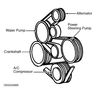

Hopefully it is a 2valve 3.0 Liter engine.If so here is a diagram of what pulleys are for what. The tensioner has a bolt head, use a wrench to get the spring loaded tensioner to swing away so that the belt can be installed
https://images.2carpros.com/forum/automotive_pictures/1639_ford_4.jpg

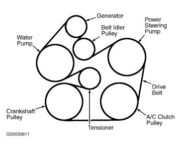

I will give you both two and four valves routing just follow this link
https://www.2carpros.com/diagrams/ford/taurus/2003
Here is a guide to show you what you are in for when doing the job.
Here is the diagrams (below)

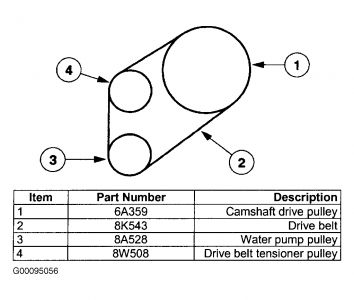

RA.STERN

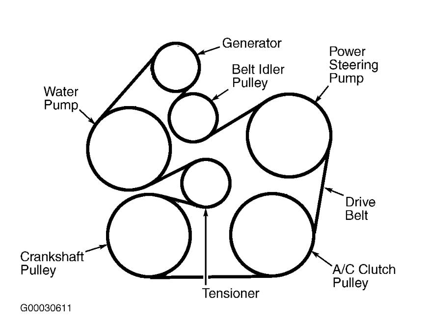

what tensions the drive belt. I need to loosen something to take the tension off the belt
BMRFIXIT
  • 19,053 POSTS
https://images.2carpros.com/forum/automotive_pictures/99387_Graphic_56.jpg
https://images.2carpros.com/forum/automotive_pictures/99387_Graphic1_662.jpg

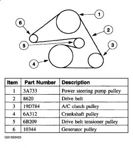

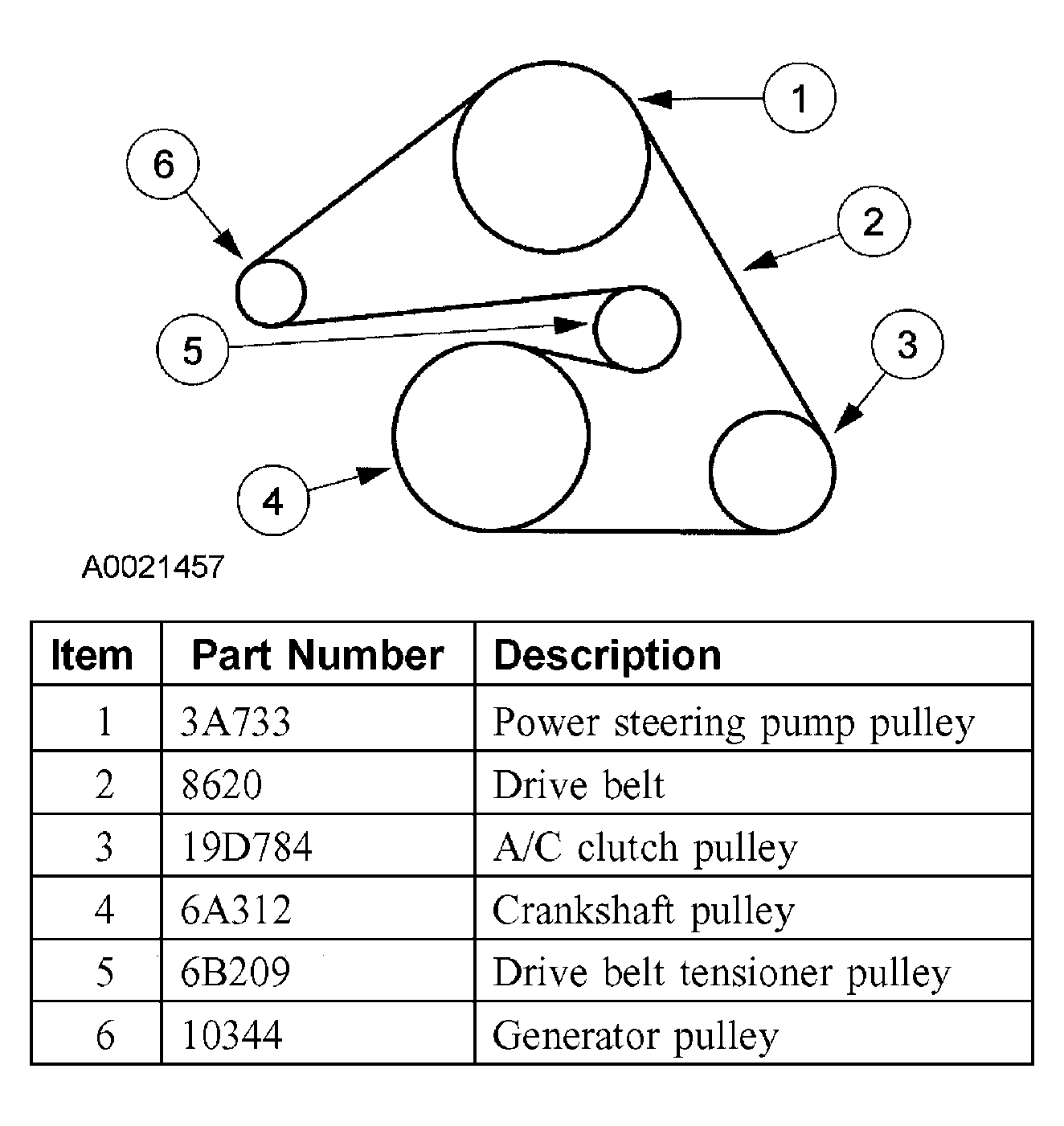

REBEL92
what is the routing for the serpentine belt on the 2001 ford taurus se with a 3.0L v6 vulcan engine?
Jun 29, 2021 at 3:01 AM (Merged)
BMRFIXIT
  • 19,053 POSTS
hope that help let me know
https://images.2carpros.com/forum/automotive_pictures/99387_taurus_v6_belt_1.jpg

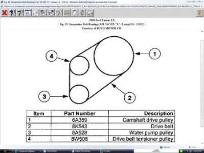

BADWIFE

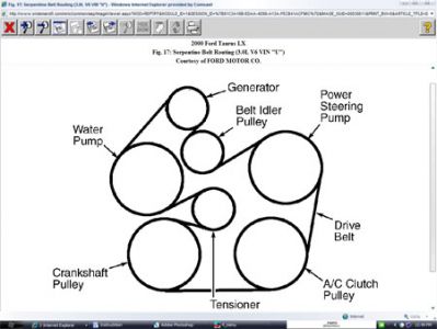

belt diagram diagram for 2000 ford taurus serpentine belt?
MERLIN2021
  • 17,250 POSTS
https://images.2carpros.com/forum/automotive_pictures/62217_Untitled1_1.jpg
https://images.2carpros.com/forum/automotive_pictures/62217_30S_1.jpg
Top is engine code U bottom is S

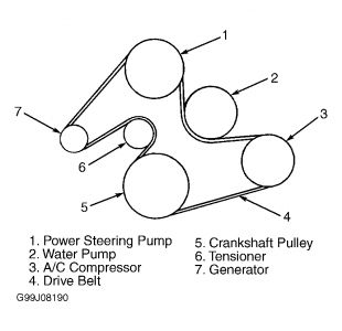

How do I find the correct belt for my car? There are so many out there that would 'Fit' my car when I searched internet. Does number of ribs important? My car is 2000 Taurus SE gas sedan. Is there a fix measurement that I can use to compare various brand, type or size? What would the best in the market? Good Year, Dayco ...
HMAC300
  • 48,601 POSTS
when you replace the tendsioner the pulley normally comes on it. as long as you give correct engine size and vin which in your case is U the tensioner is what holds the belt tight so replace that. stick with goodyear, dayco or Gates belts. dont' buy any tensioner that is made in CHINA. I'm also sending blet routing so you can install it correctly. if you don't have the routing diagram

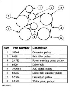

I need to replace the belt on my 1998 Ford Taurus car but there are no instructions on the motor or in the owner's manual. HOw do I get a diagram of the way the belt goes back on. I have the belt but don't know how to put one back on.
Jun 29, 2021 at 3:02 AM (Merged)
ZACKMAN
  • 4,202 POSTS
Locate your VIN number. Count from left to right, the 8th digit will be either "S" or "U". For example, if the first 10 numbers of your VIN are ABC123DEF4, the 8th digit will be "E". If it is "S"
https://images.2carpros.com/forum/automotive_pictures/55316_taurusvinsbelt_1.jpg
and if it is "U"
https://images.2carpros.com/forum/automotive_pictures/55316_taurusvinubelt_1.jpg
