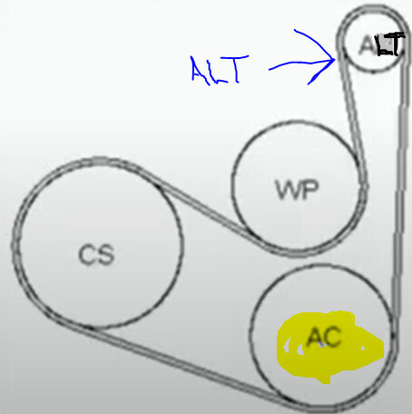

Belt routing diagram needed?
114,504 MILES • 1.8L • 2WD • AUTOMATIC
ALLISON BEAU
Just need to see how the belt should go and which pulleys are which.
Feb 28, 2023 at 7:30 AM
  • 110,248 POSTS
There are two different diagrams based on if the vehicle has AC or not. If you look below, pic 1 shows the belt routing for a vehicle without A/C.

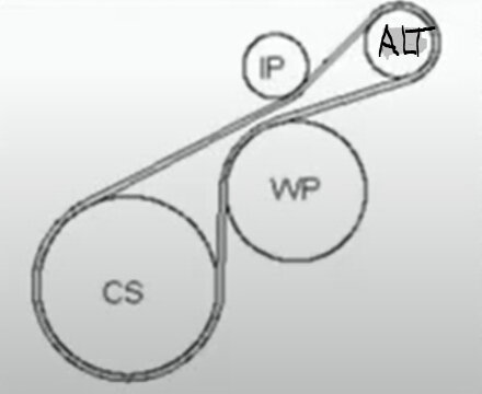

Pic 2 below shows routing for one with factory A/C.
Let me know if this helps. Also, here is a link that explains in general how one is replaced:
