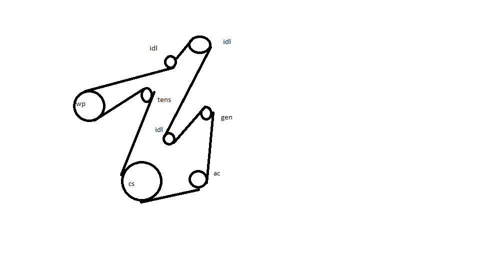

Belt broke. Nothing under hood, in owners manual, or online that I can find.

I found this information in a tune-up manual for your vehicle. I had to go to paint then draw it. It is not perfect, hope it helps. I used abbreviations for the pulleys.
Sep 17, 2017 at 4:31 AM
JDL
  • 16,098 POSTS
Just to add, the tune-up manual I used has belt routing diagrams for many vehicles, not just yours.

Thanks I finally got it.

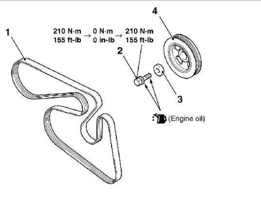

I have found this diagram (below) and guide to help the next person to this post.
