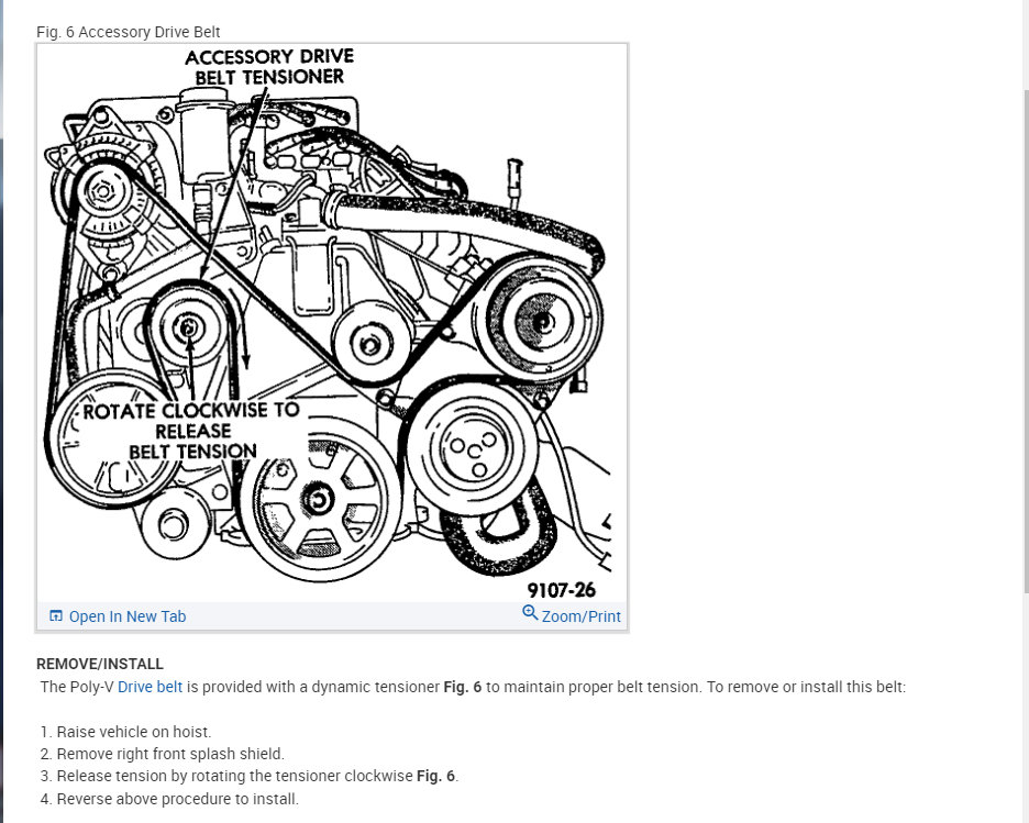

Procedure for belt replacement specially how to work on tensioner to put the belt on pulleys.
Oct 11, 2020 at 7:29 AM
Here is the process and detail on which way to turn the tensioner. You use a wrench or belt removal tool (just a long bar that gives more leverage, it is not required) on the nut on the pulley and turn it clockwise and that will remove the tension.
Let us know if you have other questions. Thanks
