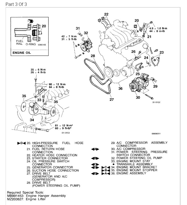

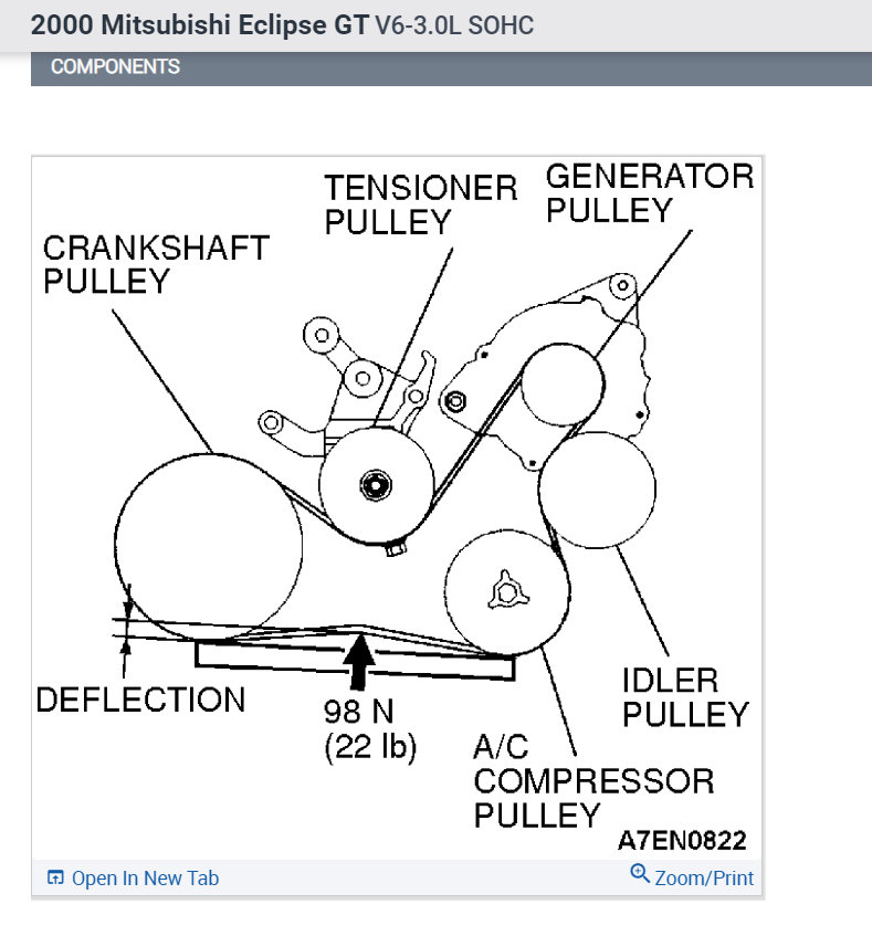

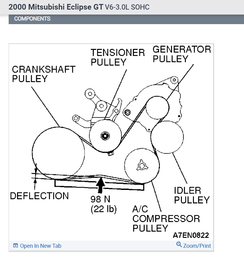

Need to replace the A/C compressor and both belts on the car listed above, GT, Gen 3.
Jun 29, 2022 at 1:11 PM
  • 54,840 POSTS
Yep, I have included a generic guide on how to change serpentine belts and the specific instructions in the diagrams and link below.
and
https://www.2carpros.com/diagrams/mitsubishi/eclipse/2000
