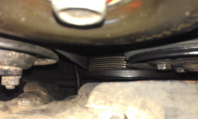

My 4.0 belt all the sudden started jumping one notch only on the harmonic balancer pulley , splitting the belt.. I reset it and it jumps one tooth everytime I restart the engine.. Replaced idler pulley and power steering to no avail.. any ideas ?

bad belts and tensioners will do this recommended replacement is 60k for belt and tensioner. check for worn grooves in balancer or sharp pieces there but soundls like you need a bet/tensioner

Groves on all pulleys are perfect.. and there is no tensioner on 1987 jeep Cherokee adjustments are made with power steering pump.. any other ideas ?

try a newbelt and use a belt tension gauge to adjust it. check alignment with a straight edge aswell.
