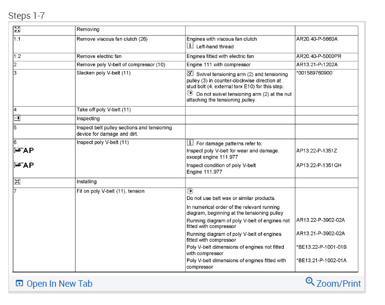

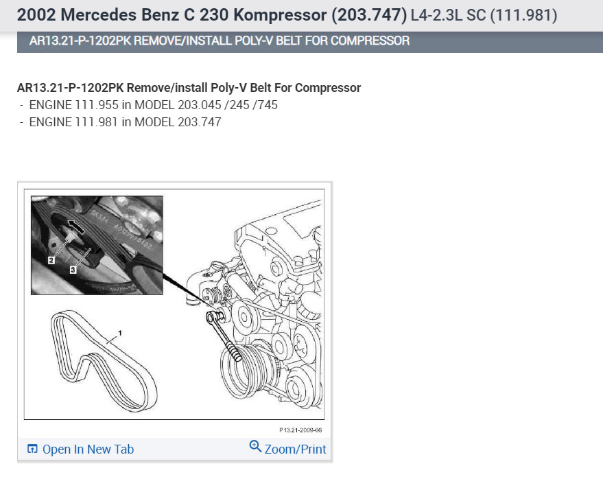

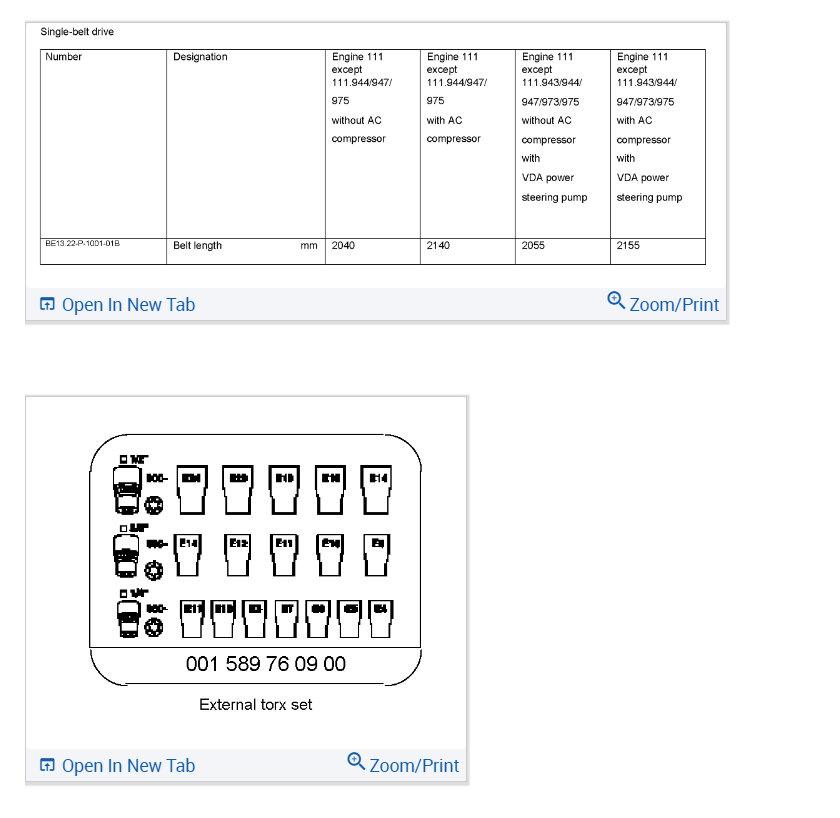

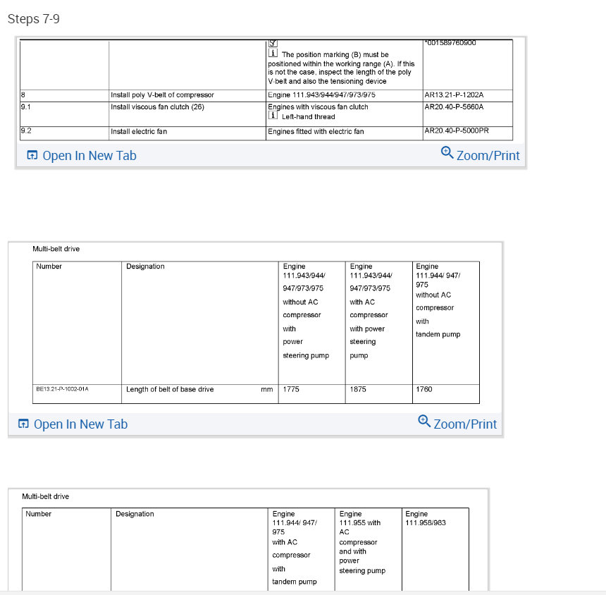

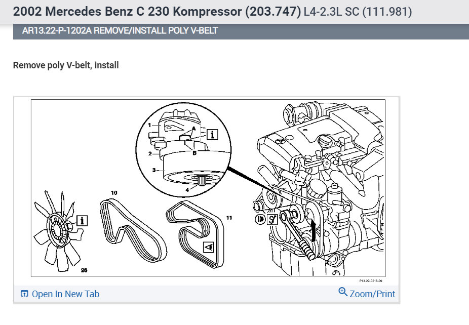

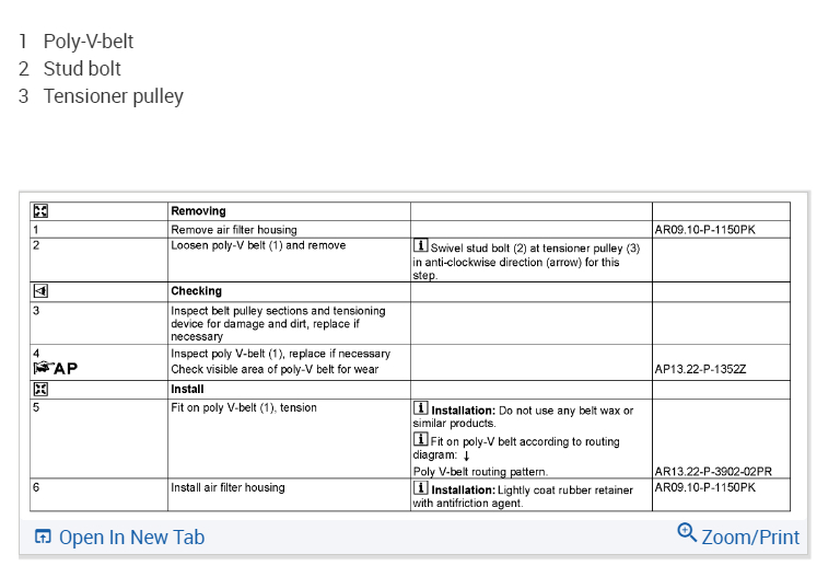

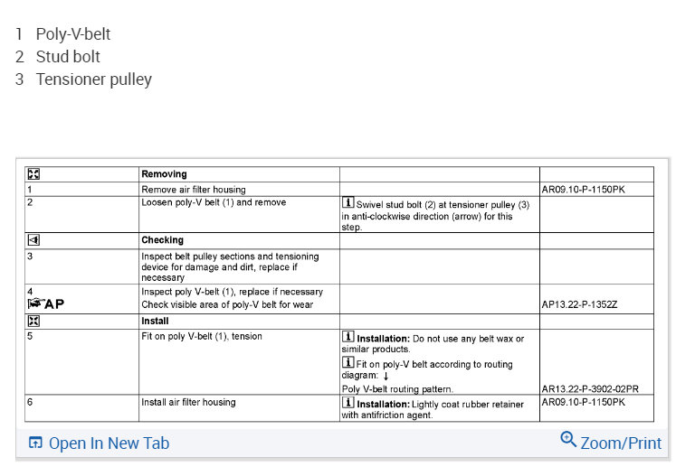

I need diagram for both belts for the car listed above, its a Kompressor. I need to know how both belts go on the one in back and on in front of the other one.
Aug 25, 2022 at 11:25 PM
  • 55,402 POSTS
Here is a video on how to change the belt out and I have left diagrams below to help as well:
https://youtu.be/K13tlf3toiU
and
https://www.2carpros.com/diagrams/mercedes-benz/c230/2002
