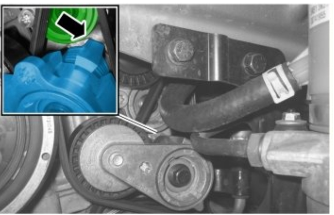

Is there a diagram for these belts? I see nothing online on how to get between them and the firewall. My guess is to take the wheel off.

Yes, the accessory drive belt(s). I think there are two.

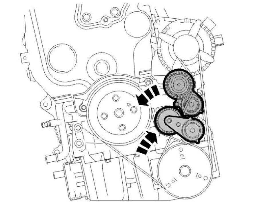

Removing the auxiliaries belts
pic 1

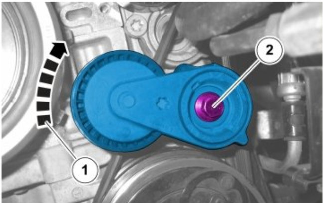

Outer belt
Relieve the load from the belt tensioner. Use: 999 7109 Wrench See: Vehicle > Electrical / Mechanical Repair > 999 7109 Wrench. Turn the belt tensioner clockwise as far as it will go. Remove the belt.
Inner belt
Relieve the load from the belt tensioner using a Torx-wrench. Turn the belt tensioner counter clockwise as far as it will go. Remove the belt.

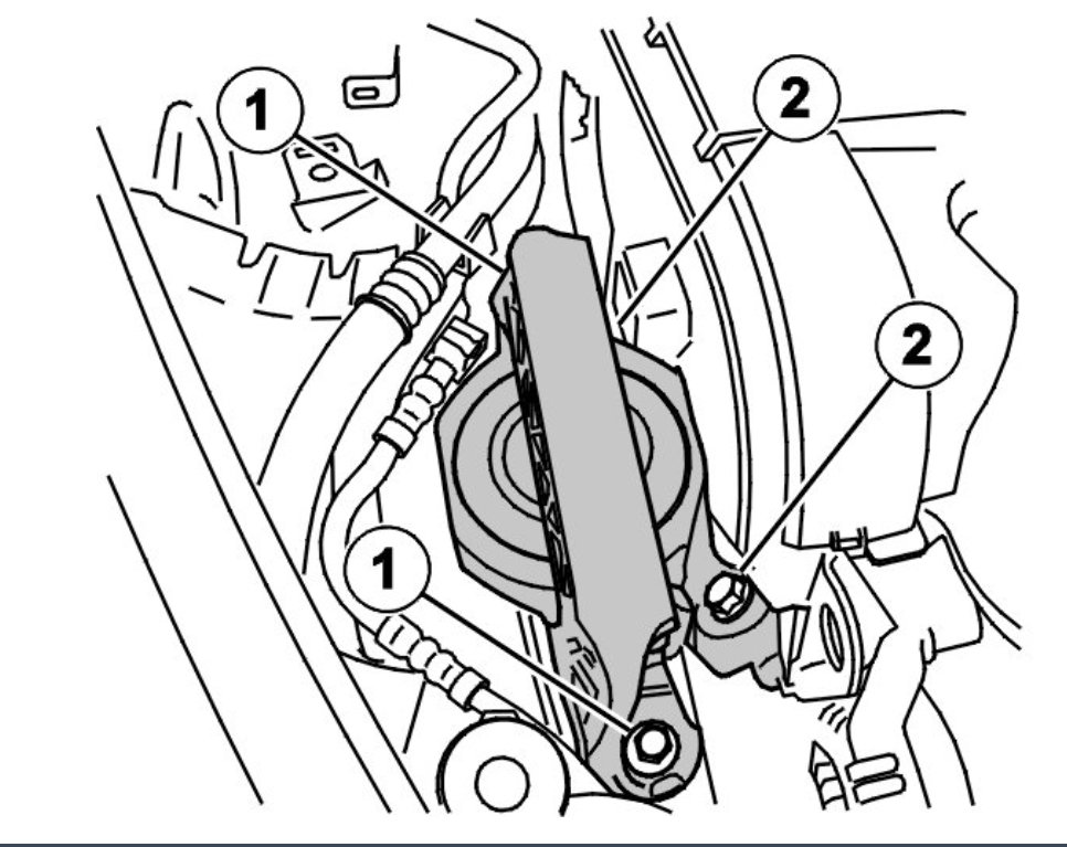

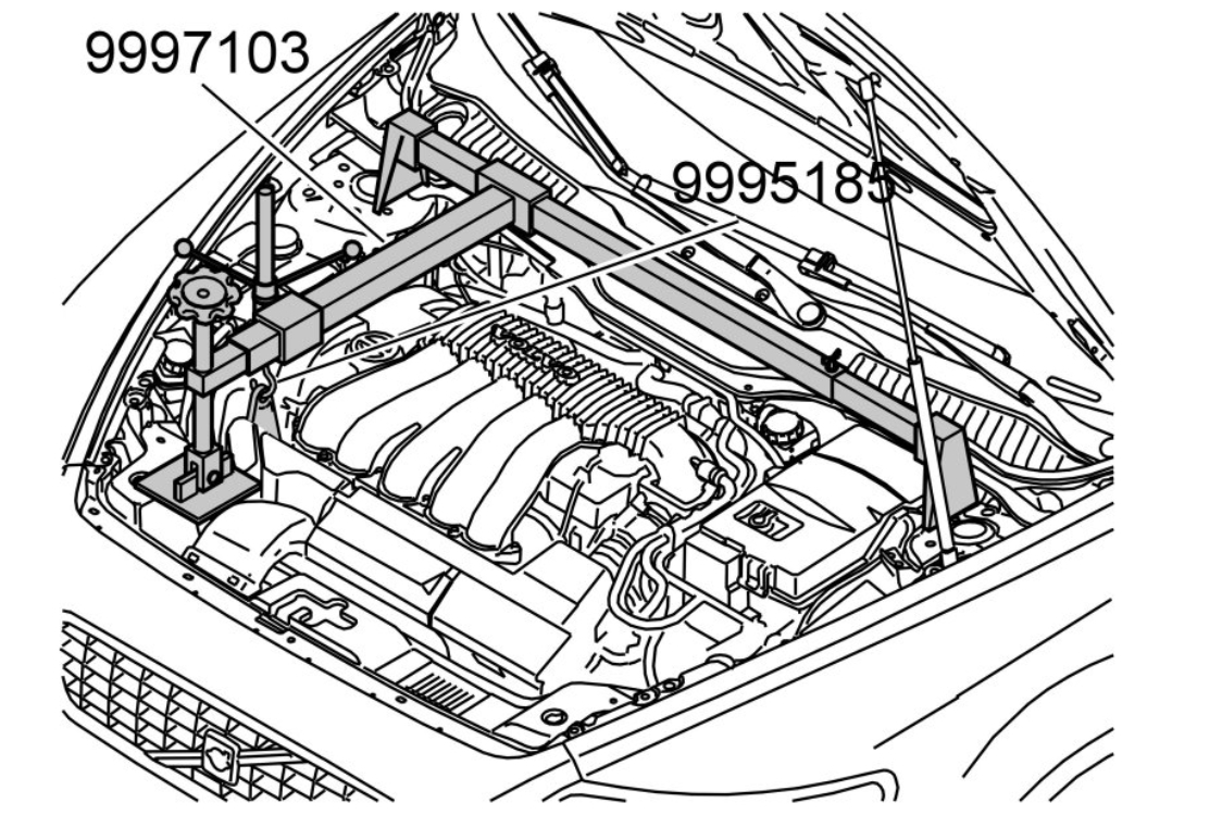

Install lifting beam: 999 7103 Lifting beam See: Vehicle > Electrical / Mechanical Repair > 999 7103 Lifting Beam together with hook: 999 5185 HOOK See: Vehicle > Electrical / Mechanical Repair > 999 5185 Hook. Tension the tool. Lift the expansion tank and place on the engine.
Note! Ensure that no coolant escapes.

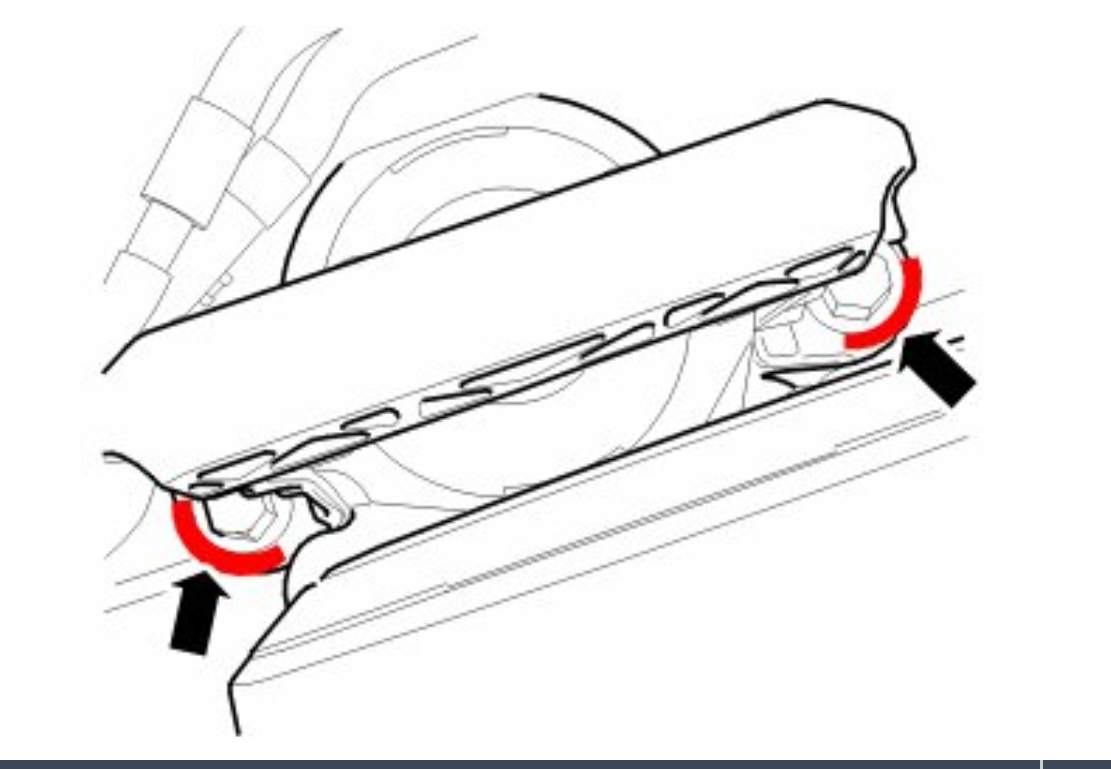

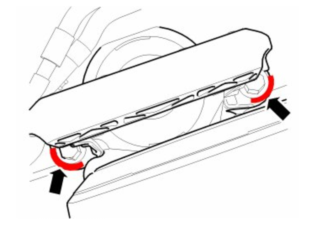

Marking the position of the engine pad
pic 4
Mark the position of the engine pad on the frame member. Use a marker pen.

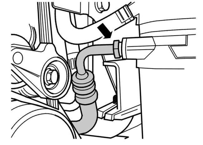

Removing the power steering pump pressure line
pic 5
Caution! Seal the openings.
Note! Clear up any oil spillage under the delivery line.
Disconnect the delivery line from the power steering pump.

When installing the outer belt tensioner, turn the belt tensioner clockwise (1) and hold it in that position.
Tighten screw (2).

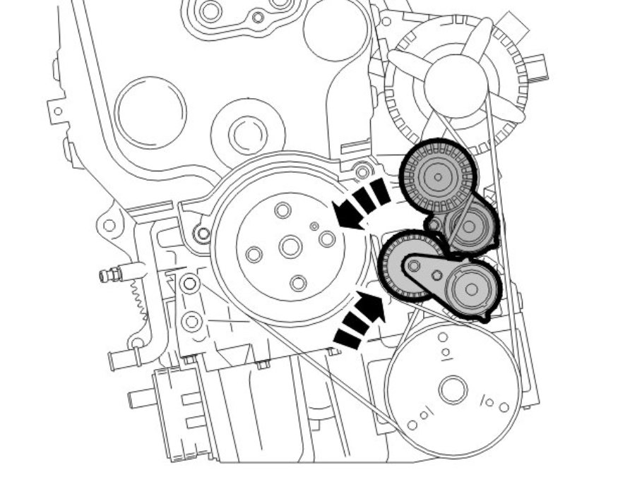

Installing the auxiliaries belt
pic 9
Caution! Ensure that the belts are correctly positioned in all the grooves.
Inner belt
Relieve the load from the belt tensioner. Turn the belt tensioner counter clockwise as far as it will go. Use a Torx-wrench. Install the belt.
Outer belt
Slacken off the tensioner. Use: 999 7109 Wrench See: Vehicle > Electrical / Mechanical Repair > 999 7109 Wrench. Turn the belt tensioner clockwise as far as it will go. Install the belt.
