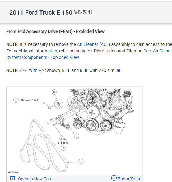

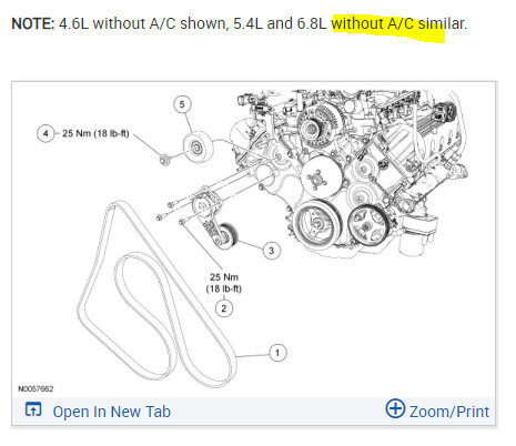

Interestingly, my manual is only showing an exploded view. I did attach those below. Note that the second pic is if the vehicle doesn't have A/C.
Let me know if this helps.

Thank you for this everything, it worked out perfectly. thanks again
