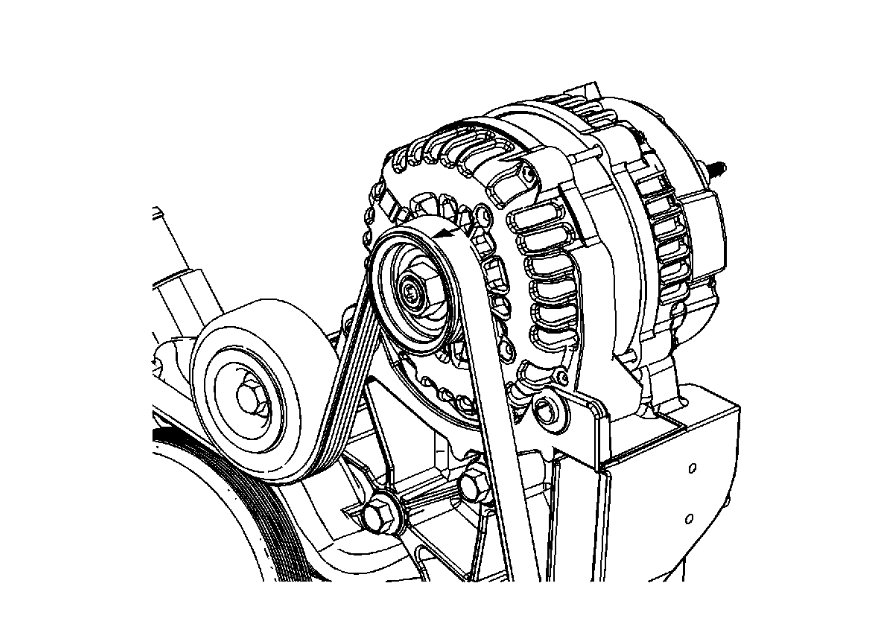

Installing the belts on the motor that only has the crank shaft, power steering pump,water pump and alternator.

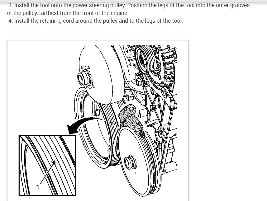

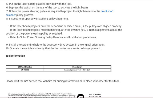

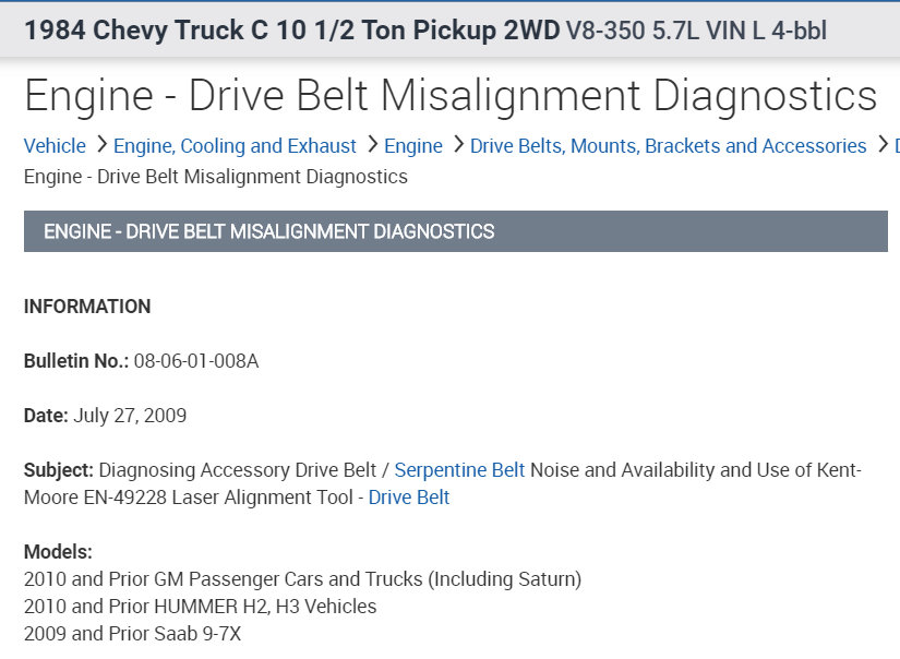

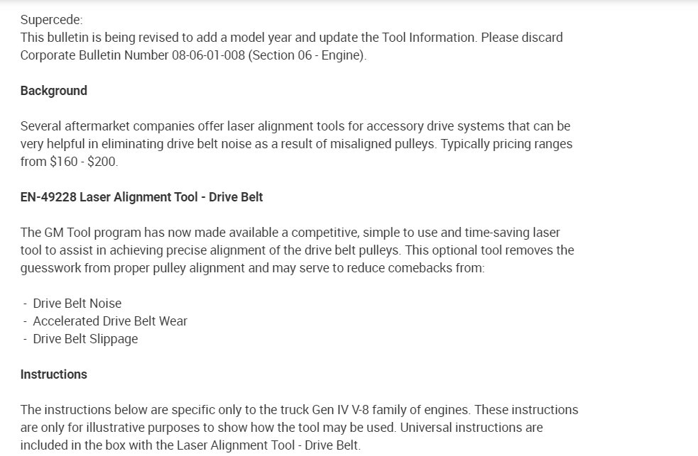

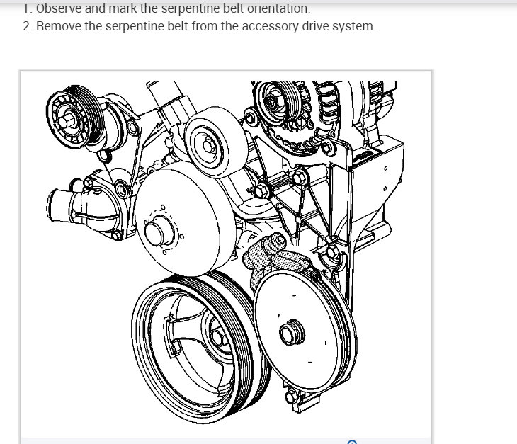

After an extensive search of both of our reference materials, the only thing that I could find that vaguely resembles a diagram of the drive belt routing for you is a Technical Service Bulletin(TSB) that has three partial diagrams on it. I have included the TSB in the diagrams down below. If it is a serpentine belt alls I can tell you is the pulleys with groves get the front side of the belt and the smooth pulleys get the back of the belt. Please get back to us with what you are able to figure out, and again, sorry about not having a complete diagram for you.
