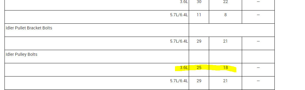

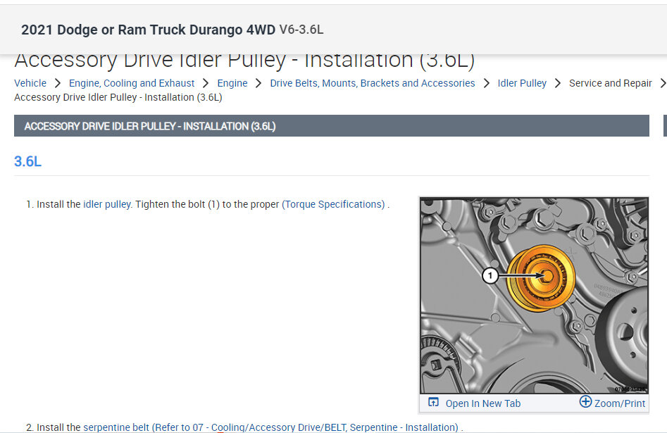

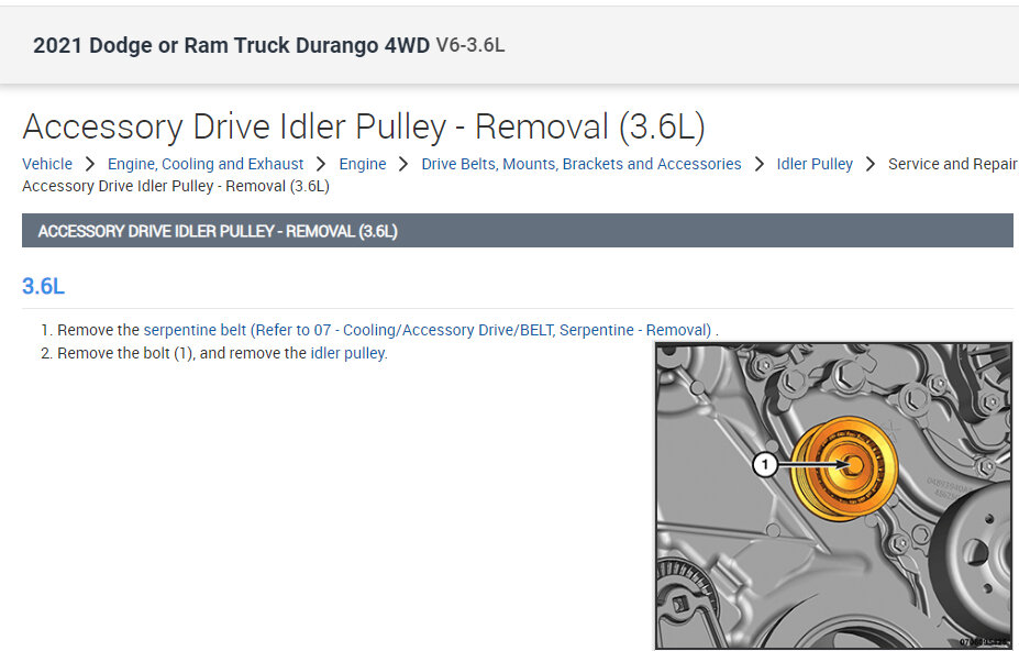

  • 110,251 POSTS
That is where I would start. I suspect the idler itself will resolve the issue. I attached the directions below and the torque specifications. Note it is 18 ft/lbs.
Let me know if this resolves the issue.
