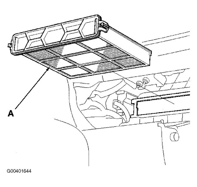

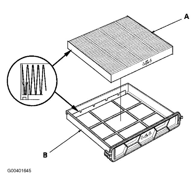

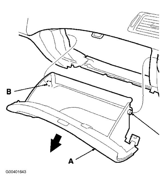

Dust and Pollen Filter Replacement
Open the glove box. Remove the glove box stop on each side, then let the glove box hang down (see PASSENGER'S DASHBOARD UNDERCOVER REMOVAL/INSTALLATION ).
Remove the dust and pollen filter assembly (A) from the evaporator.
Fig 1: Identifying Dust And Pollen Filter Assembly
Remove the filter (A) from the housing (B), and replace the filter.
Fig 2: Identifying Filter And Housing
Install the filter in the reverse order of removal. Make sure that there is no air leaking out of the evaporator.
