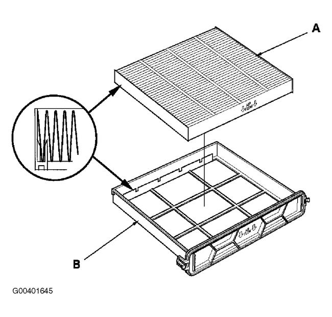

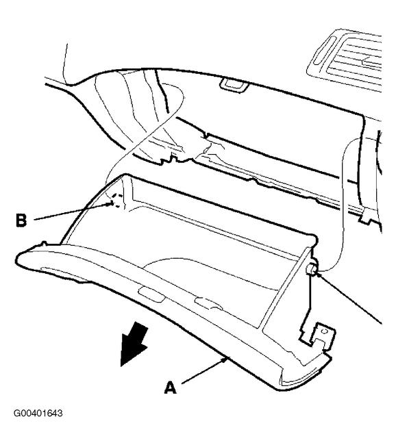

Dust and Pollen Filter Replacement
Open the glove box. Remove the glove box stop on each side, then let the glove box hang down (see PASSENGER'S DASHBOARD UNDERCOVER REMOVAL/INSTALLATION ).
Remove the dust and pollen filter assembly (A) from the evaporator.
Fig 1: Identifying Dust And Pollen Filter Assembly

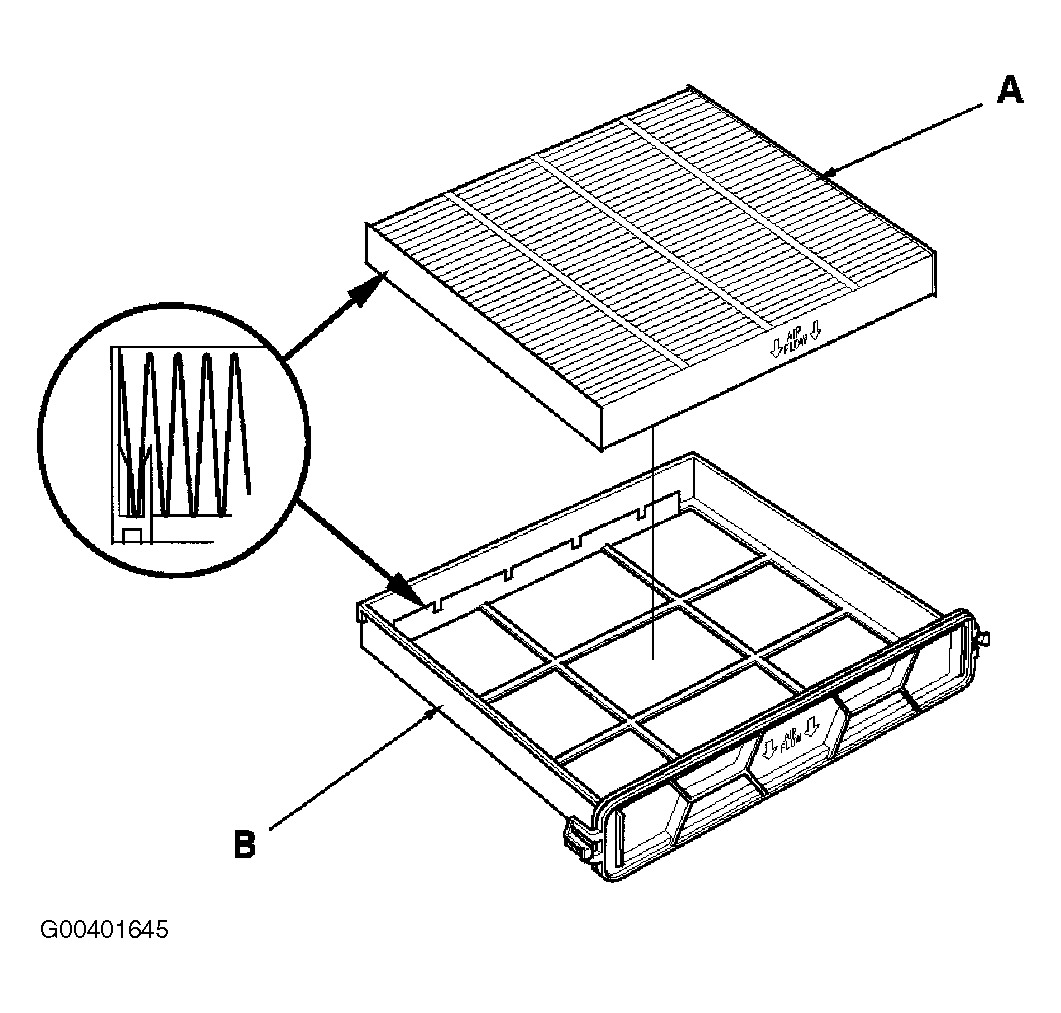

Remove the filter (A) from the housing (B), and replace the filter.
Fig 2: Identifying Filter And Housing
Install the filter in the reverse order of removal. Make sure that there is no air leaking out of the evaporator.

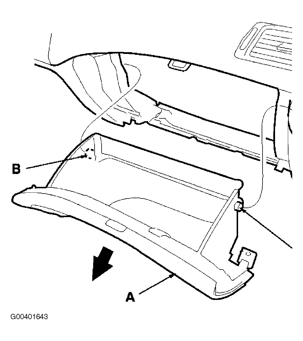

Open the glove box. Remove the glove box stop (B) on each side, then let the glove box hang down. See Fig 3.
Fig 3: Locating Glove Box Stops

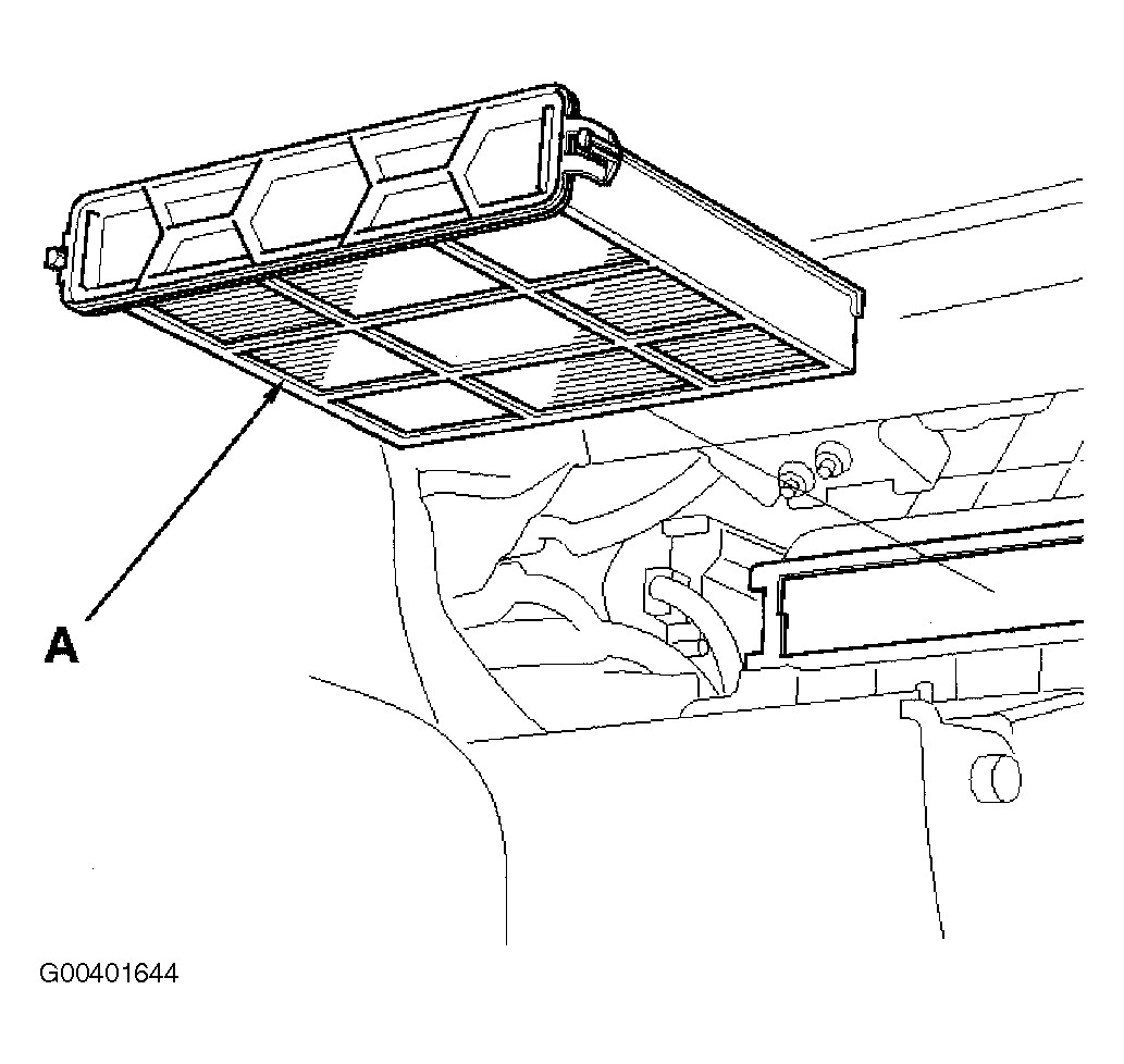

Remove the dust and pollen filter assembly (A) from the evaporator. See Fig 4.
Fig 4: Dust & Pollen Filter
