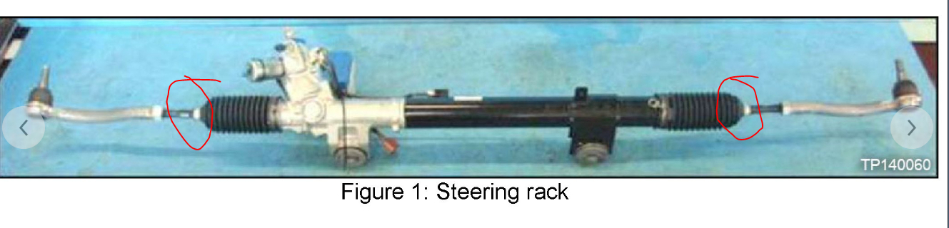

Also, take a look at the pic below. I circled the ends of two rubber dust covers. Check to see if anything is wet there with power steering fluid.

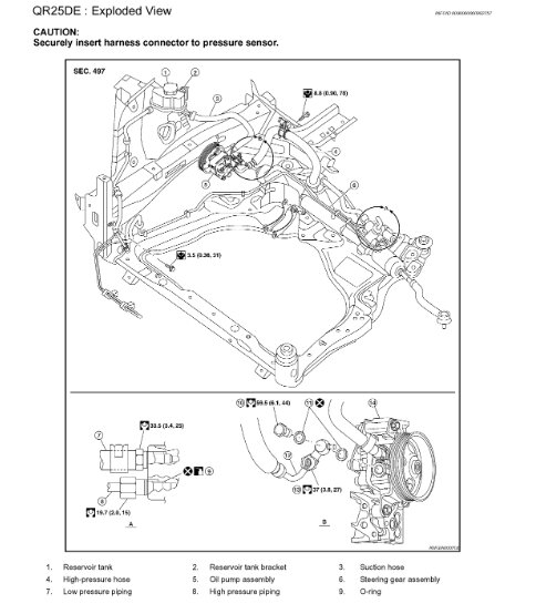

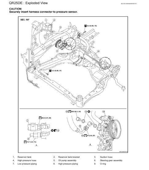

Let me know. Also, if you haven't, you may want to service the PS pump and system.
Here is a link that explains how to do it:
https://www.2carpros.com/articles/power-steering-fluid-flush

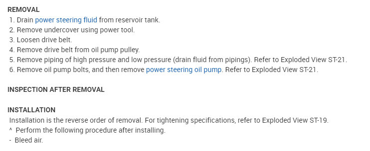

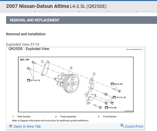

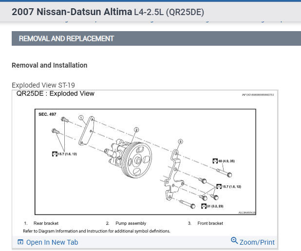

Thanks for the update. I don't know if you plan to replace it yourself. If you do, I attached the directions below. Hopefully, they will help.
Take care and let me know how things turn out for you.
