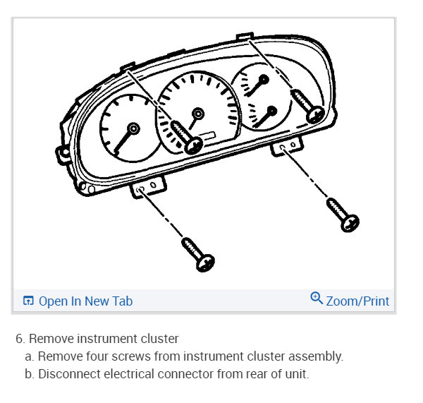

when I drive a beeping noise goes off (sounds like when you leave the keys in the ignition and the door open).The only time it seems to stop is when I apply the brake. I checked the fuses there all good. When the mechanic went to check it , it didn't beep.
Mar 20, 2016 at 6:05 PM
CJ MEDEVAC
  • 11,004 POSTS

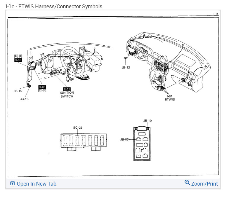

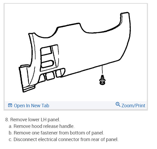

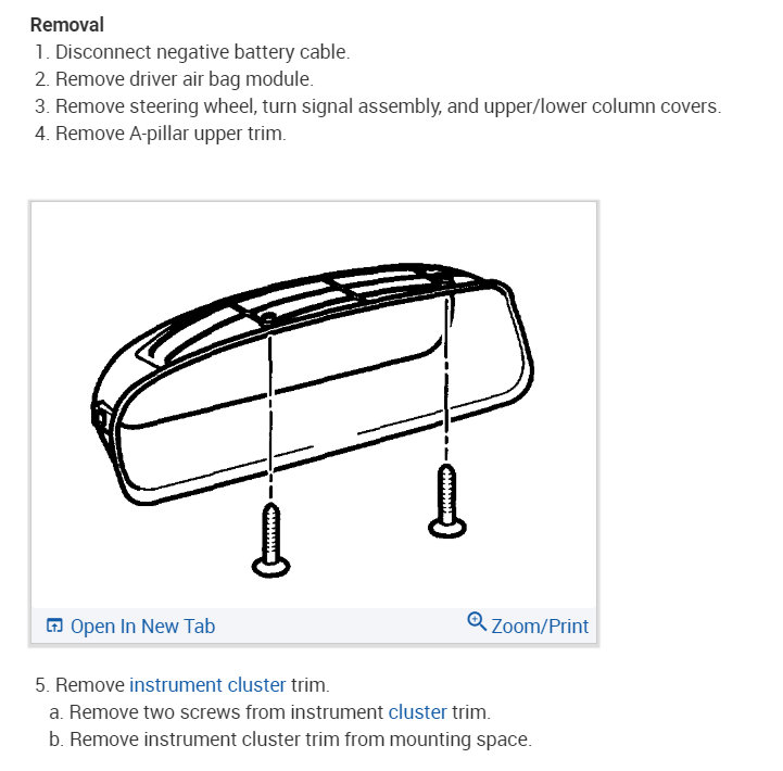

This sounds like the cluster or ETWIS module (electronic time and warning systems module) is out here are diagrams to help you see whats going on. The ETWIS module is below the instrument cluster. Check out the diagrams (Below). Please let us know what you find. We are interested to see what it is.
