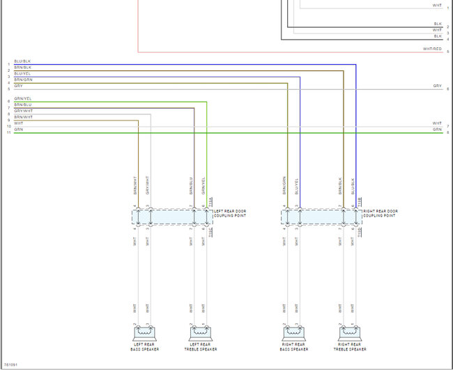

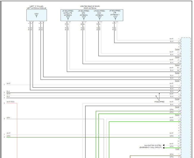

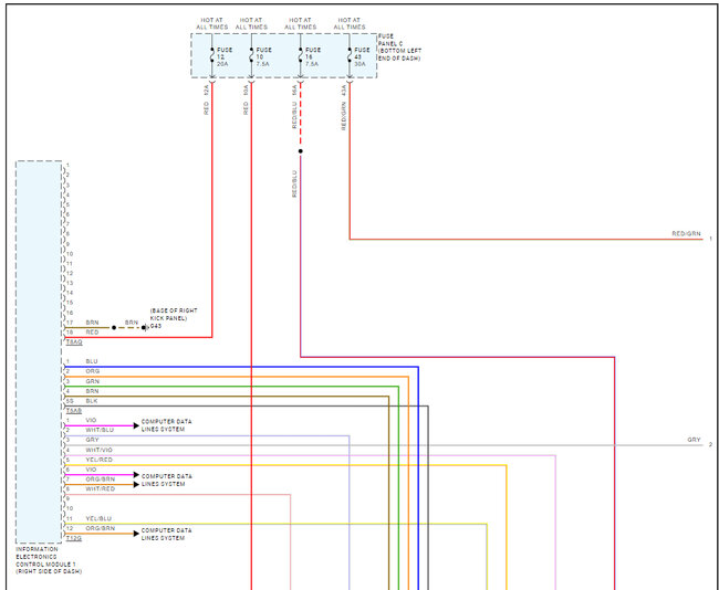

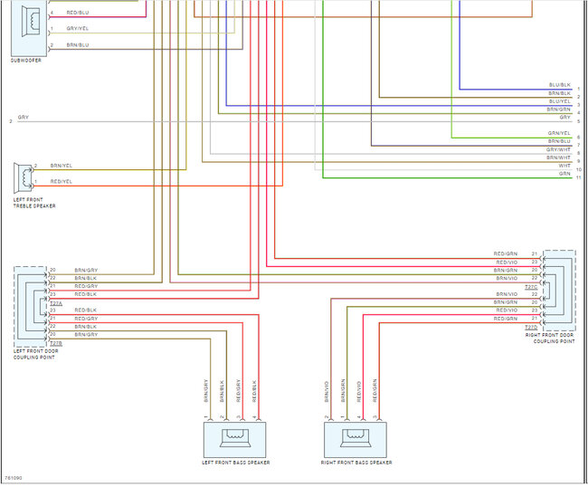

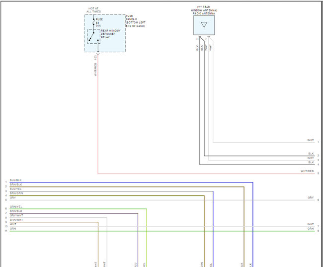

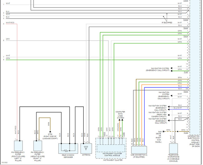

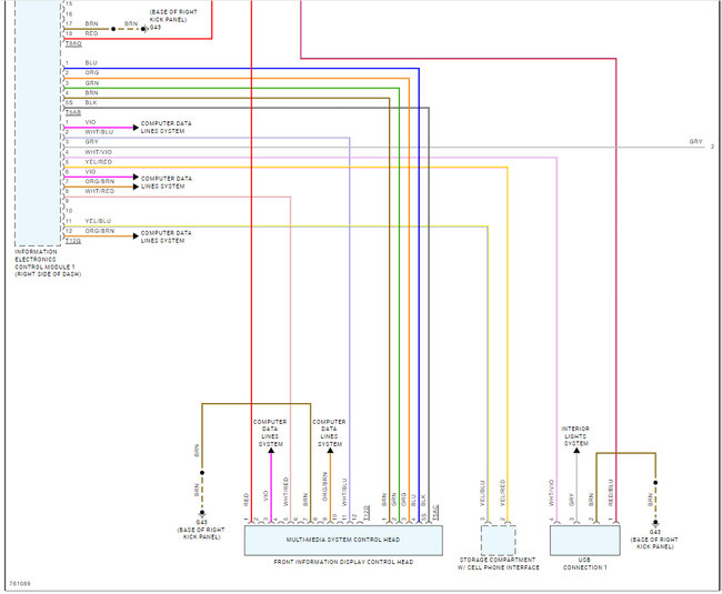

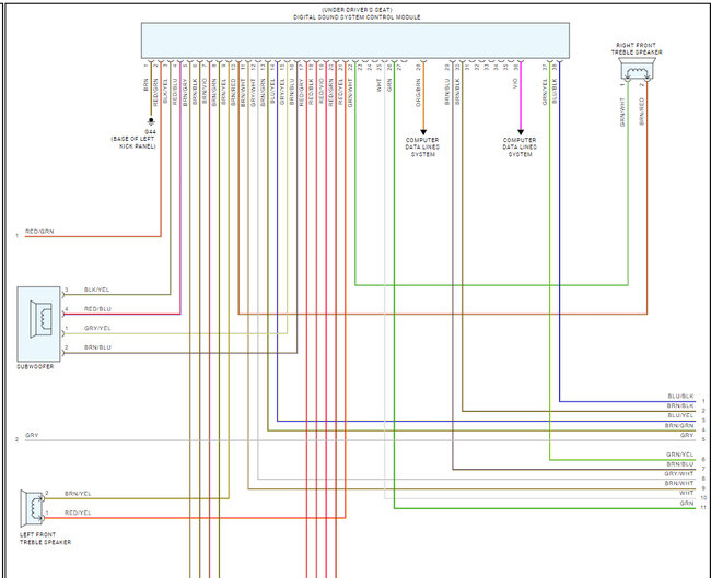

I'm trying to wire up some speakers and need the wiring diagram. The front door speakers have four wires connected to them instead of two. I'm also hoping to use the inputs to the factory amp (mounted under the driver seat) to send clean signal to a mono amp to run a better sub.
Thank you!
Sep 21, 2024 at 2:23 AM
  • 55,691 POSTS
Yep, no problem, here are the radio and amplifier wiring diagrams. Check out the images (below). Let us know if you need anything else.

This is exactly what I needed. Thank you for the help!
