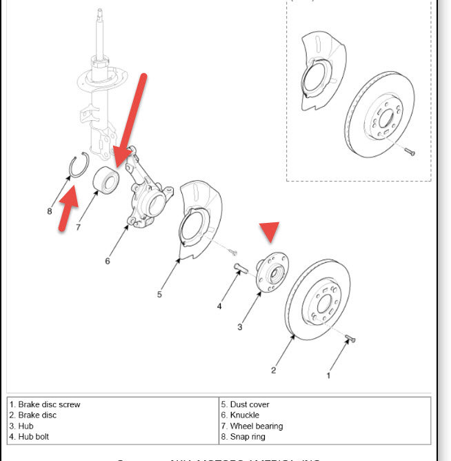

How to remove the bearing hub on the right passenger side of my vehicle?

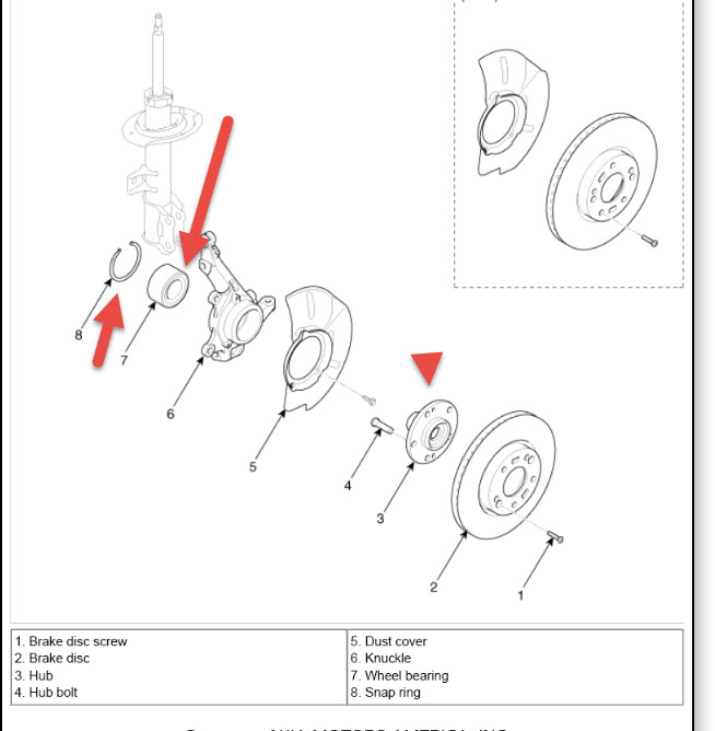

too much for us to copy and paste, but best thing here is to pull off knuckle and take to auto parts with brakes off so bearing can be pressed out. front end will need alignment after doing this regardless of who does it. manual can be rented for a week and you can print out whatever you need . see picture for location of bearing.
