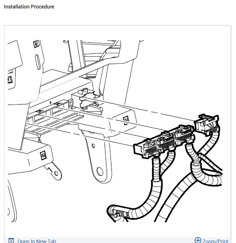

How to remove and install the BCM?
2009 VAUXHALL ZAFIRA
138,000 MILES • 1.2L • 2WD • MANUAL
WAZNO1

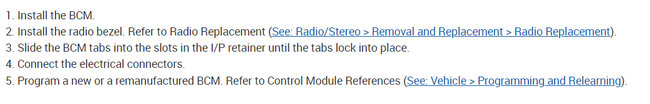

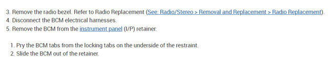

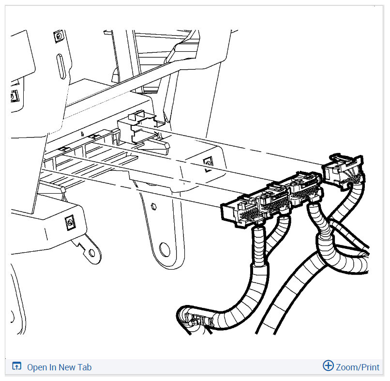

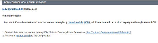

I have to remove the BCU from my vehicle listed above and refit the new coded one. How do I do this? What do I disconnect first on the battery and unit please?
Dec 20, 2023 at 5:31 AM
  • 55,433 POSTS
Here are the instructions on how to replace the BCM with a generic guide to help walk you through the steps. Also, we don't have this vehicle in the states, but I think I found the correct application. Please let me know if this doesn't work for you.
https://www.2carpros.com/articles/how-to-replace-a-bcm-body-control-module
You can get a preprogrammed unit by searching Google or Ebay. Check out the images (below). Please let us know what happens.
Dec 21, 2023 at 8:58 AM
