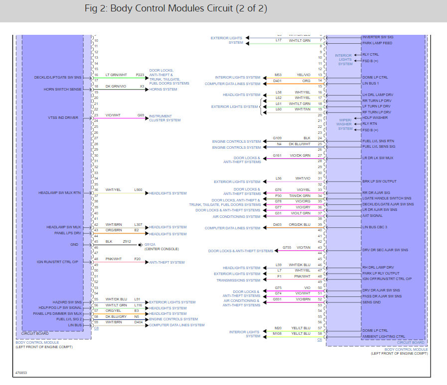

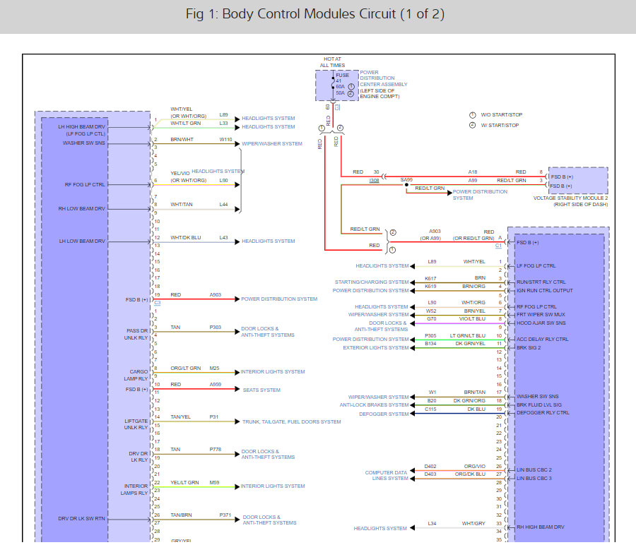

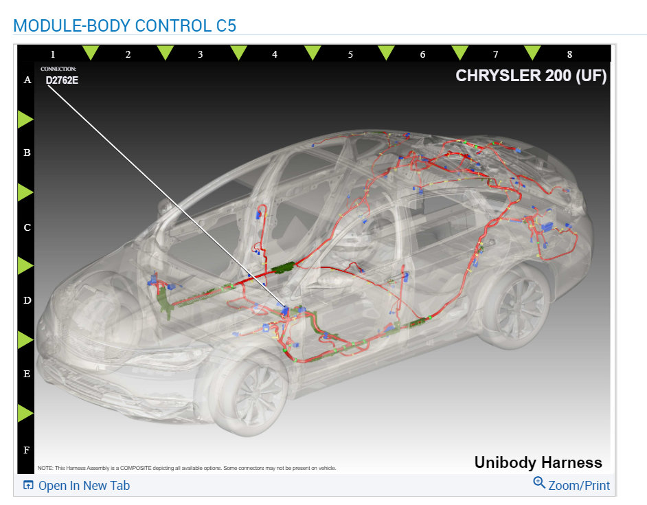

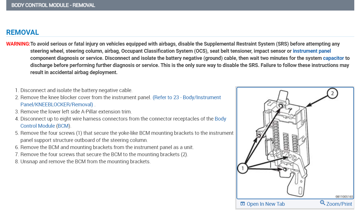

Hello. I need BCM location and wiring diagram. I want to add remote start and I need to add hood ajar switch.

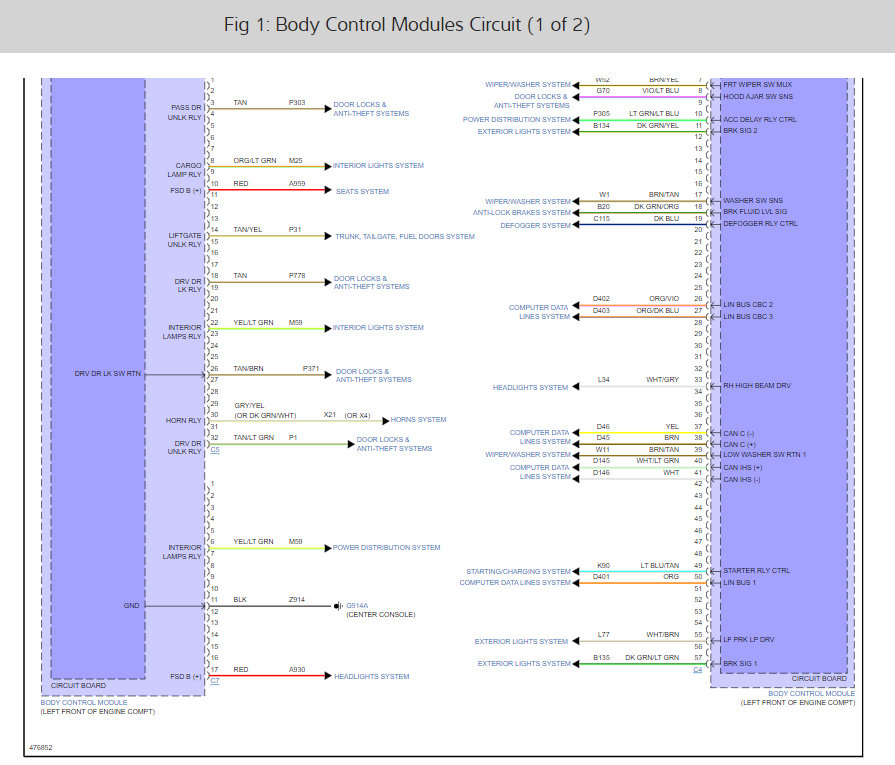

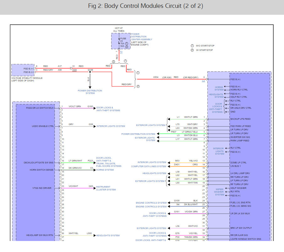

Here are the BCM wiring diagrams in the images below and the BCM location as well, let me know if you need anything else.

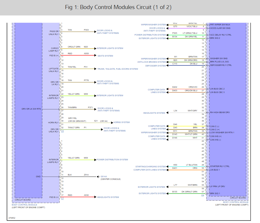

Hello. Can you tell me, please, what type of pin do I need to plug in with wire, to the BCM module? I'm trying to add hood ajar.

The BCM wire that control this warning the Vio/lt-blue pin #8. Let me know how it goes.
