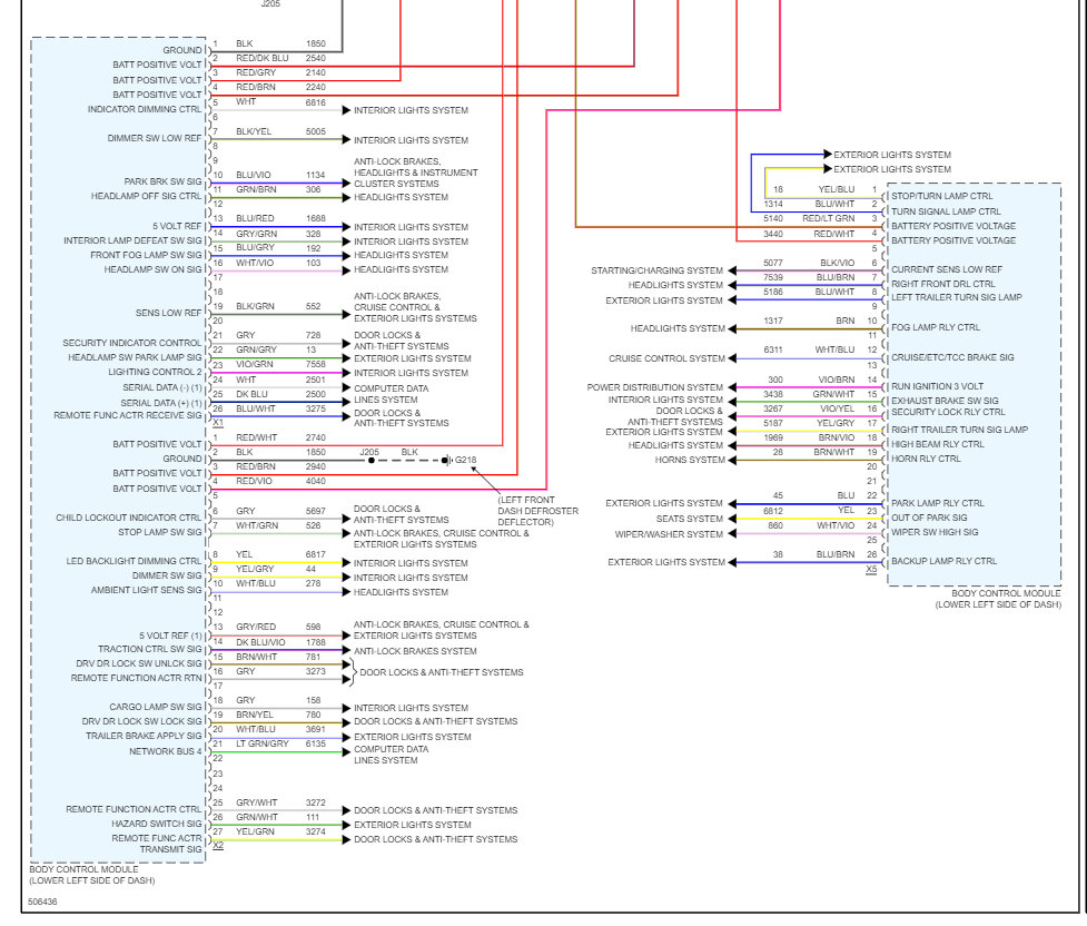

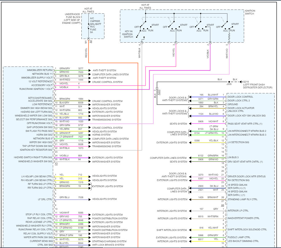

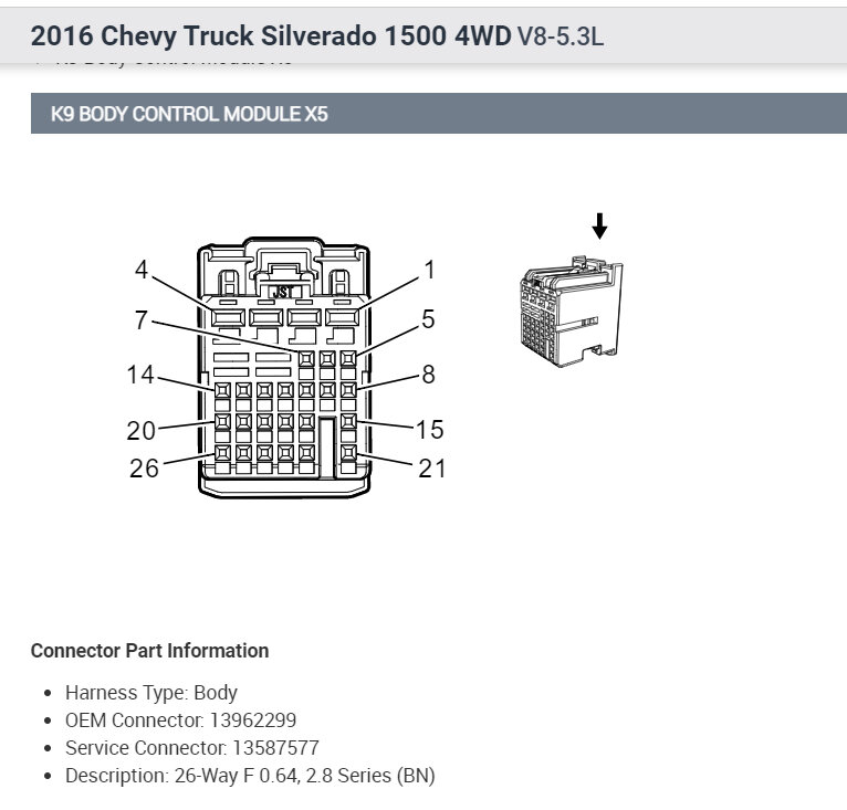

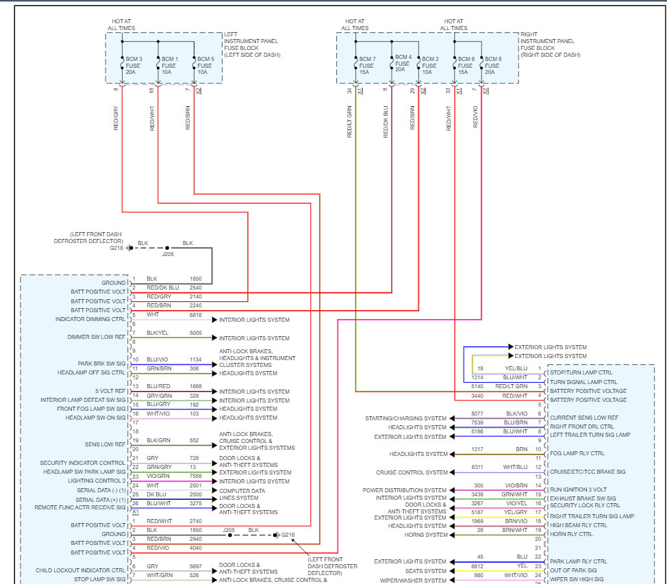

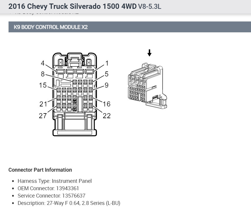

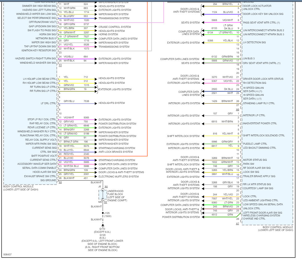

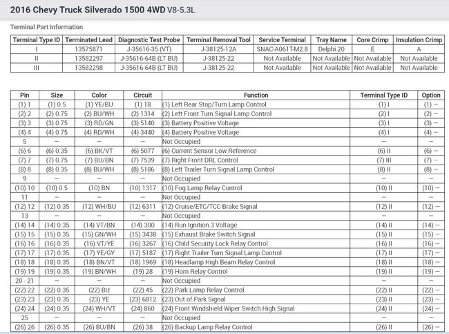

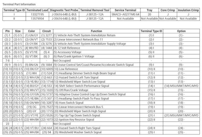

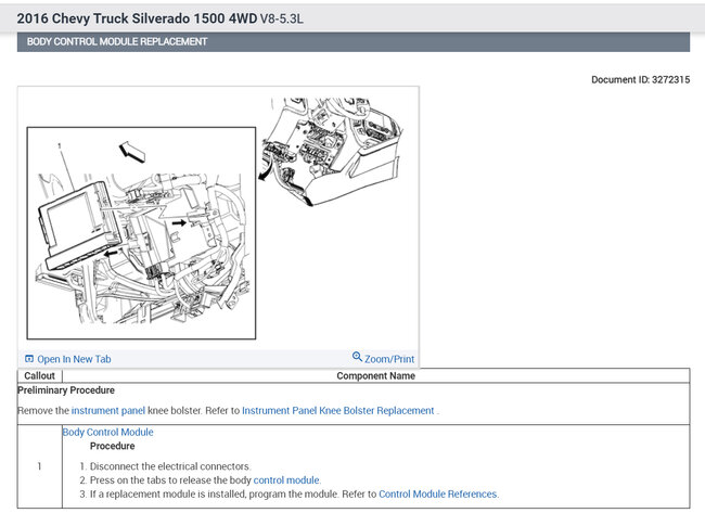

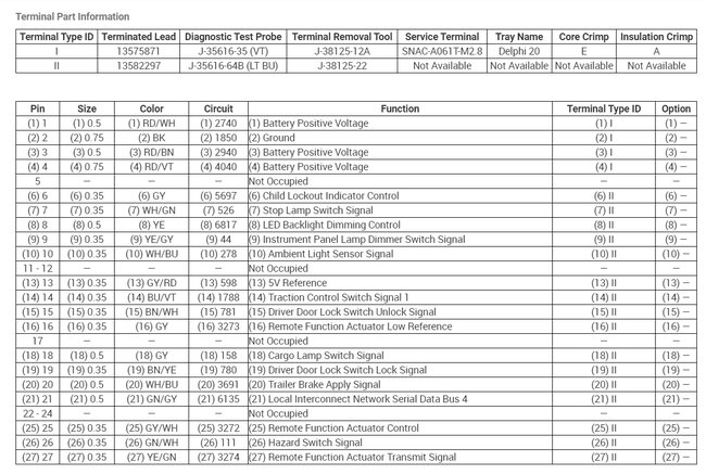

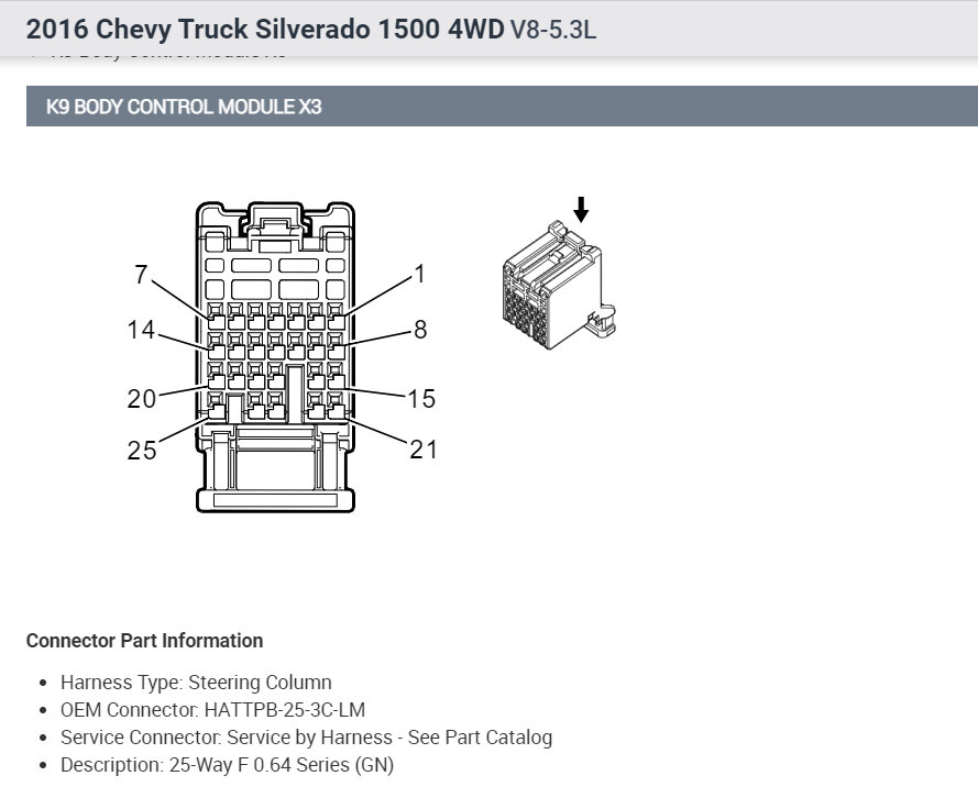

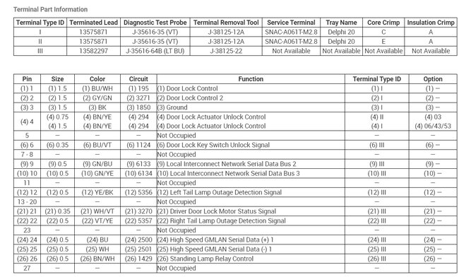

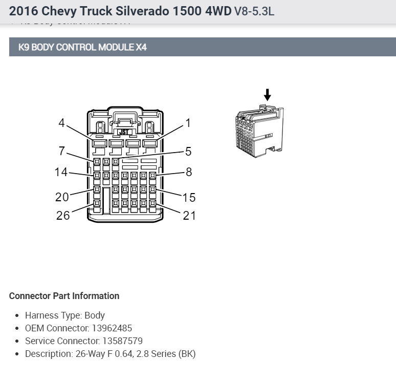

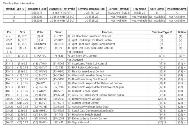

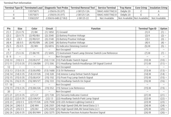

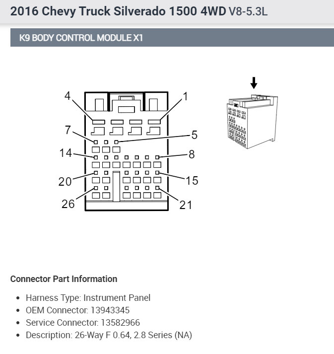

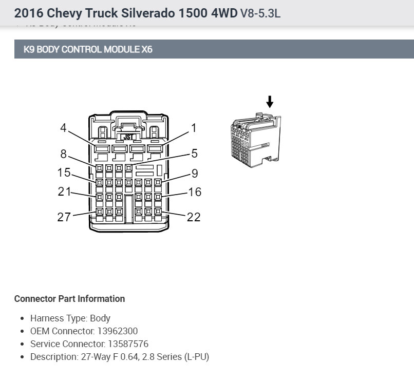

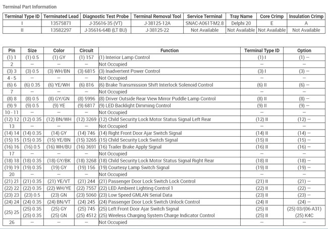

I need to tap into the back lighting for adding fog and drive light switches and would like to know what connector the yellow wire is at for the tap.
Feb 19, 2023 at 8:24 PM
  • 55,732 POSTS
Here is the pin out diagrams and terminal identification you have requested, also I have included the BCM location as well. please let us know if you need anything else. There are seven connectors, I have included the BCM wiring diagrams well.
