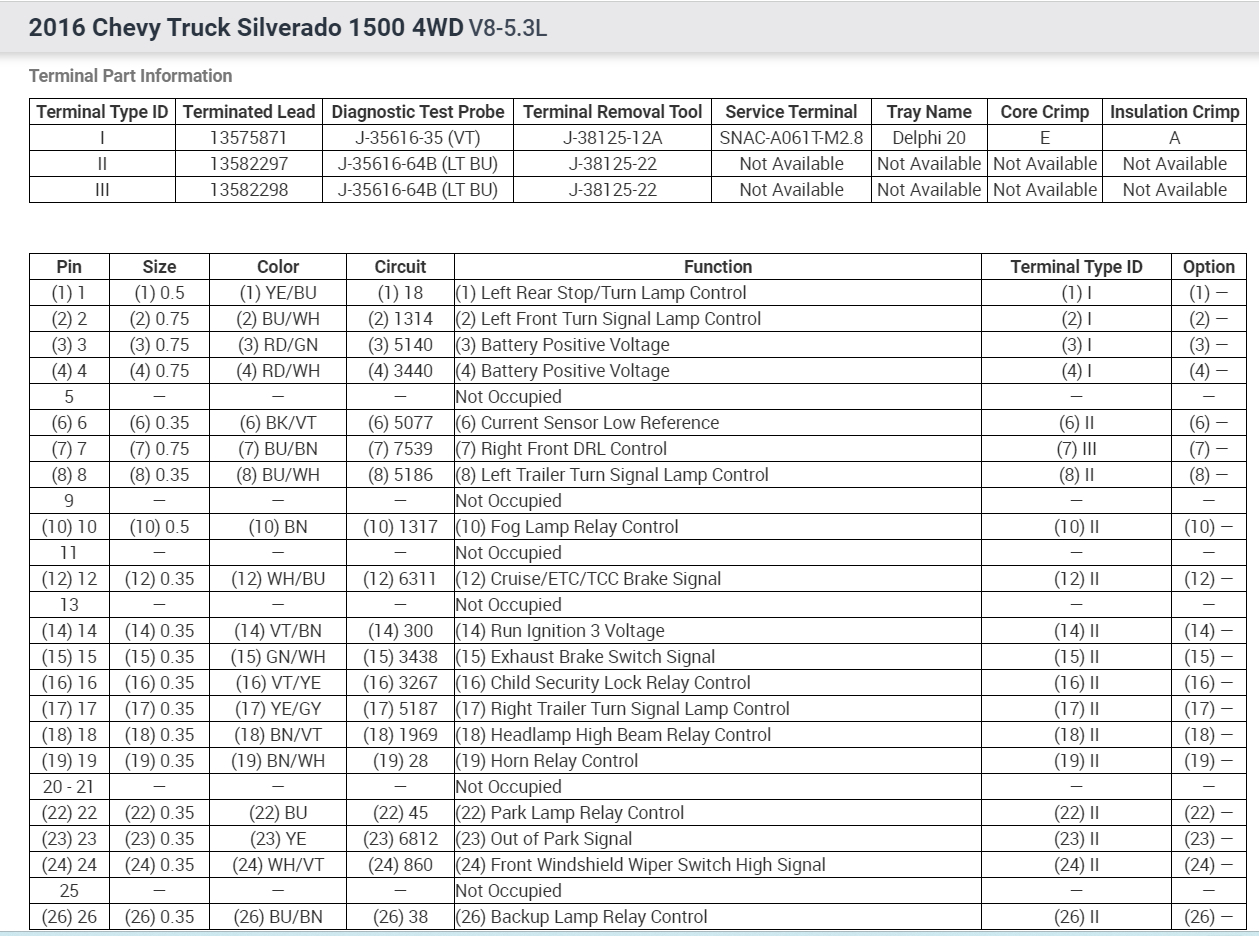

BCM Wiring Pin-out needed please?
2016 CHEVROLET SILVERADO
150,000 MILES • 5.3L • V8 • 4WD • AUTOMATIC
GCSMASTER

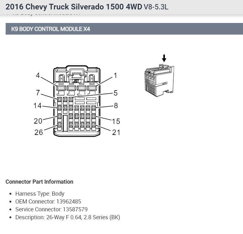

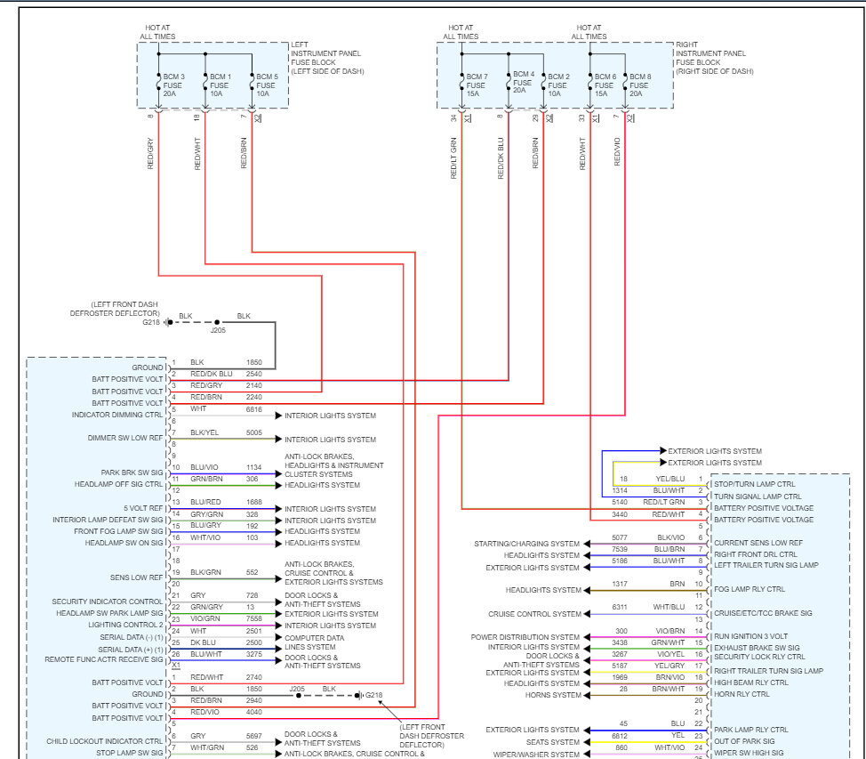

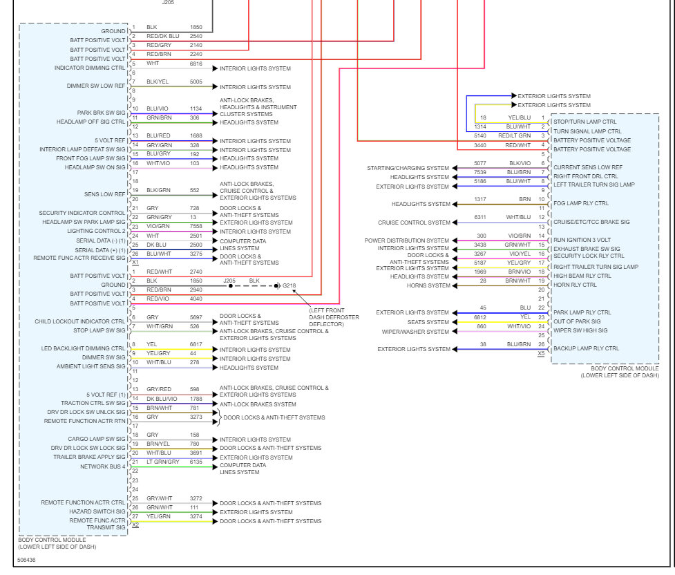

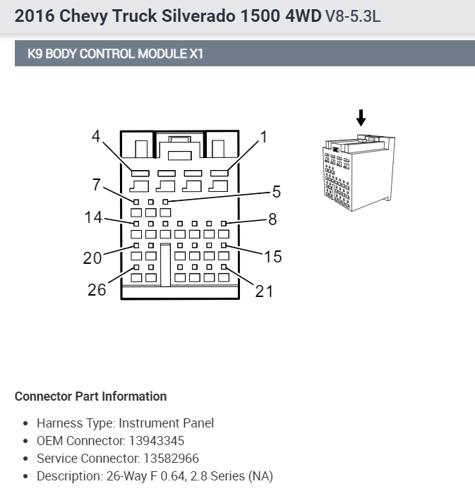

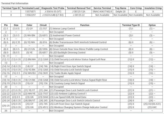

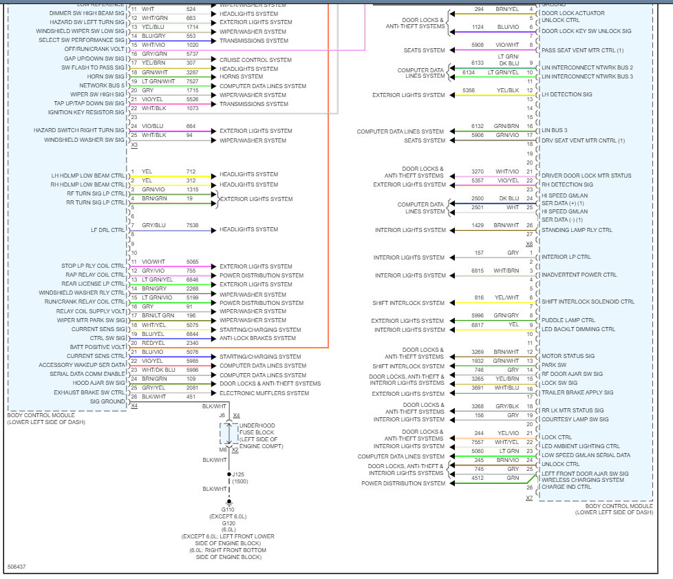

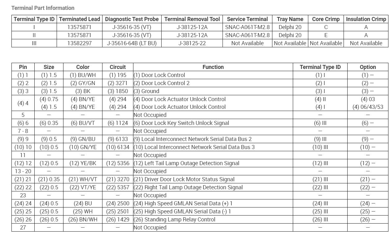

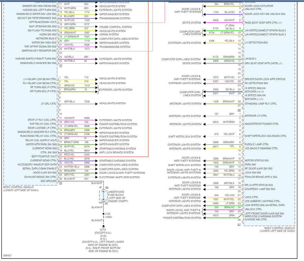

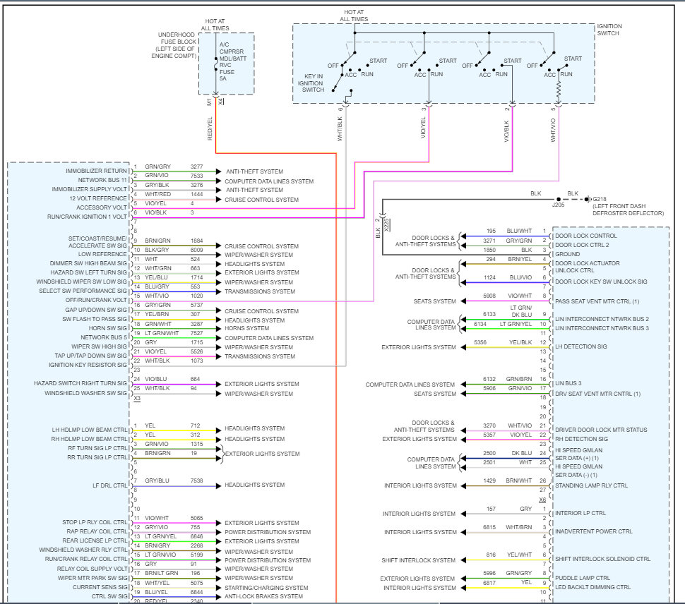

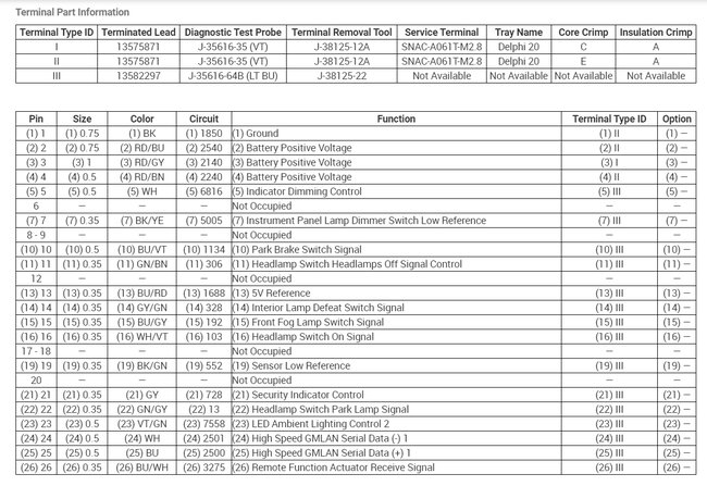

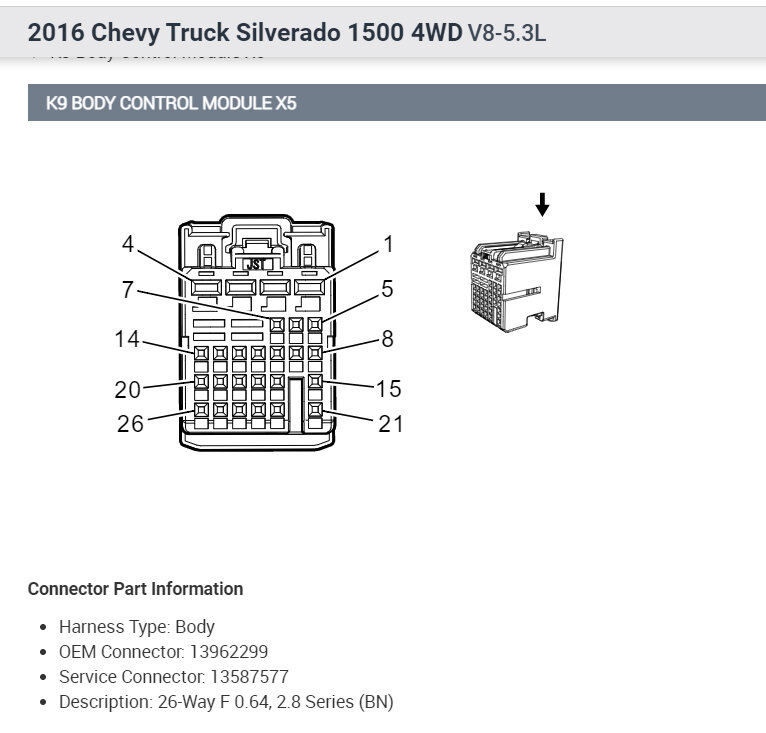

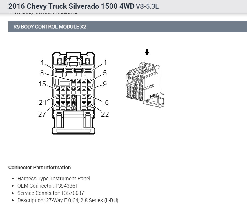

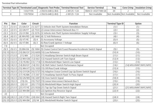

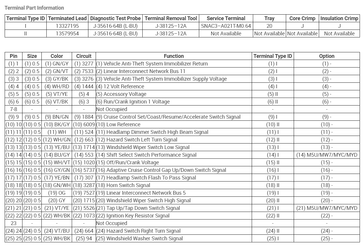

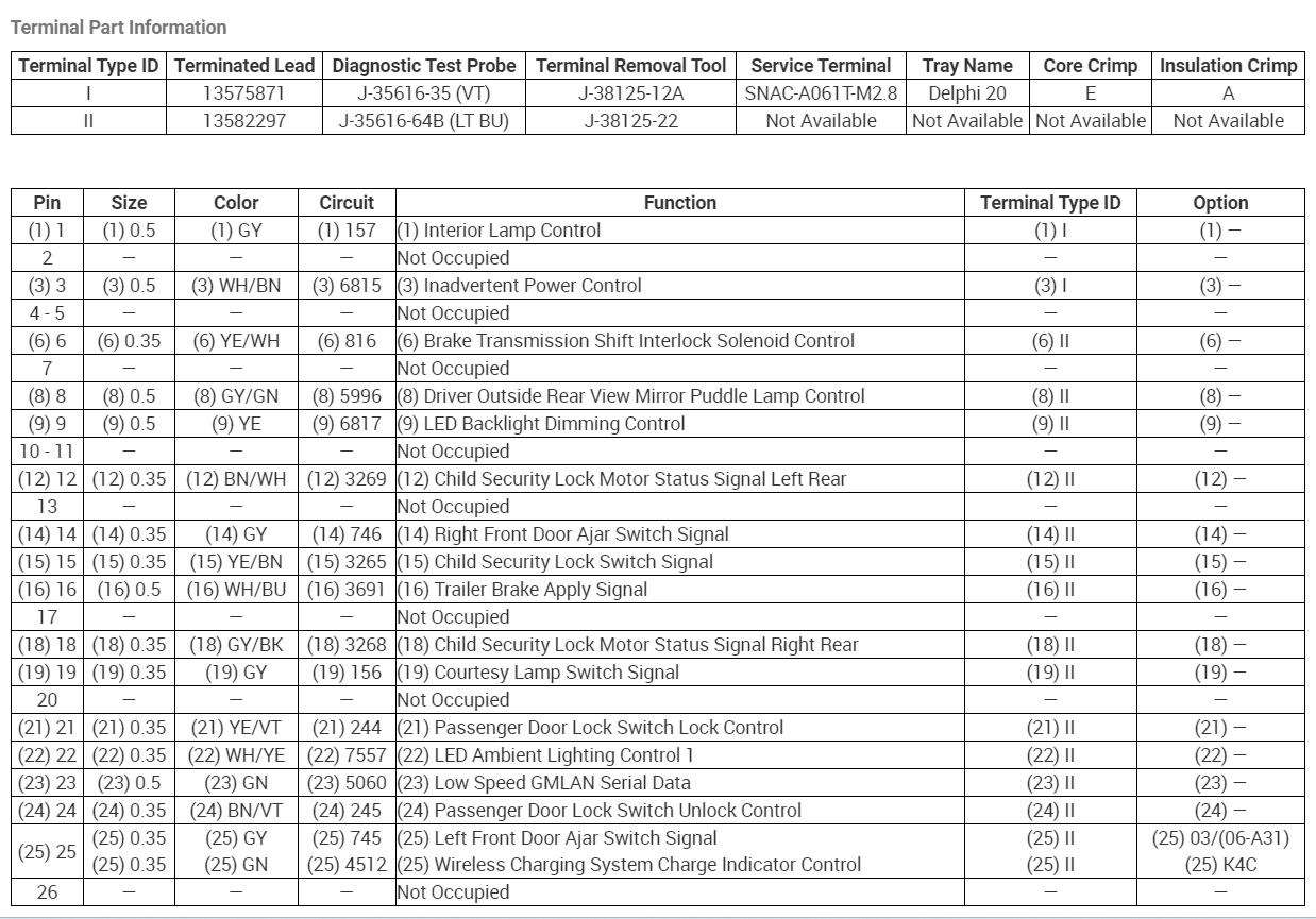

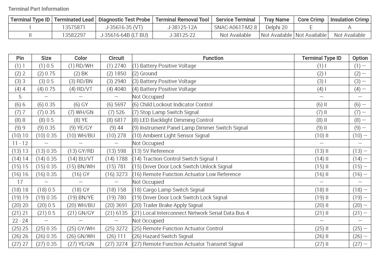

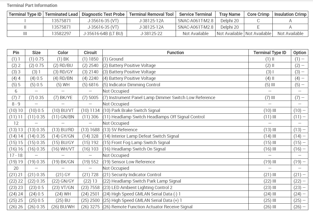

I need to tap into the back lighting for adding fog and drive light switches and would like to know what connector the yellow wire is at for the tap.
Feb 19, 2023 at 8:24 PM
  • 55,051 POSTS

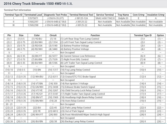

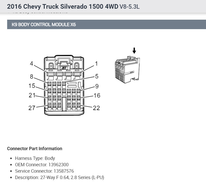

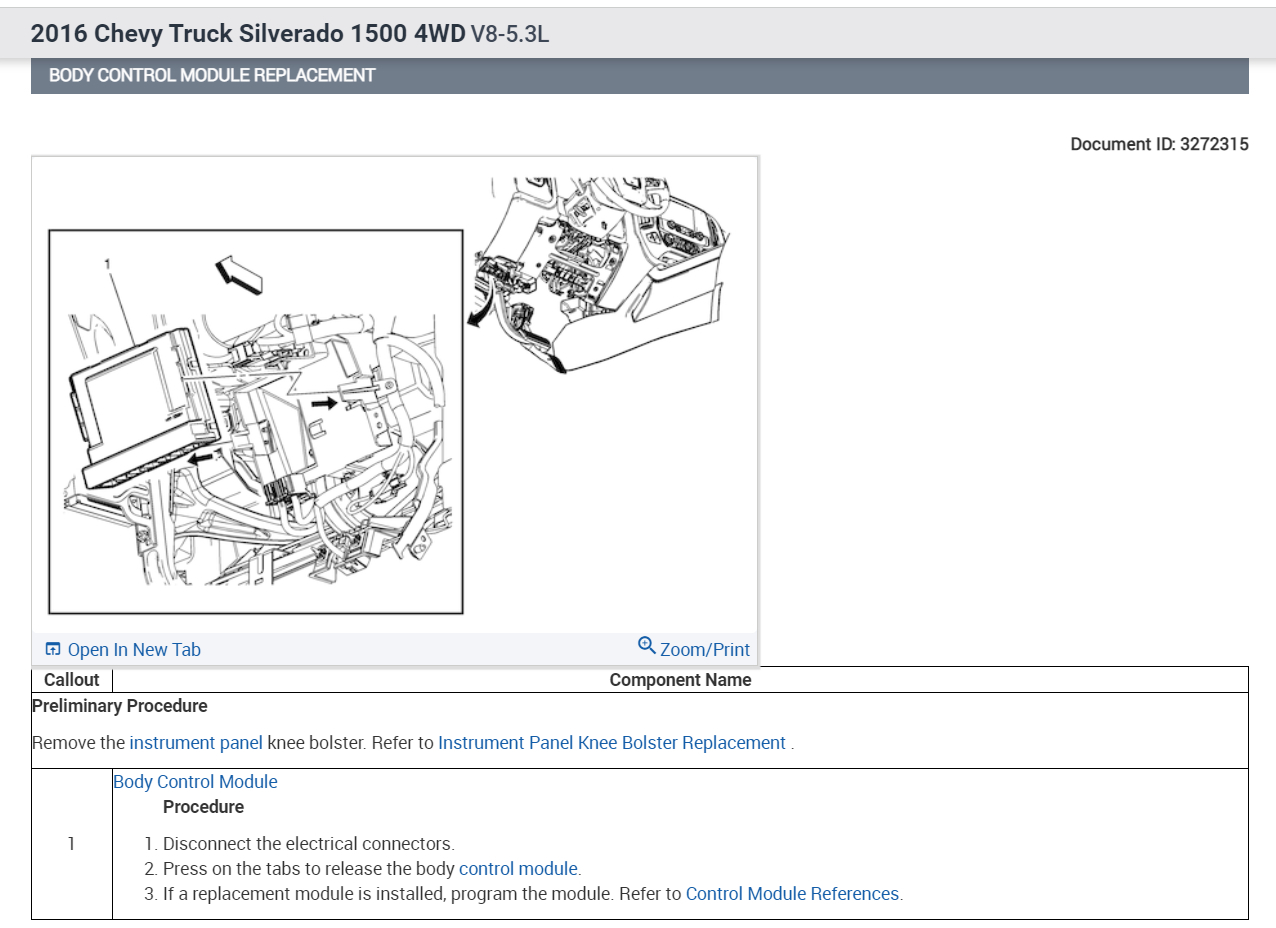

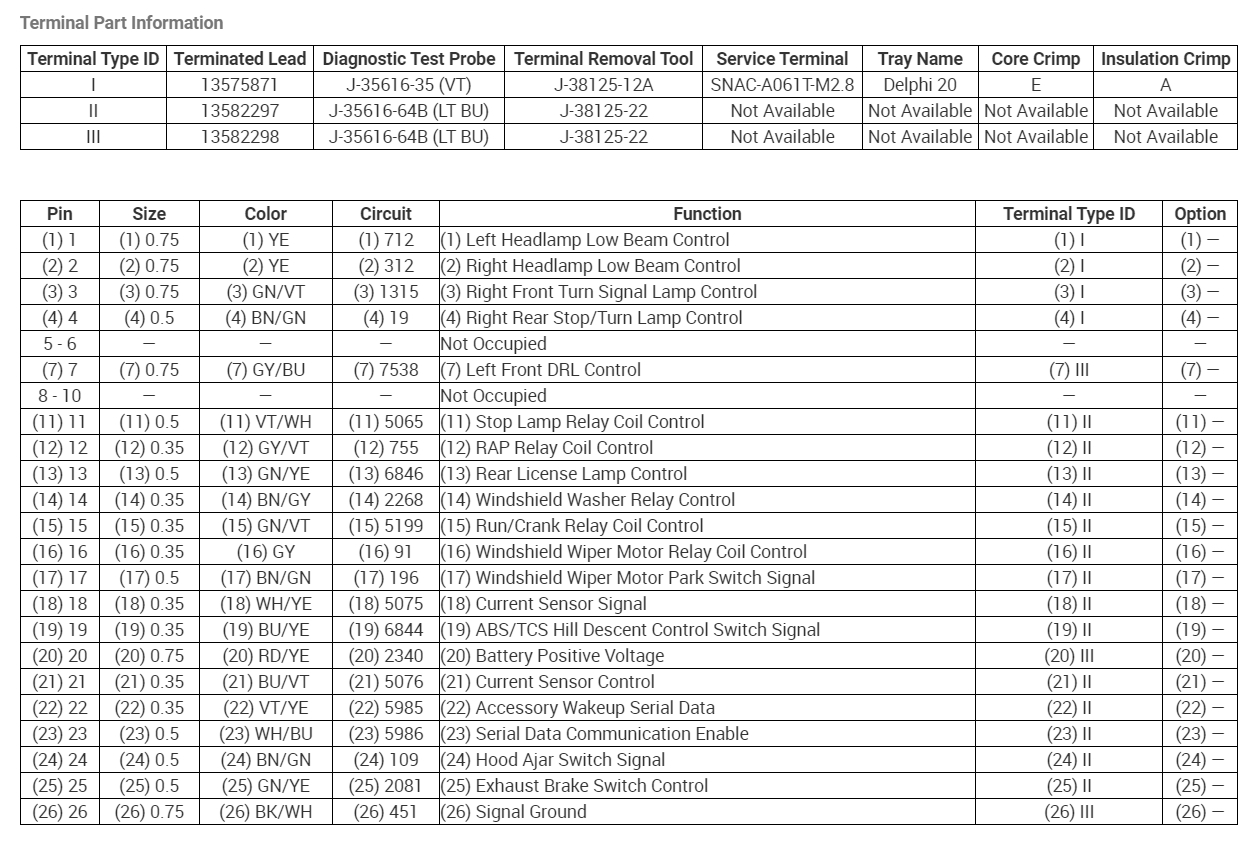

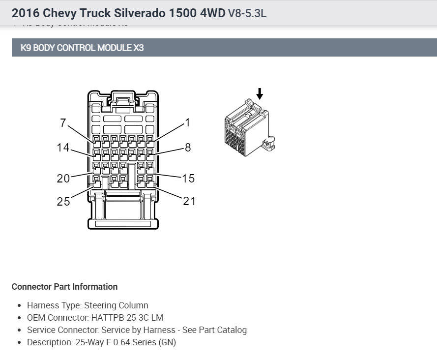

Here is the pin out diagrams and terminal identification you have requested, also I have included the BCM location as well. please let us know if you need anything else. There are seven connectors, I have included the BCM wiring diagrams well.
Feb 20, 2023 at 4:15 AM
GCSMASTER
Thank you very much, this helps out greatly.
