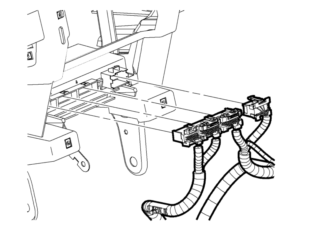

I have bought the car listed above v6. it has a bad BCM 1. GM tech said if i buy my a used one it would have to be reprogrammed. then another GM tech said it's not possible to reprogram. then another told me as long as the part number matched i can use it or as long as it has the same options.

You need a new BCM and yes, it must be programmed to your car. The other two guys are incorrect...................
Oct 10, 2019 at 1:29 PM
I attached the procedure for you and the programming procedure for you to follow.
Let me know if you have any other questions.
BODY CONTROL MODULE REPLACEMENT
REMOVAL PROCEDURE
IMPORTANT: Service programming is required when replacing the BCM. Refer to "Saturn Service Stall" user's guide.
1. Remove the radio bezel.
2. Disconnect the body control module (BCM) electrical harnesses.
3. Remove the BCM from the I/P retainer:
1. Pry the BCM tabs from the locking tabs on the underside of the restraint.
2. Slide the BCM out of the retainer.
INSTALLATION PROCEDURE
1. Install the BCM.
2. Install the radio bezel.
3. Slide the BCM tabs into the slots in the I/P retainer until the tabs lock into place.
4. Connect the electrical connectors.
5. Program a new or a remanufactured BCM. Refer to Body Control Module (BCM) Programming/RPO Configuration. See: Vehicle > Programming and Relearning
