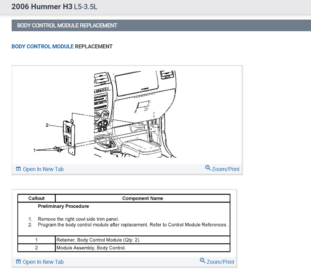

Can I replace the BCM in the vehicle listed above myself? I have ordered a replacement off eBay.
Mar 20, 2023 at 4:16 AM
  • 55,447 POSTS

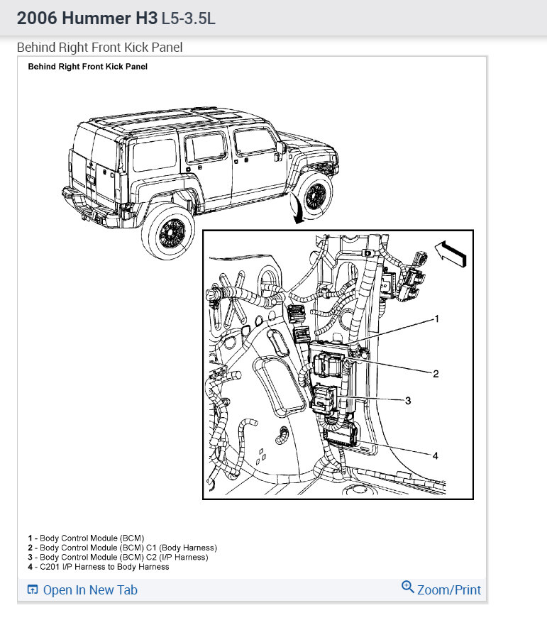

Yep, you sure can I assume the BCM you ordered is preprogrammed? If so, you are good to go. Here are the instructions on how to replace the BCM and its location in the images below. Please let us know if you need anything else to get the problem fixed.

It is from a Chevy Colorado. Will that still work for my Hummer H3?
Mar 20, 2023 at 12:02 PM
  • 55,447 POSTS
If the part number is the same it will work.
