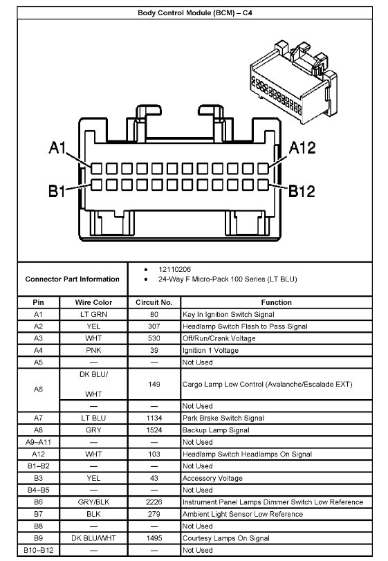

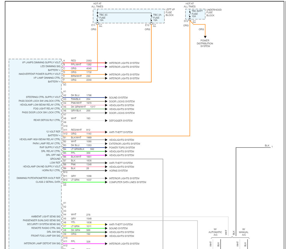

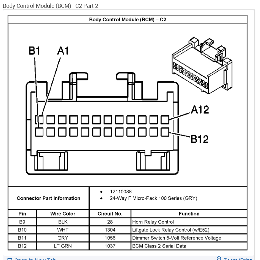

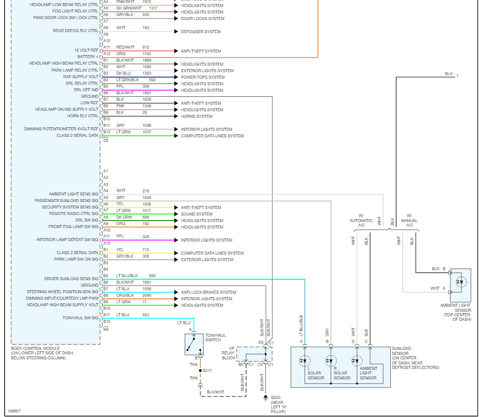

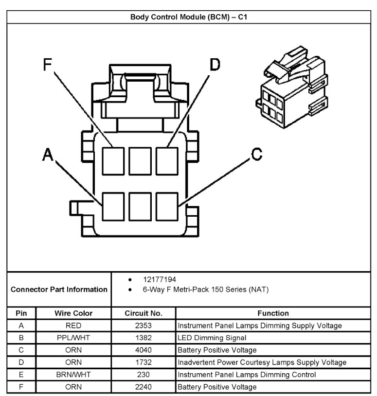

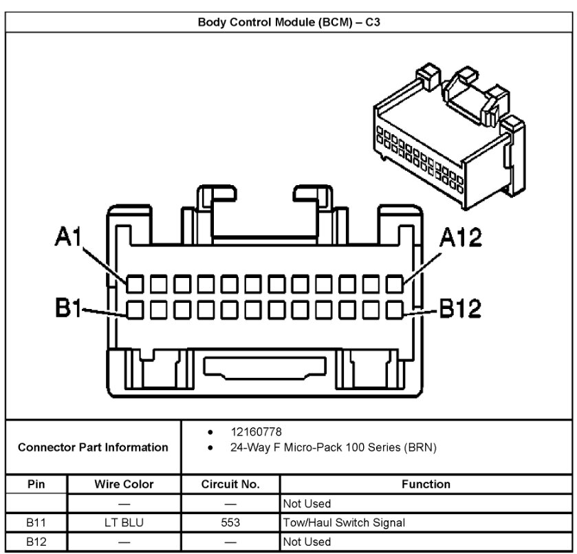

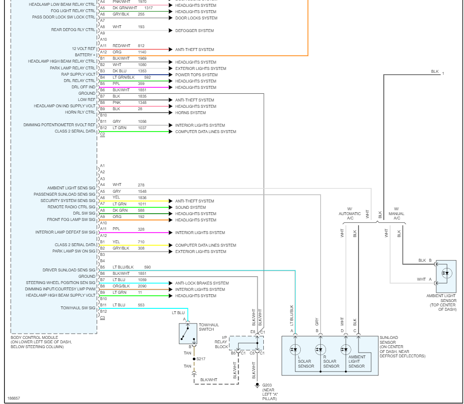

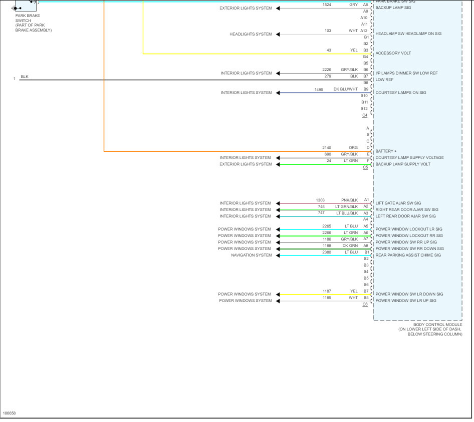

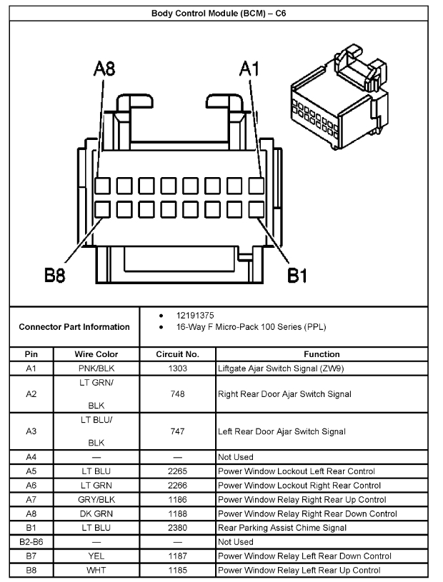

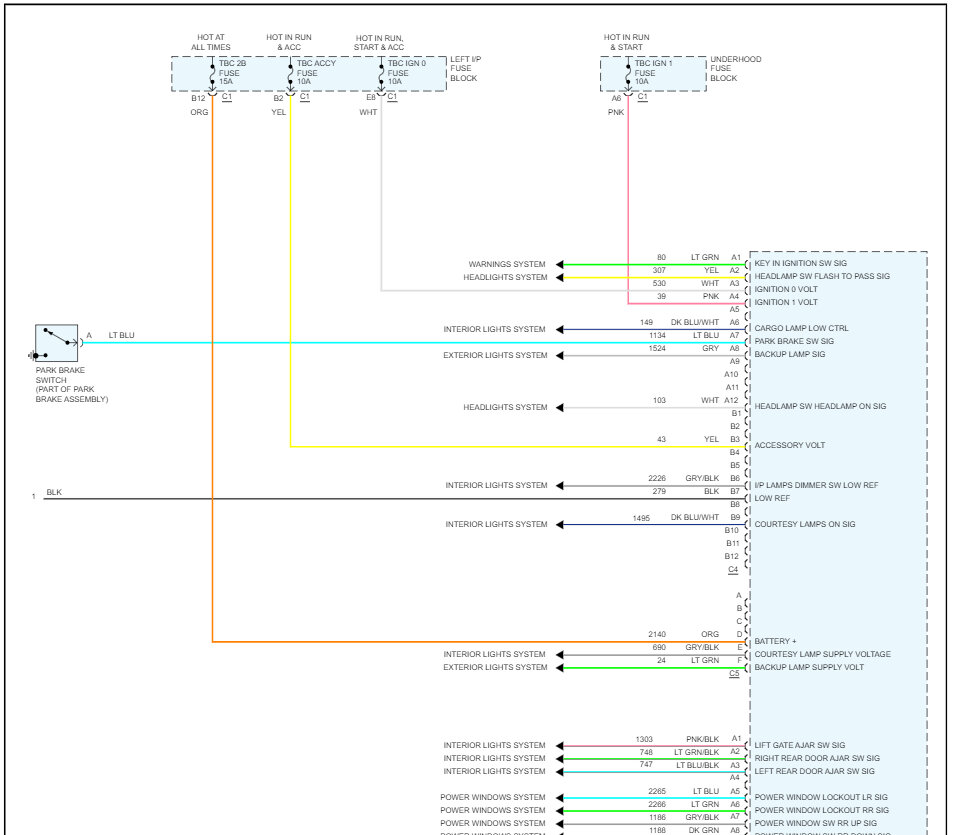

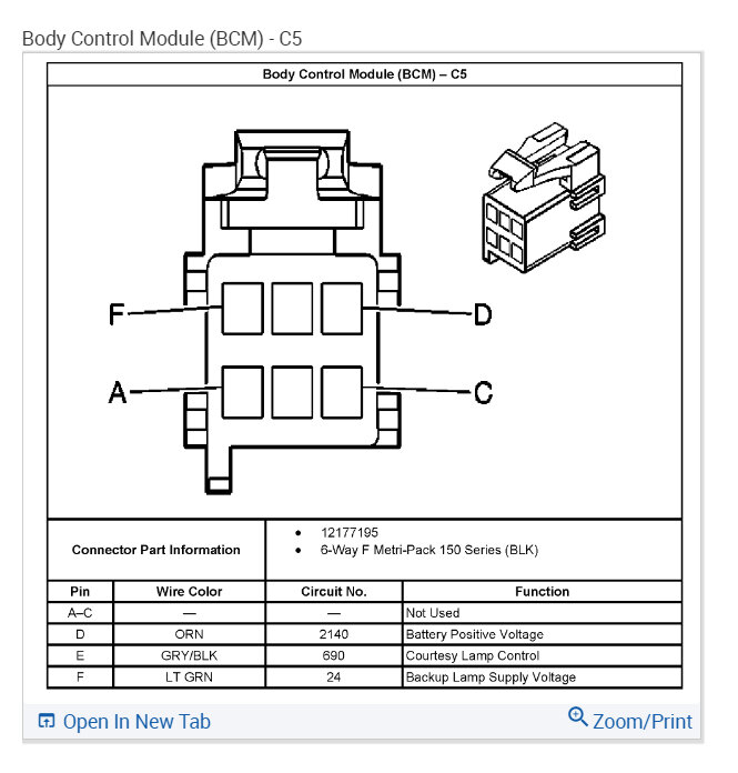

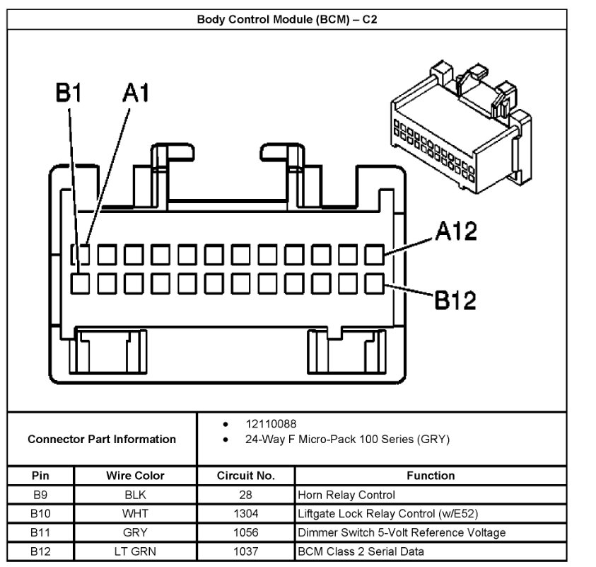

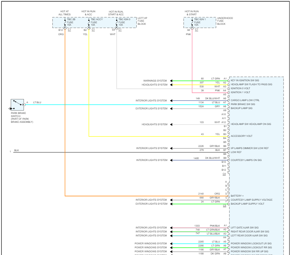

I did a complete interior swap on my 2004 Silverado base model with a 2004 Denali interior. I need to use my base model BCM, but when I do my gauge cluster lights will not turn off. When I use the Yukon BCM I get a lift gate error because the wiring for it has been removed. I would like to get a pin out for the BCM for the Yukon so I can compare it to the pin out for the Silverado at the porting that controls the IP lighting.
Jul 26, 2023 at 6:40 AM
  • 55,051 POSTS
Sure, here is the BCM pinout and the BCM wiring diagrams. I have also included a guide to help you test the connections.
Check out the images (below). Please let us know if you need anything else to get the problem fixed.

Is the pin out the same for the 2004 Silverado single cab base model BCM?

Maybe, if you would like that information as well please start a new question.
