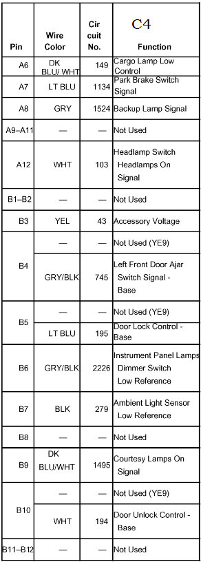

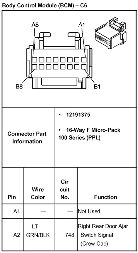

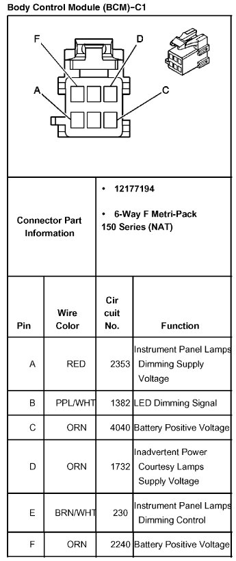

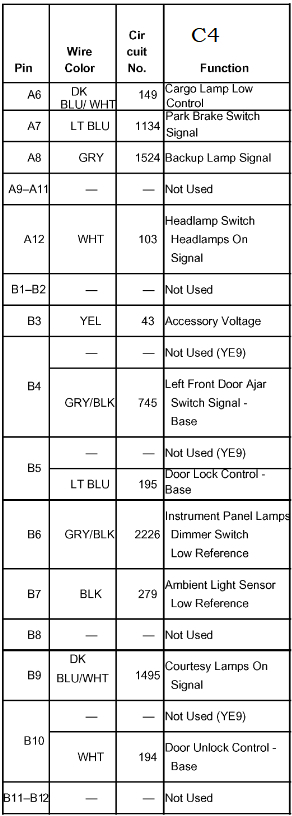

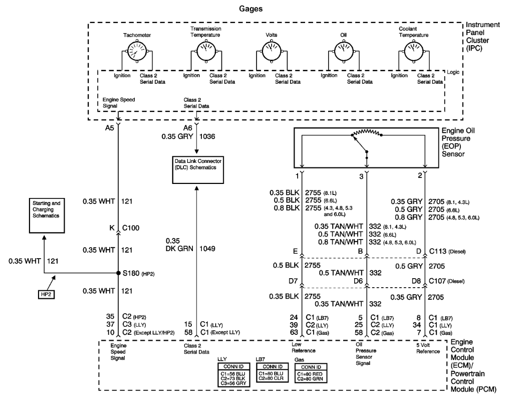

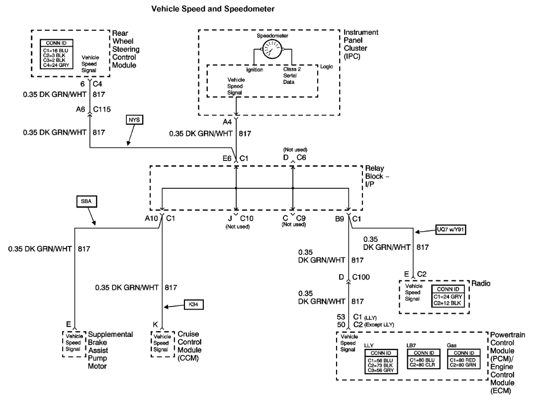

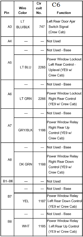

Is the pin out for the truck listed above single cab base model BCM the same as the 2004 Yukon Denali BCM? I have the Denali pin out, but I do not have the Silverado pin out. I am mainly interested in the plug that controls the instrument panel lights. Thank you in advance.
Jul 29, 2023 at 11:03 PM
AL514
  • 5,675 POSTS

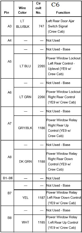

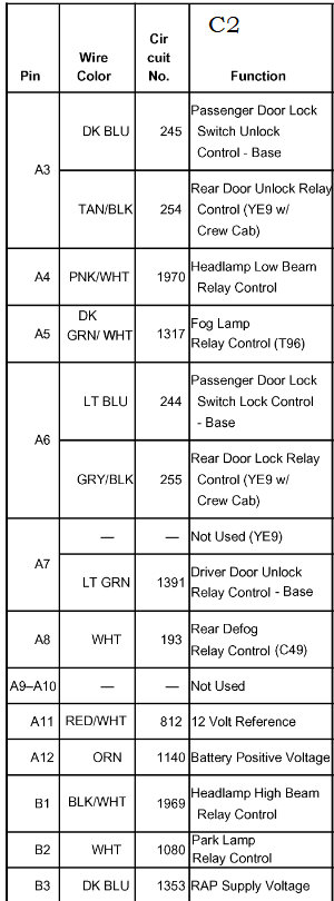

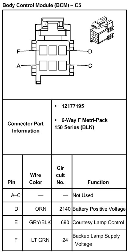

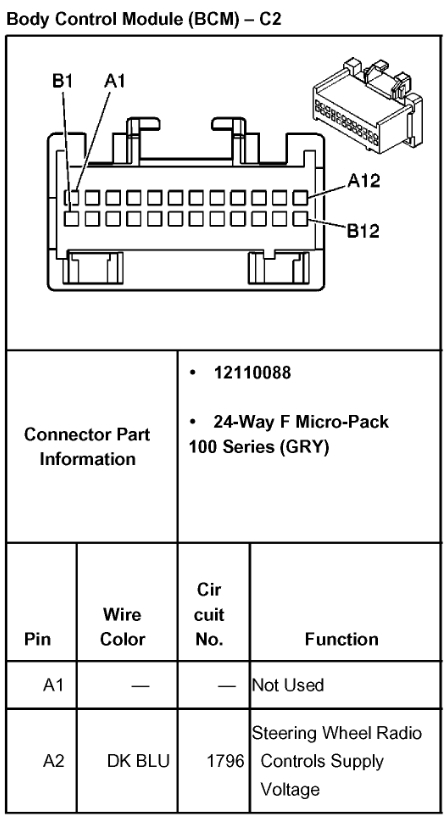

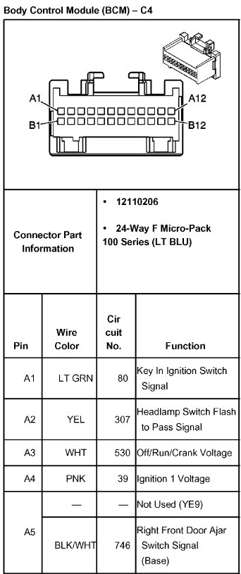

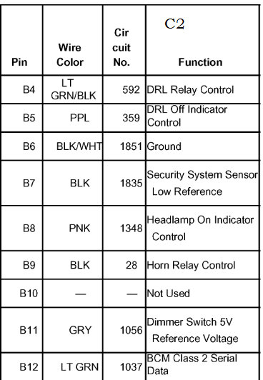

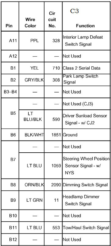

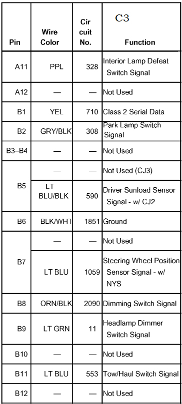

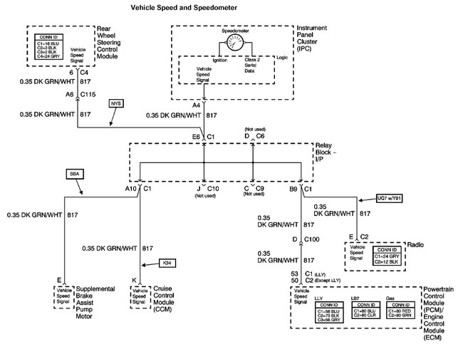

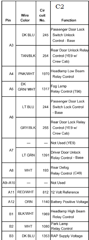

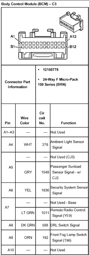

Hello, there looks to only be one BCM setup for that year, with 6 harness connectors. I'll post all of them for you.
These are all the BCM connectors, each one is labelled at the top. It looks like they should all be different colors as well. You should be able to verify the connectors by wire colors and placement.

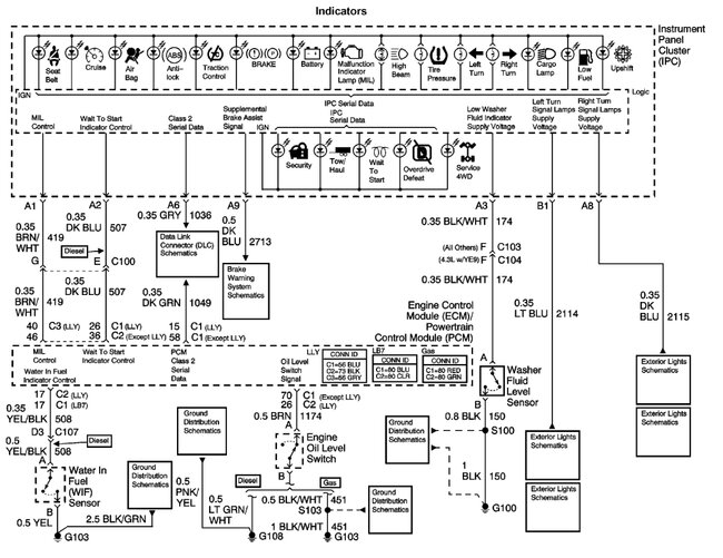

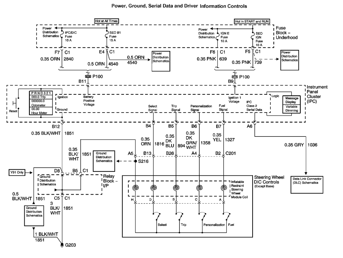

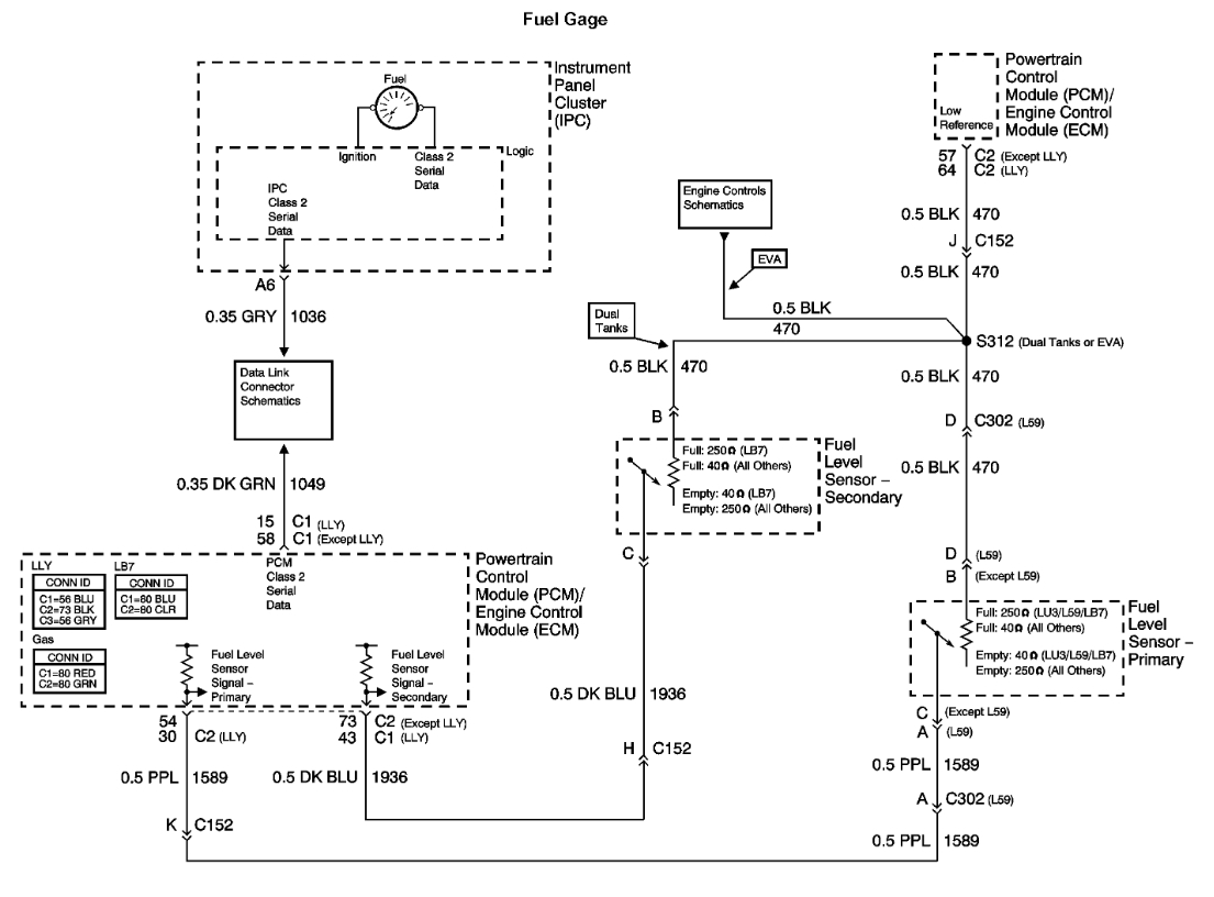

I added the OEM Cluster diagrams as well if needed.
