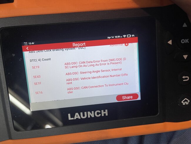

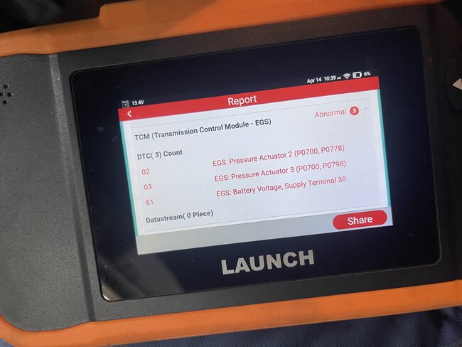

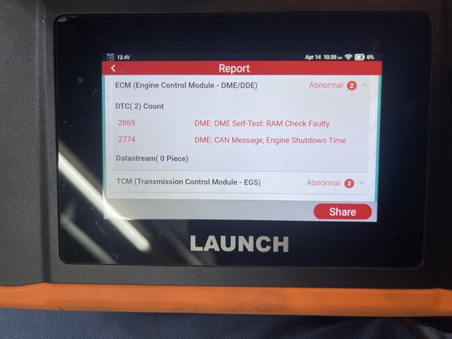

I stalled a new battery a d of course there were ton of codes due to low voltage. These were the codes before i deleted everything. I will post the codes if any after deleting all so you can see what is still there.

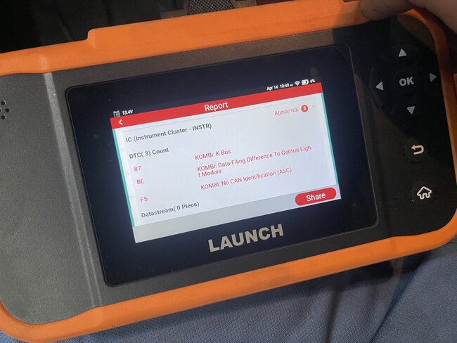

Failed to communicate with:
-Central information display
-Top module
-Light switching center

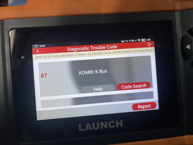

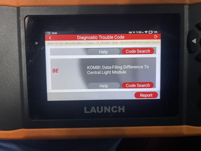

-Instrument cluster had 2 codes i cleared them and they deleted, a BE and a k bus
-radio
-airbag module
-SZM
-ZKE central body electronics
Apr 14, 2026 at 1:57 AM

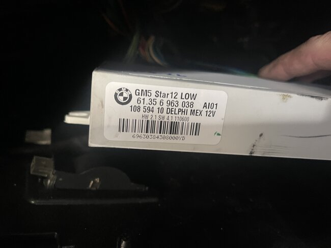

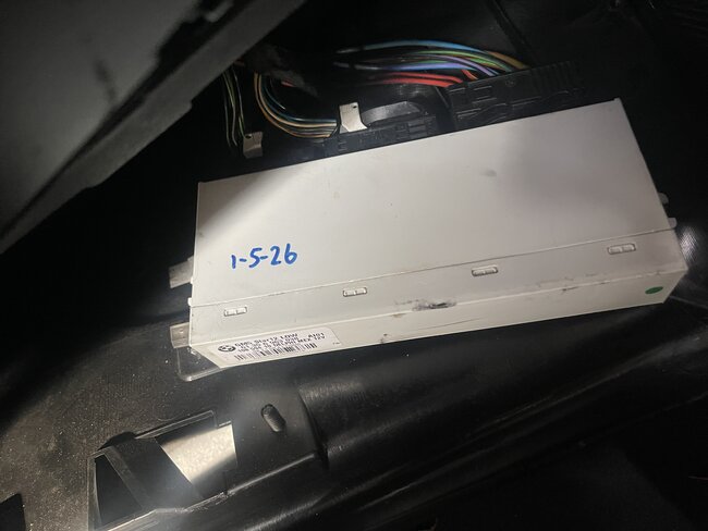

Only thing am worry about is why this gm5 module has a date of 1-5-26 and is dangling, so it must have been changed with a userd one and they thought it will fix the issue. Now i have no way to know whether this is the original one or not and whether they coded it i can ot communicate with many modules so either gm5 or the bcm or frm

These popped back under instrument cluster

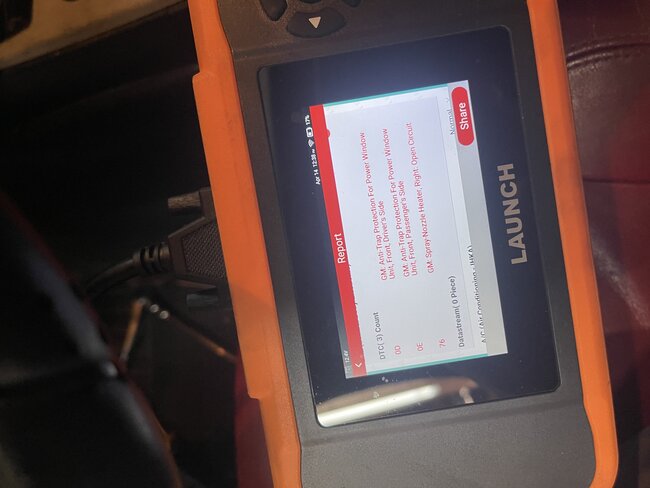

The panel that controls the top has 5 buttons all work except the top neither open or close light up. Cannot communicate with that module. Can you see where the fuses are? No sound at all from top

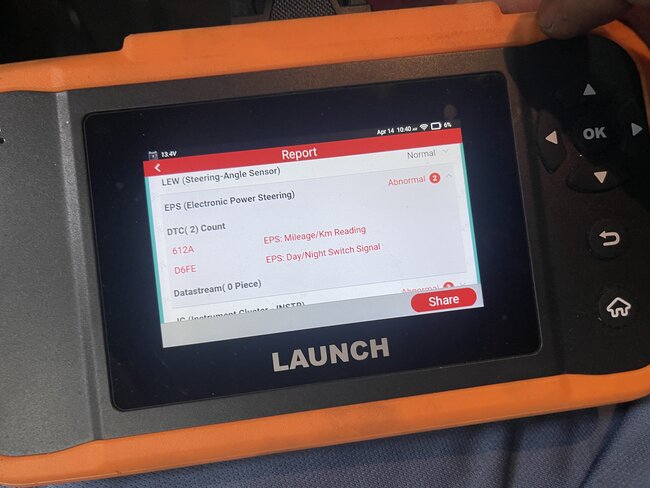

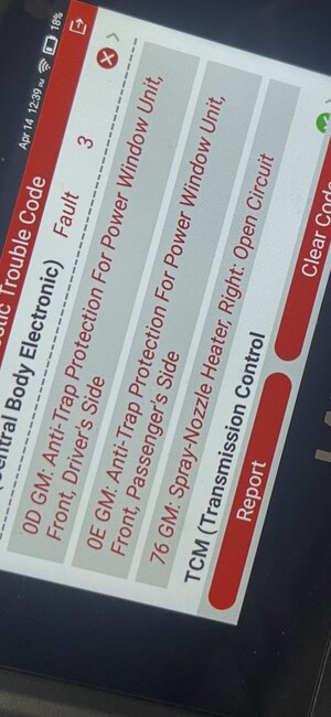

Not sure if these matter, they popped up
Apr 14, 2026 at 3:51 AM
  • 55,399 POSTS
The image is too small to read, can you enlarge it or tell me the codes?? So you unplugged the airbag module and it fixed everything except the top? I say you found the problem and the top is a separate issue.

BHAMDOC1
  • 351 POSTS
attached
Apr 15, 2026 at 12:45 AM
  • 55,399 POSTS
Hmm I don't think this has to do with the top, this looks more like the window operation issue, does both windows work?
Apr 15, 2026 at 12:46 AM
BHAMDOC1
  • 351 POSTS
both windows work up and down, but because it is a convertible whenever you press the top to latch remember they have to go down a bit, also when you close the door they should roll up a bit, but they are doing neither nor
Apr 15, 2026 at 12:48 AM
  • 55,399 POSTS
Yep, that is not right, this will be the general module issue which is what they were trying to replace, I would start with the reprogram of the module or try a hard reboot of the system this video can help.
