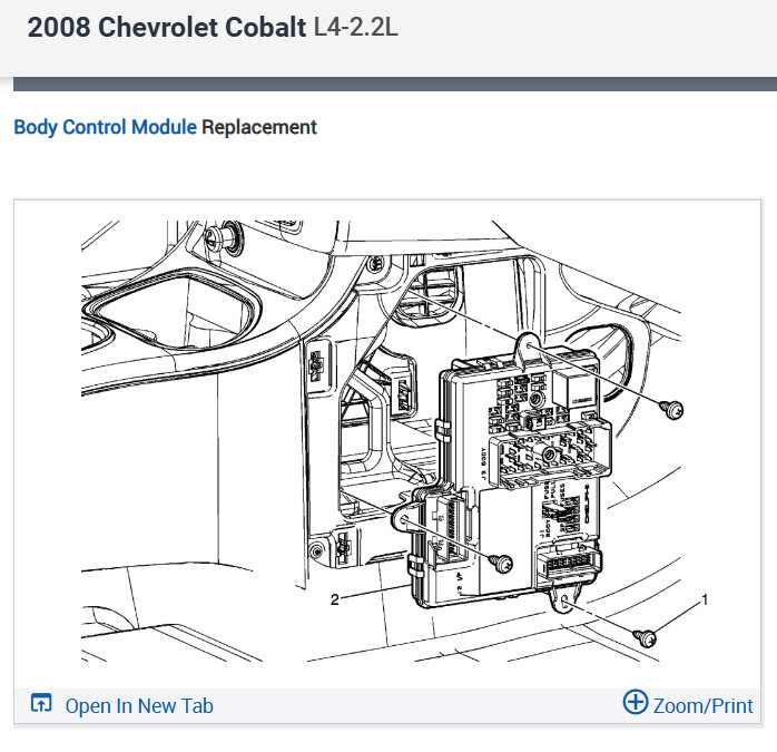

Replacing a Body Control Module. I was able to find one only remanufactured. Provided the VIN number and got the part number from Dorman. Stated No Flash required. Plug and Play. Just needed the steps for replacement.
Feb 19, 2025 at 6:14 AM (Merged)
  • 55,732 POSTS
Sure, here is the location of the BCM and how to replace it. Check out the images (below). Let us know if you need anything else.

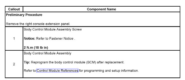

Is there more information? States to reprogram the new BCM and to refer to the BCM references on the setup.
Feb 20, 2025 at 7:03 PM
  • 55,732 POSTS
If you are getting a preprogrammed unit, you can disregard that part.
Feb 21, 2025 at 1:46 AM
AZDANNO04
  • 378 POSTS
The BCM that I am getting just stated no flash required and plug and play, but if it has no VIN number associated with it, it must have some uploading or learning to do.
Feb 21, 2025 at 6:04 AM
  • 55,732 POSTS
You are correct unless the BCM self learns which I have not heard of but is possible. Even BCM I have replaced needed programming unless preprogrammed with the VIN.
